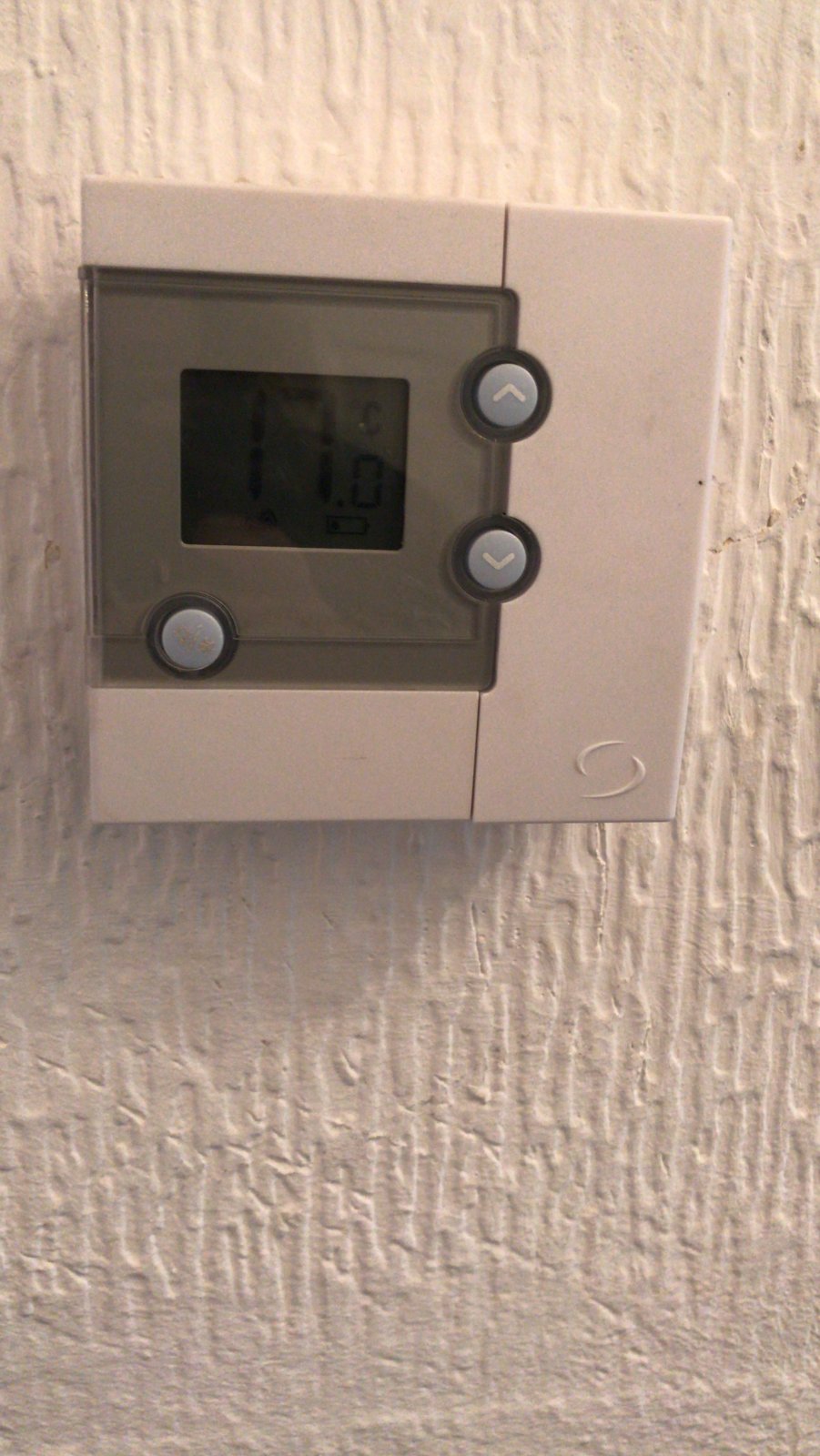

Hi, maybe someone can help me, i’m at my wits end I am not able to get the heating on.

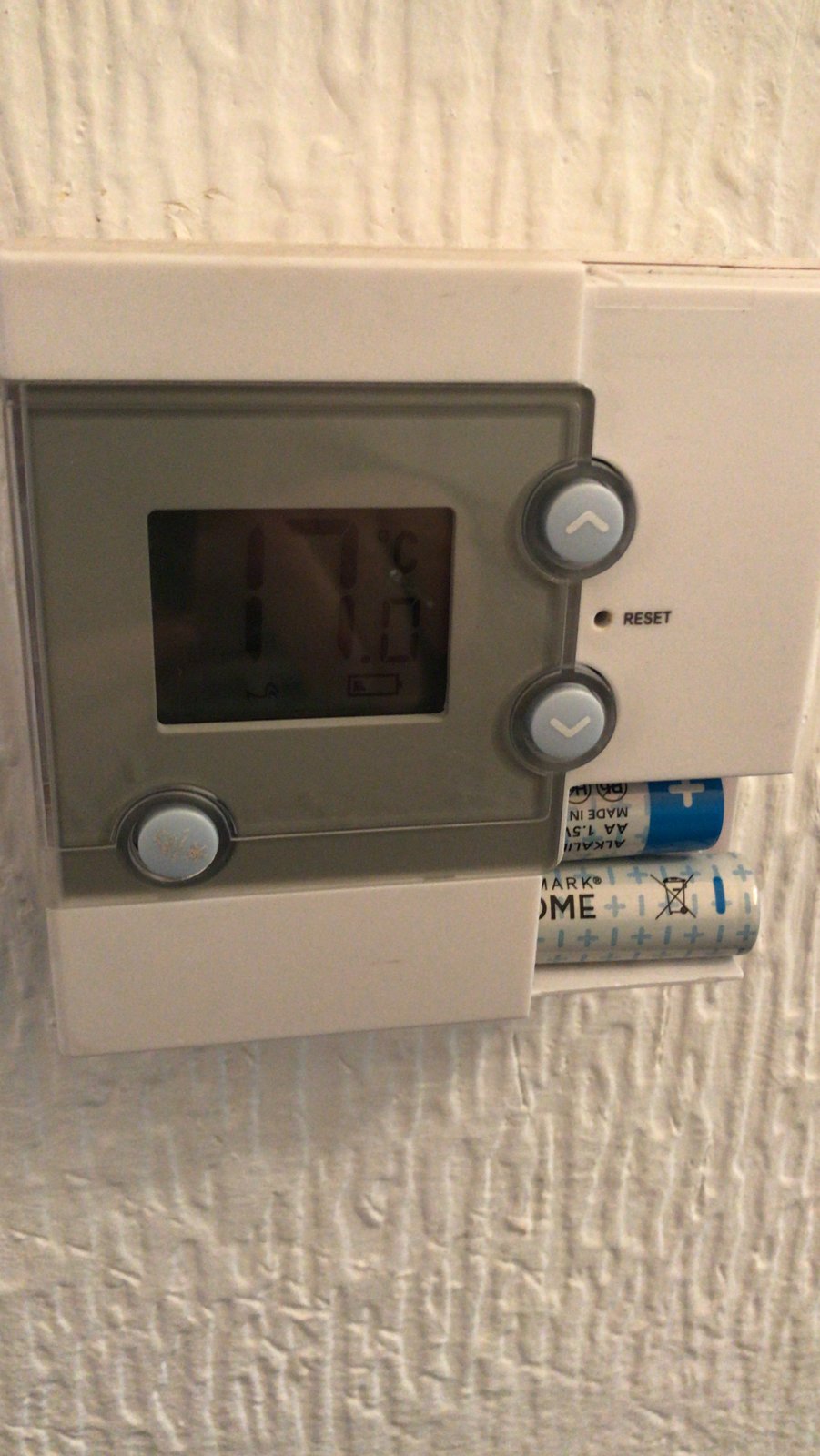

I followed the discrimination in one of the threads carefully, I reset the thermostat, changed the batteries, switched the receiver on and off as well as the main supply.
The only thing I can’t figure out is to reset the frequency, I also can’t find a user manual for it.

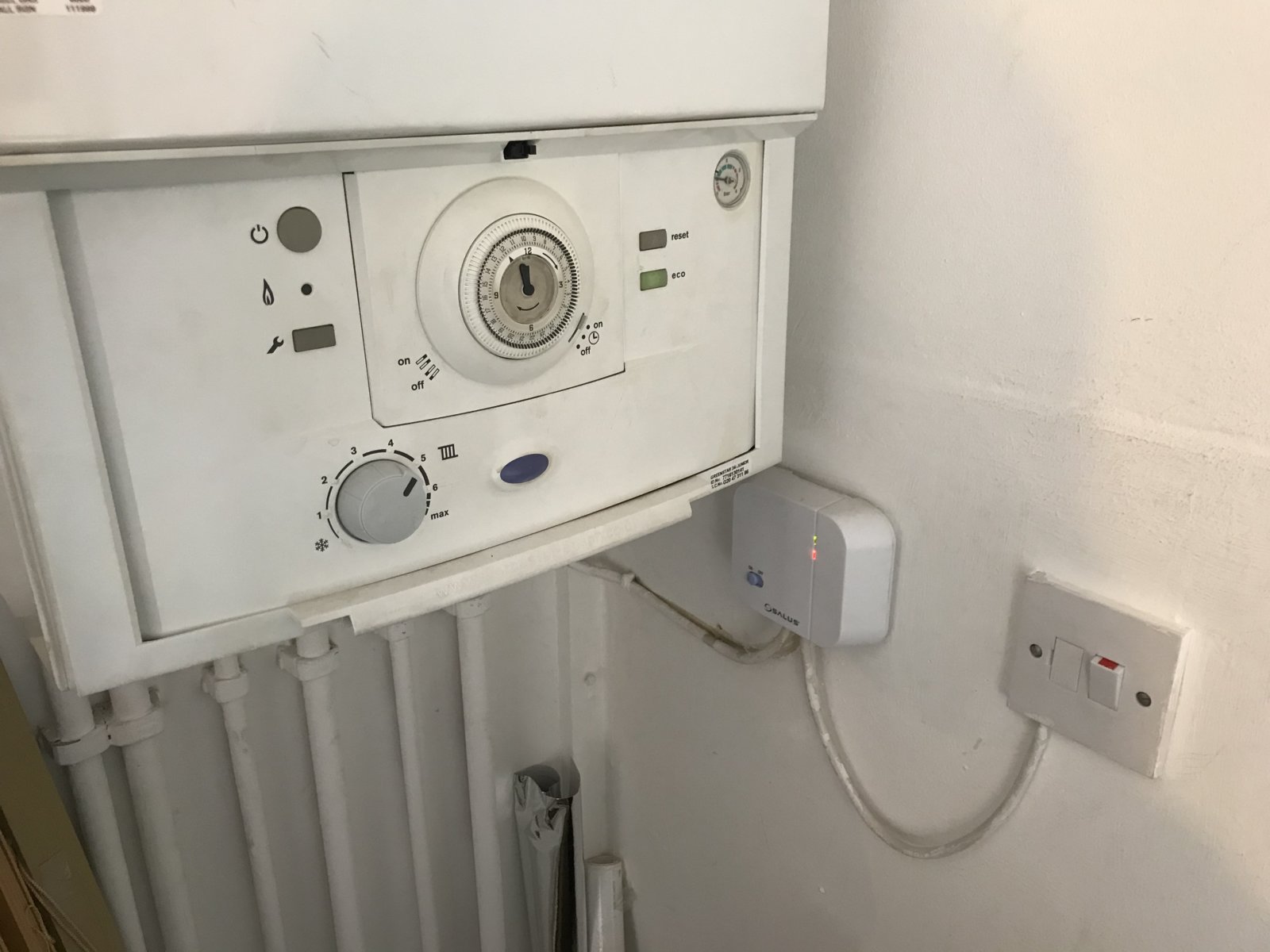

The receiver has two lights, the bottom one seems to be for the heating and that is still red. Hot water works fine.
I have attached some photos.
Any advice is much appreciated.

looks like the reciever is not switching as green light is on so boiler should be getting a call for heat,
