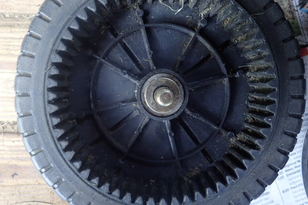

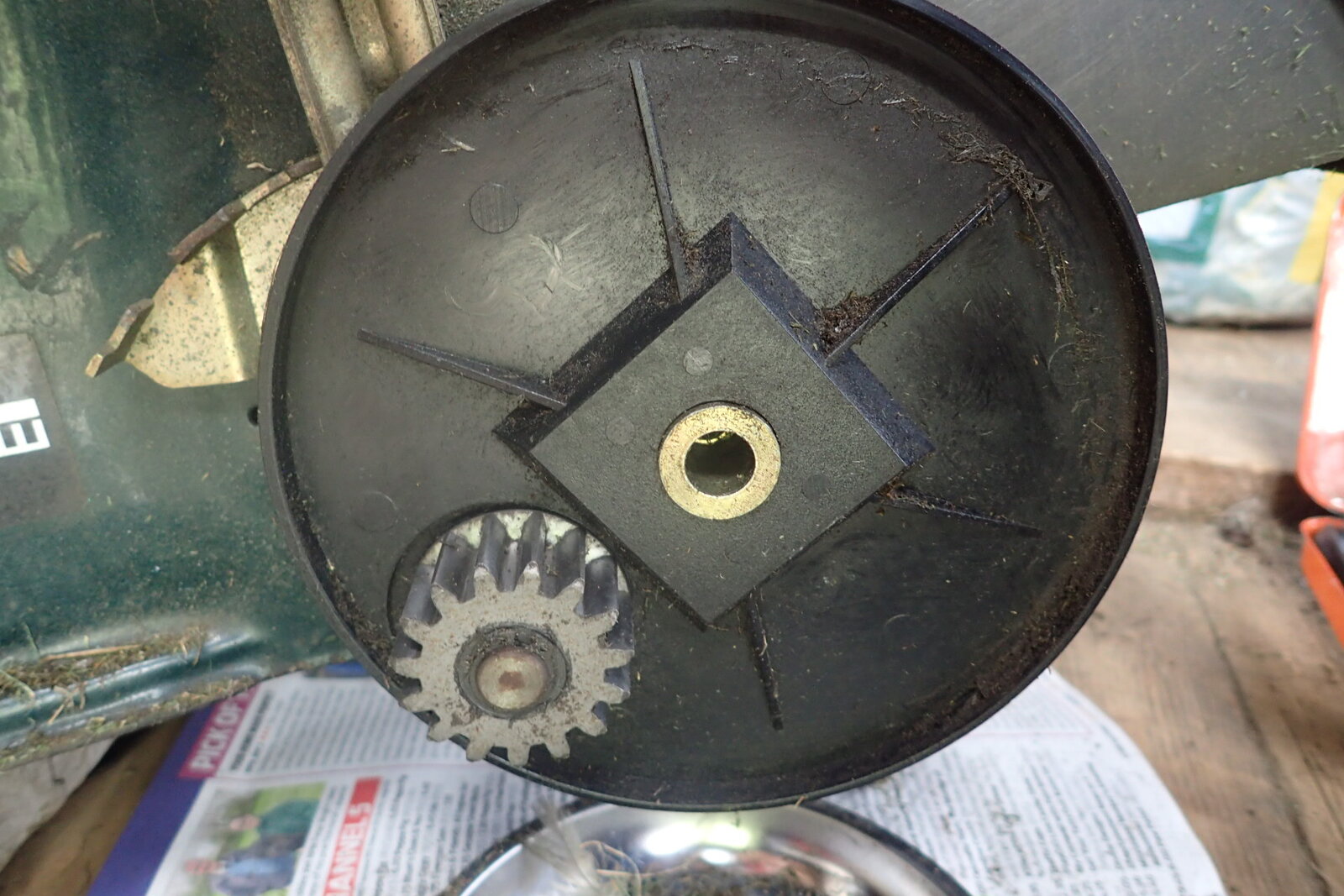

Removed wheel cleaned out grass ( not to bad)
I think the noise is from the bearing !
Tried to push some grease into this both sides.
Will wait to see after its cut the grass again.
If looks like new rear wheel.
Hayter 48 Jubilee - 424V Model 127802. No serial No rubbed off .
Donna ( now to clean finger nails)

Excellent, everything is in good nick there, you could do worse than shift the grass in the large wheel cog (second pic) although its pretty clean.
I don't know if this machine has bearings or bushes........shifting that washer on the second pic would help, likewise a shot from the other side of the wheel with the bolt removed. Either way, a drench with oil won't hurt anything, but keep any lube away from the gear teeth.
Now that you in the depths of the thing, see the small cog in the first pic? That connects to the drive axle. It should be possible for it to free wheel in one direction, but turn the axle the other as you spin it. Can you give it a try?
This cog should be packed with grease internally, as it contains a device which allows the rear wheels to turn independently to each other, effectively allowing you to steer.
This cog is held in place with a circlip, which is a bit more involved to remove but we'll consider that later if need be.
