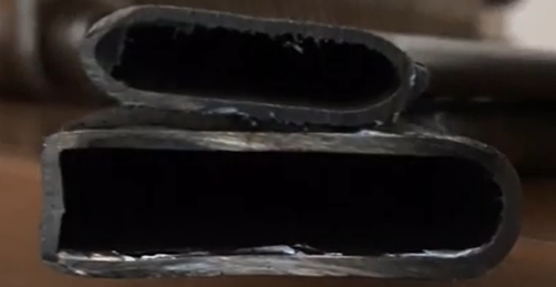

I am asking because one of the boilers I am looking at, the Alpha regular boiler, seems to be the only open vent boiler to use the common stainless steel Sermeta/Giannoni heat exchanger used on top of the range Vaillant/Ideal/Baxi combi and system boilers. The design seems to have lots of quite narrow tubes. I believe Vaillant used to use the same heat exchanger on their open vent boilers, but stopped in 2016, and started using an aluminium design instead. I was wondering whether open vent systems might be inherently more dirty and prone to blocking these narrow tubes.
Photo comparing with Viessmann heat exchanger.
No, an open vented system can be kept just as clean as a sealed system, the key is good/proper design and regular maintenance.

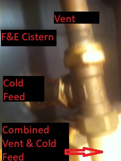

My own, 52 year old OV system has system water perfectly clean with some rads over 40 years old, I have a combined vent and cold feed (but the vent is carried on up and over the F&E cistern, however the much more common and accepted way is to have a VCP system, where from the boiler (flow) you have the Vent, then, no more than 150mm away, the Cold feed, then the Pump, some of these systems, for various reasons do suffer from pump over through the vent leading to aeration of the system water leading to corrosion and sludge, I have seen systems that were converted from apparently perfectly installed VCP systems that still suffered from pump over, to a combined exactly like mine with no further problems.
A sealed system, on the other hand, theoretically, cannot get air ingress for obvious reasons except a very minor leak isn't addressed leading to constant top ups and oxygen release from the make up water. Even sealed systems, unless the inhibitor levels are kept up can have far more corrosion/sludge than a OV system with little or no inhibitor, my theory, for what its worth, is that and air/gases will vent through the OV system but cannot with a sealed system.

As far as having a combined feed and vent though, if it was needed when converted then there's no real reason the change it but I don't believe it was ever a standard vented system design principle. They can sometime be troublesome for trapping air and can make it more difficult to fill and bleed. Combined feed and vent was introduced more as a fix/solution for the OV problem of pumping over or pump air draw on older systems that weren't performing properly when systems became restricted/blocked or being extended incorrectly without the correct considerations/configurations.
I've allways kept the isolating (service) valve to the F&E cistern closed, I occasionally look into the cistern but it never takes even a drop of water when I open the service valve and briefly depress the ball.
