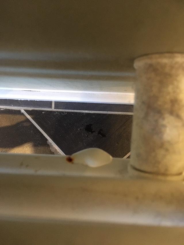

Will be getting a professional opinion on this, but would be good to know what questions to ask and the possible outcomes...
This is a slow drip - not figured out how slow, but something like a drip an hour. I don't *think* it's been happening very long, and suspect it may have been triggered by recently getting the boiler repaired so it actually holds 2 bar of pressure, was running at 0 bar for I don't know how long. However that rust spot presumably hasn't happened overnight.
Radiator bleed water is clean. No signs of similar issues on any other radiators.
I'm assuming we want to replace the towel rail, but if a repair's an option that'd be good.

Not really, only repair would be to drain it and weld it but that's a farf.
Time to replace methinks.
you would be best to isolate and drain that until you get the replacement, I have seen them getting very bad very quickly when they pinhole like that
Yeah, was getting nervous as it seemed to be speeding up slightly. Still drips per hour, but didn't like it. Have isolated and opened bleed valve to depressurise, so at least it doesn't have hot 2 bar water running through it. Not sure I'm up to draining it, will keep a weather eye on it and see when we can get a plumber booked in.
