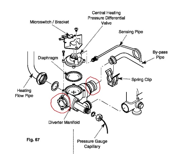

I changed both the diaphragms on the DHW & central heating differential valve but i did not change anything. The central heating still comes on when the hot water is on, i.e. the central heating differential valve opens when i turn on the hot water.
I was not able to unscrew/take off the two parts circled in red on the pics to replace the bits inside, they were screwed on very tight. Anyone have any tips how to get them off so i replace the push rods and spring inside that parts?
Also anything else i need to check to see why the heating comes on when the hot water is switched on?
Thanks in advance
