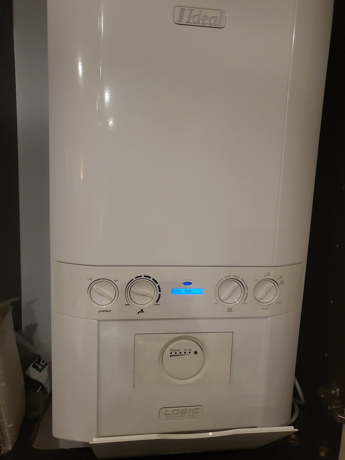

This is the boiler I have

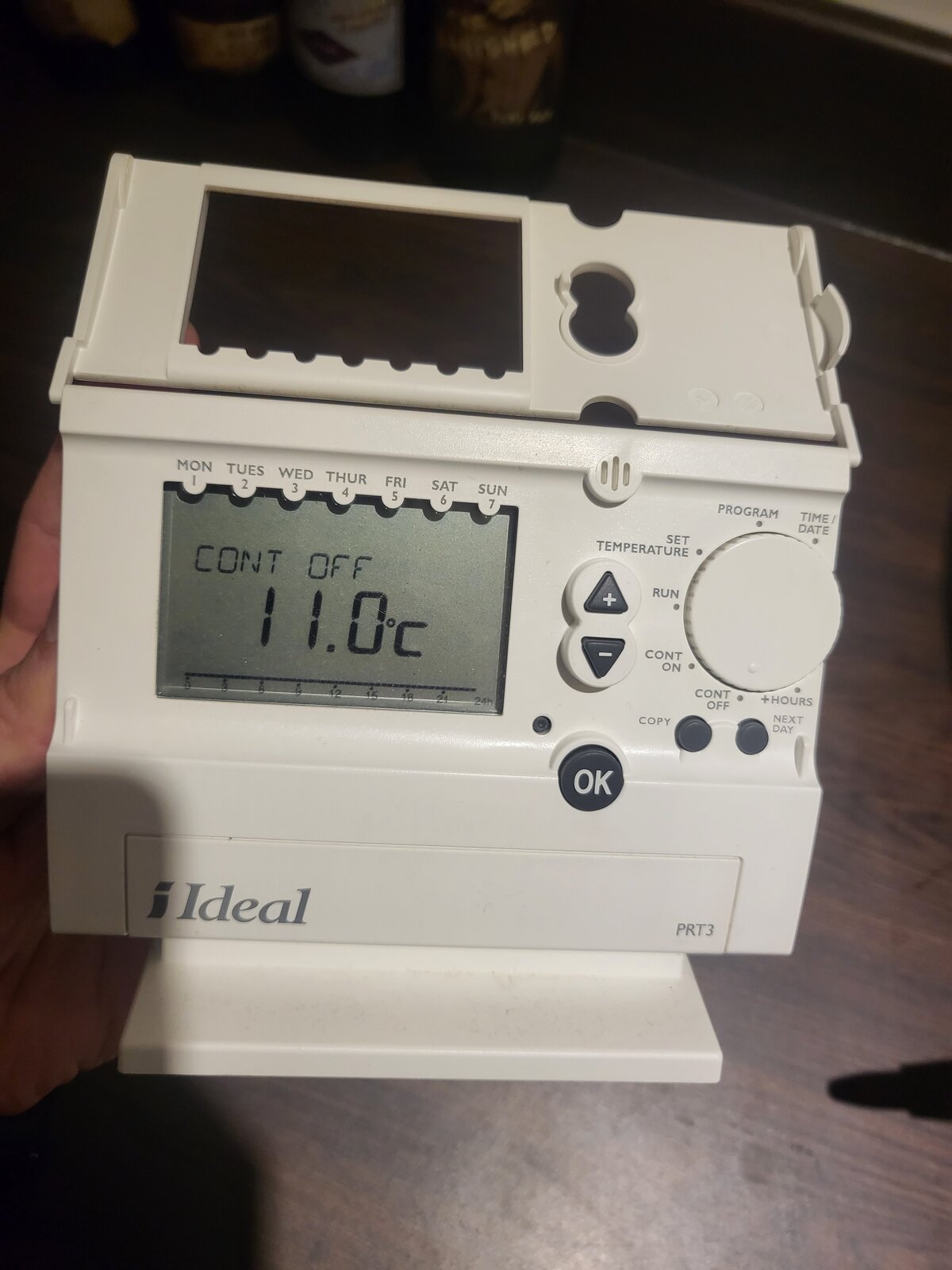

No it has been like it since I've moved in 2 years ago , this is the stat I have

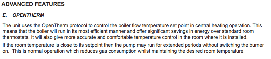

On the spec page it says ERP Class V. That means it is a modulating thermostat which has the ability to control the boiler flow temperature. This is often called load compensation. It sounds like that is what is happening. I have no idea whether that is the default, whether it has to be set that way, or whether it can be changed. I'm happy to try to find the manual and see what it says.
I read the manual for it and it did say push up and down button ,but it just tells me the set out point at the current time with no way of changing anything. Thanks in advance
I've read the manual This thermostat takes control of the boiler flow temperature. There is no way for you to change the boiler flow temperature. Does it always say 80? Do the radiators get really hot? Can you alter the room temperature using the thermostat?
As far as i can tell the thermostat will just tell me the flow temps , eg its 16.c now. So when I turn on the heating it will gradually rise to 80c and just stay at 80 until the room is up to temperature with piping hot radiators , then shut off completely when room is up too temp .so it all works fine but it's not efficient atall as the burner is always on to get 80c , I would rather set to eco mode and take longer to get to room temp but using less gas , but once again if I turn the dial to eco mode it just says controlled by room stat which It dosnt.
It's not clear which boiler you have. Please post a photo of your actual boiler and your thermostat.
Do you have the original paper manual. Can you post a photo of the front with the name of the boiler on. And also find the gas code number in the manual.
Thanks. I'm out of ideas! Hopefully someone else will know the answer.
