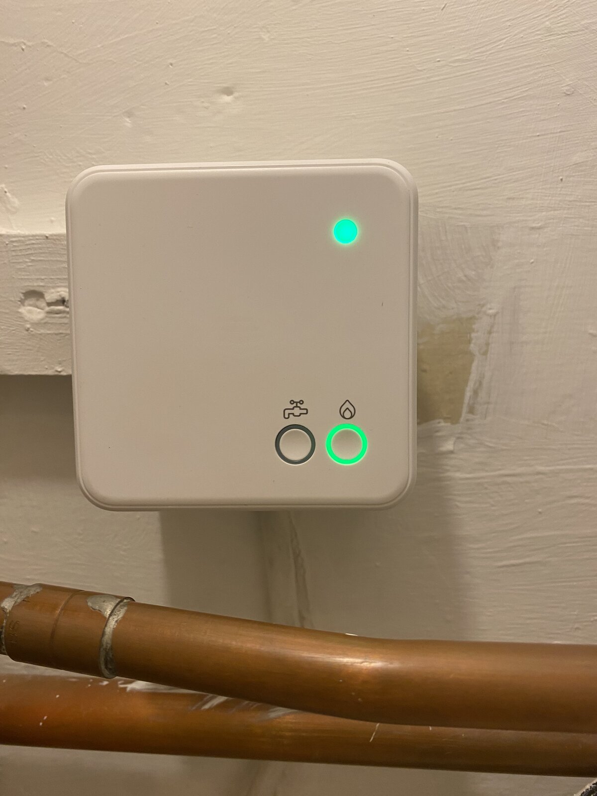

A few weeks ago I successfully replaced the old heating hot water control unit with a Hive receiver and I was successfully using the Hive app to control both. Everything was working fine. In fact it was so easy to swap over the old unit with Hive I could hardly believe it. No wiring was needed.

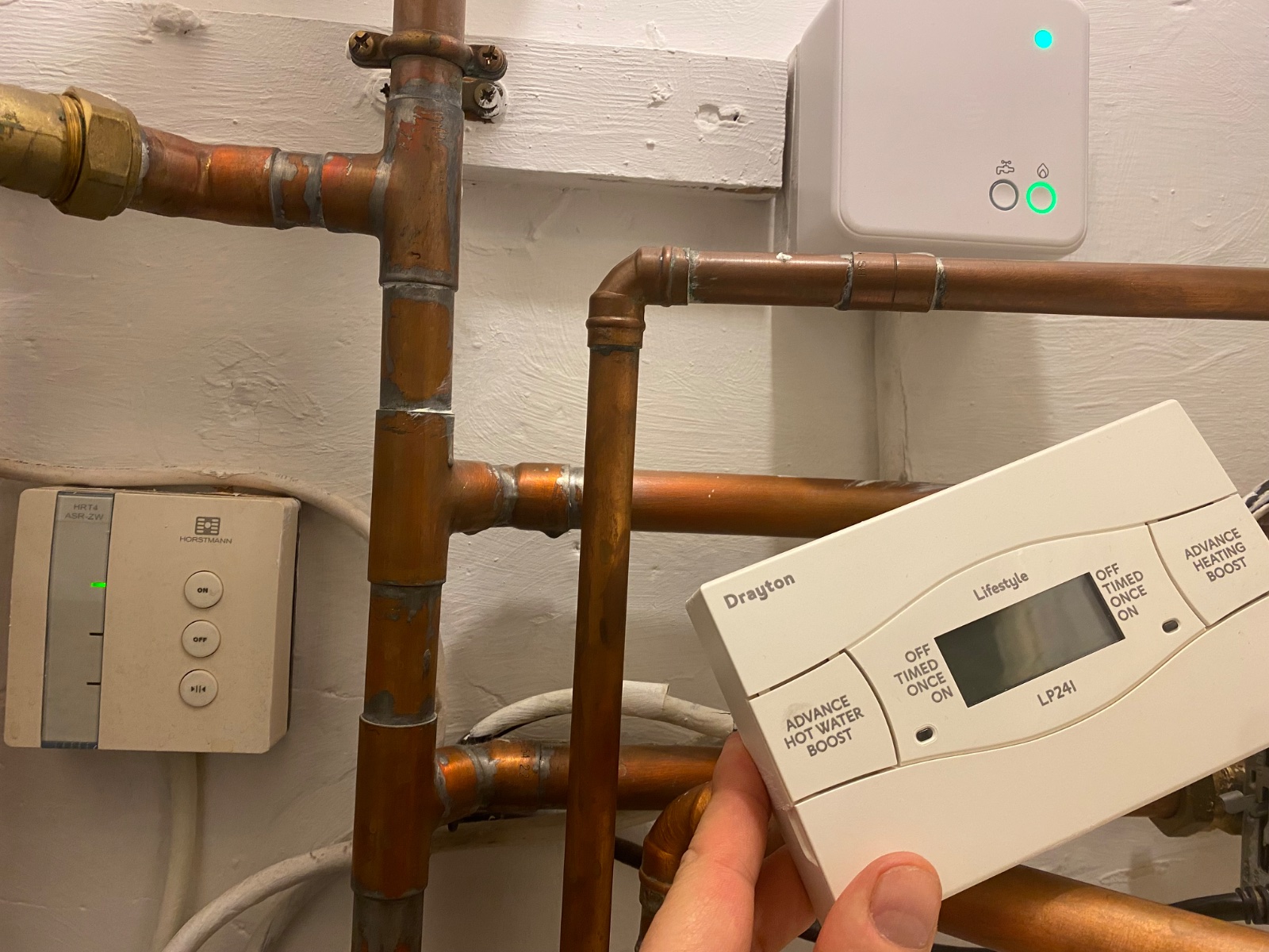

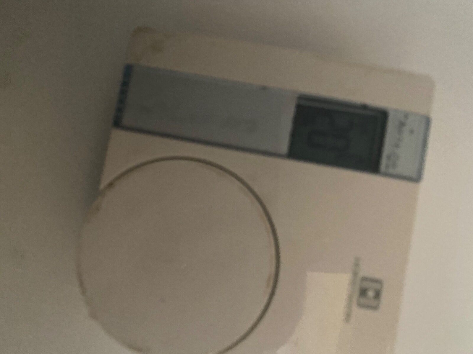

However over the last few days things stopped working correctly. The radiators will only warm up if I turn on a unit that is next to the hive receiver - it’s a horstman HRT4 ASR-ZW which I still connected to a thermostat downstairs. But I don’t understand why the system is using this. The Hive app works, the batteries are new and the boiler is firing up. But why is it only working when I manually turn on the Horstman when I previously I didn’t need to? Why does the Hortsmann need to be involved at all?
It sounds like you didn't fit the Hive correctly as the Horstmann was the original controller, this is why it's likely involved. I take it it's the receiver?
You say no wiring was needed, yet something has been left in, so still part of the circuit

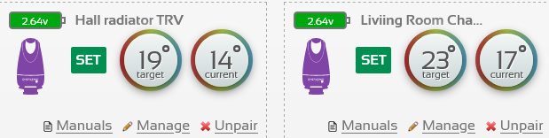

So Tado, Tapo, Honeywell Evo home, Drayton Wiser, and Hive, all allow TRV heads to connect to some central unit, which has a verity of names assigned to it, so the TRV heads can both stop over and under heating. In some the central unit is a simple hub, in others it doubles as a thermostat. There are also ways to control TRV heads from remote heat sensors, so where the TRV is in a draft, it can be controlled by a device not in the draft, but also the draft can be used to detect when doors are opened and inhibit the radiator for a set time, so it is not heating outside when unloading a car for example.
Cost of TRV heads and wall thermostats varies a lot, so where two rooms have nearly the same conditions, one may have a full-blown linked electronic TRV head, and the other a cheaper non-linked head.
So in my case if the wife's bedroom gets too cold, the TRV head can start the boiler running, but in my bedroom the TRV head can allow the radiator to heat up if boiler already running, but can't start the boiler. Both are electronic with different temperatures for different times of the day.

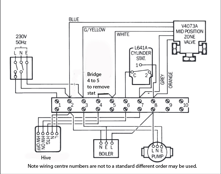

It’s single zone. Oil fired boiler
When I got the Hive two months I simply removed the existing Drayton timer box and fitted the Hive receiver instead. No wiring was neeeded and it all powered up. For these two months I have been able to turn my heating on remotely an hour before getting home and both heating and hot water have functioned on their schedule correctly.
But suddenly I’m the last few days Eveything has reverted to working only by me turning up or down the original hortsmann thermostat in the sitting room. It’s done this with no changes being made so it’s a mystery
If I disconnected the original horstmanm do you think it would work simply using the Hive. I can’t see any reason I’d want two ways to control the boiler

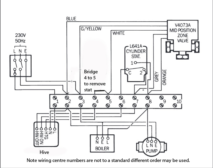

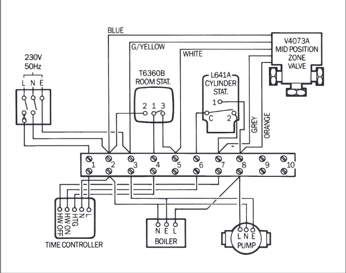

From the sound of it, Horstmann and Hive are in series, not parallel, many just turn the original thermostat up to maximum, and let Hive take over. This shows Y Plan change Y-Plan-hive.jpgY-Plan.jpg where a link is put in the wiring centre, but numbers are not fixed, so it takes some investigation to find the correct wire to bridge. I would turn the Horstmann up full, and wait until summer to sort out, this is not the time for heating to fail as you have made an error.
From the sound of it, Horstmann and Hive are in series, not parallel, many just turn the original thermostat up to maximum, and let Hive take over. This shows Y Plan change View attachment 403042View attachment 403041 where a link is put in the wiring centre, but numbers are not fixed, so it takes some investigation to find the correct wire to bridge. I would turn the Horstmann up full, and wait until summer to sort out, this is not the time for heating to fail as you have made an error.
Ok, this is your issue. You haven't decommissioned the Horstmann, leaving a circuit that's gone haywire
No mystery really, something has obviously happened, perhaps without your knowledge? Or maybe it's just working off the Horstmann now.
No you don't need 2 ways. You can disconnect the Horstmann but you'll need to put a link wire in the wiring center end. If you want the easiest thing for now, safely isolate the electrics, open Horstmann receiver and link the 2 switch wires or Common and NO, then the Hive should take over.

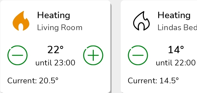

My own house, just got a new thermometer for Christmas
point is rooms vary in temperature, 1766852205304.png even in the same room,
So 17, 20.6, 20.5, and 19.8 all in same room at same time, two of the rooms on the thermometer are not heated, so not that bad, but to expect to control whole house with one wall thermostat is asking a bit much, even when I went on holiday in a caravan, two thermostats even for a unit so small.
