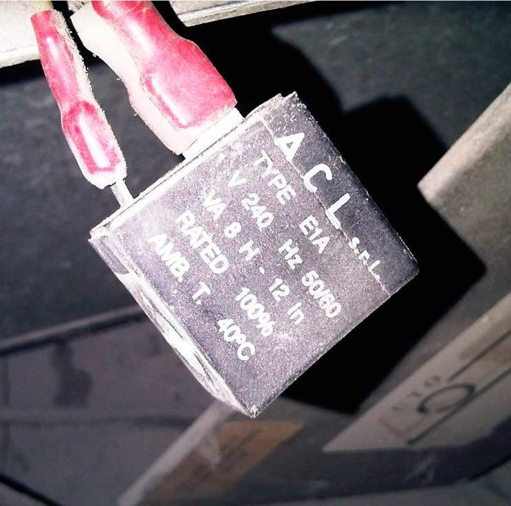

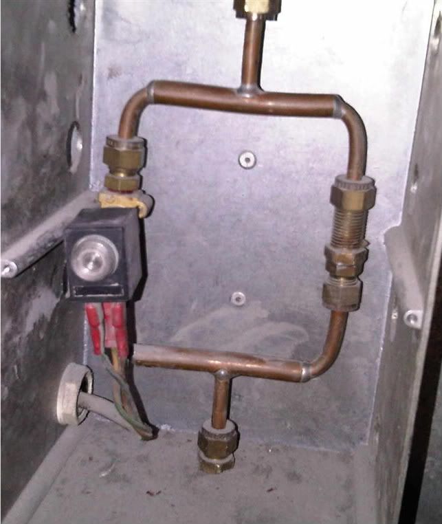

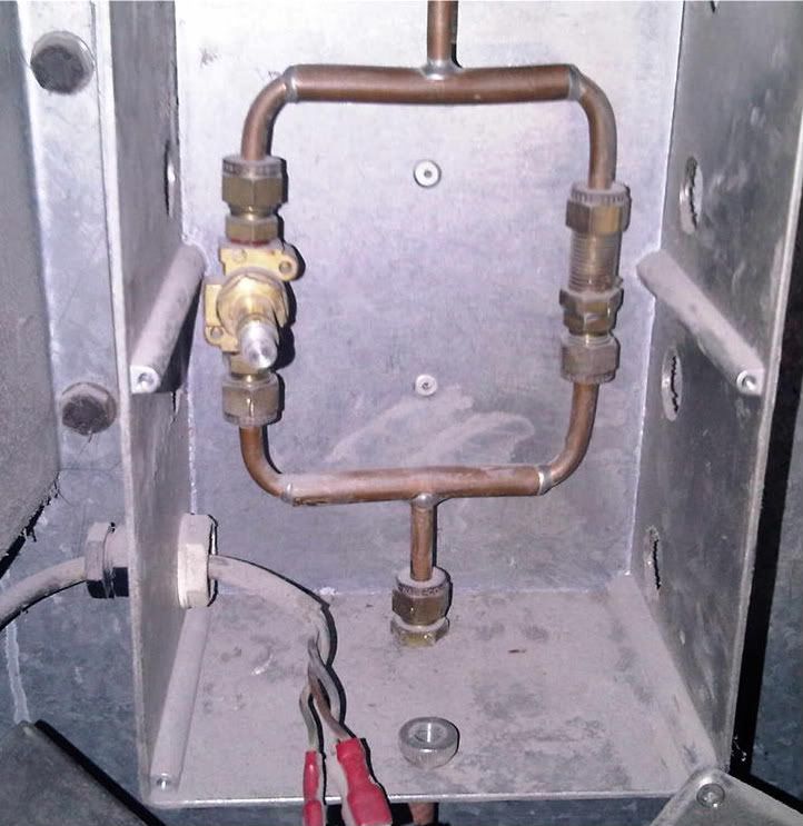

The problem is this valve switch type thing , the way it works is gas comes in from the pipe at the bottom
As you can see from the shape of the pipe, the gas will flow through one side first then when the switch operates it will flow through both sides allowing more gas through.
The booth has two different modes spray cycle/ bake cycle
on spray cycle this black switch/ relay what ever it is, remains closed letting less gas through to the burner.
When you switch it on to bake this switch is supposed to open the valve and let more gas through for the bake cycle the bake cycle requires a higher ammount of gas.
the switch appears not to operating and the gas supply is remaining on spray cycle ammount.
When i put my hand on the switch it feels quiet hot, i have had the actual brass valve assy in bits and the plunger is free and operating.
So what is the proper name for the black switch/valve/relay and where could i get one.

pipework with switch removed, showing the gas valve that the switch opens

It's as Matt says.

Whoever has been on it before has already made a pig' ear of the job judging by the electrical connections. There should be a din plug to the solenoid.

I am most concearned by the lash up of a spacer to the right of the failed solenoid it look very much to me that a solenoid valve has already been removed from this location and a lash up of brass fittings used as a bridge I would be looking to carry out a FULL INVESTIGATION of this heater before doing any work or giving any advice !! ;)
i dont think that is the case, there is no evidence of any wiring that would have went to another valve.
That distance piece has just been inserted to equal the distance of the valve on the left hand side.
i have owned this equipment for over ten years and nothing has been removed from this section.
I've got to agree, I too think there has been been something taken out,
Maybe not another solenoid, but something
regulator for the spay cycle perhaps?,I don't know but agree with boilerman2 you should get it looked at profesionally,its not a DIY job
