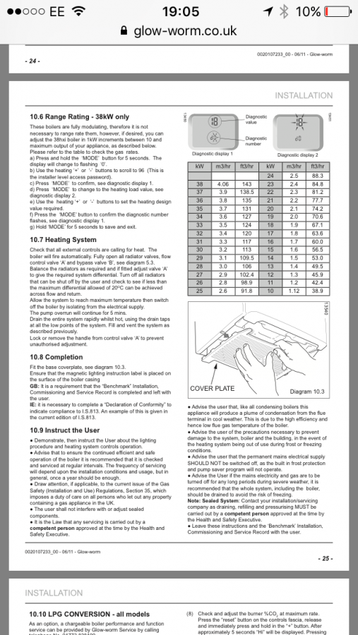

My Ultracom 38hxi 4101906 manual shows a flue on page 29 and there is no mention of range rating it. What manual have you got? Got a linky?
There appears to be different manuals floating around for the same model and GC of the boiler....the early ones have no reference to range rating and maybe the software can't do it either. Wonder if Glowworm finally realised so many 38hxi are massively oversized and decided to implement the BG330 solution...one size fits all and make it range ratable (sort of).
