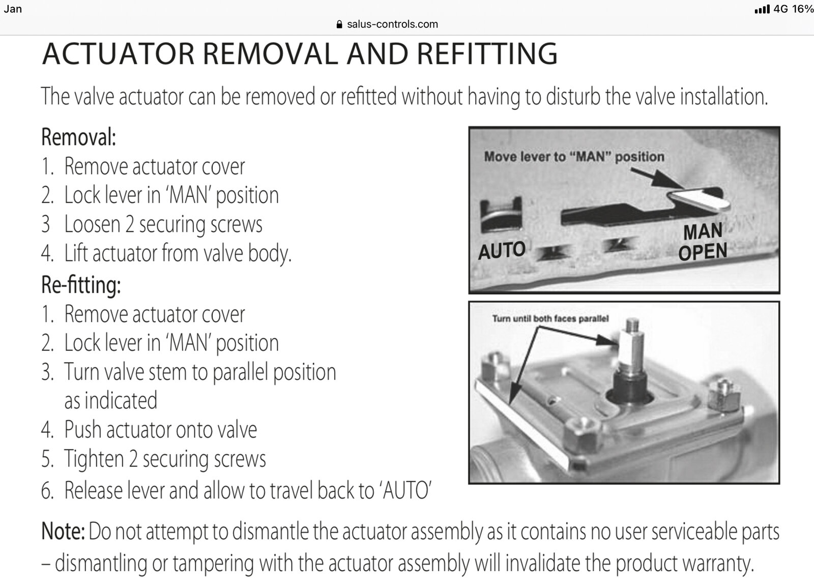

These are from the Salus MV322 instructions, maybe this will help?

It looks as if the actuator may not be removable from the water valve, so it looks like you may need a complete valve and actuator swap, in which case it might be worth your while to fit a more reliable MOMO type of valve and actuator. Buy the right type and they are a direct swap for what you have from an electrical point of view. Unlike the type of actuator you have, where the motor is under power yet stalled, the MOMO type just move, then switch off. The MOMO also don't use a very strong spring, fighting the motor, so much less strain on the mechanism.
The Altech ALTHC011 seems not to be Salus MV322 or MV328, the latter has an easily removable head, just held in place by 2x 6mm screws.
The motors can be replaced, but often it is simply not worth while, because if the motor is worn out, the mechanism will be too.
Thanks. That all makes sense. Especially why I couldn’t get the actuator off the valve!
Have you found information/image online? I’ve just found some, that appear to have a gap between head and valve, which suggests, it can be removed?
It could be the valve to actuator fixings are under the mechanism, meaning it would involve stripping the working parts down to release the actuator - basically the whole thing built on a bench, making field replacement of the head impossible.
As I said in post 2, the synchron motor is goosed, judging from you later comments. It has two screws, IIRC, to undo and remove it and the same to replace with the connection of 2 wires. Get a genuine Synchron from Screwfix, about £20 inc.
