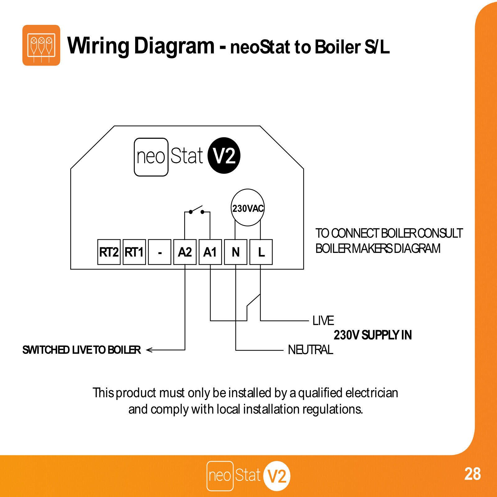

My Heatmiser Slimline was recently replaced by a Heatmiser Neostat Wifi. The wiring was kept the same, i.e. permanent live to L, permanent neutral to N, the live linked to A1 and the boiler to A2.
However, when this is done the boiler fires irrespective of whether the thermostat is calling for heat.
The boiler still fires even when the front panel of the Neostat is removed, whilst the wires remain connected at the back. Everything else on the device looks to be working fine, including the wifi connection.
When the Neostat is removed and replaced with the original Slimline with the same wiring, the problem is resolved and the boiler works normally.
Is the Neostat likely to be faulty?
Attached is what the Slimline wiring looked like when I removed it and the wiring diagram for the neoStat.

The only reason that the boiler could be running is if the switch between A1 and A2 in your diagram is closed. It might be helpful to see the display of the Neostat at the same time as it is not calling for heat, but the boiler is running.

I've had the Slimline (12V) versions with UFH for many years now but some strange behaviour is causing me to look at the neostat 12V versions to try to rescue the system.
As I understand it the relay between A1 and A2 should never be closed unless the flame symbol is present. This would imply that even if there is some strange setting going on like frost mode or whatever, the flame should match the relay contacts.
There are two things I would try; if you have a spare unconnected one, I would check the resistance between A1 and A2 with nothing else connected to it. It should be open circuit. The other thing I would try is disconnecting the wire from A2 (and making it safe in a connector block) to see if the boiler still fires. Both of these are to find out if the neostat is closing the switch A1/A2 when it shouldn't. If it does then either the neostat is faulty, or it has some strange behaviour that doesn't seem to match its instruction manual.
Given that you said you have two that behave the same then most likely (as Eric said) it is some weird feature that makes no immediate sense.

I don't have a multi-meter at the moment but disconnecting A2 stops the firing.
I think the only way I can power the neostat down is by turning off the fused spur shown in the picture above. This stops the firing (and also turns off the UFH pump).
