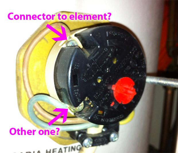

Found some clear instructions here http://www.ehow.co.uk/how_5883425_test-water-heater-element-multimeter.html. I've got to locate the screws that connect the elemeent with the wires that supply it power. But most of the images and videos on the web show weird American heaters, where the stat and element are easy to tell apart. Can anyone tell me where the stat ends in my case and the element begins? Where can I find the connectors to the element?

Here's what my element head looks like.

matt1e was right - the stat on my top element was broken. When the water heats up but doesn't stop heating up till the safety thermal cutout on the stat pops, that's a good clue where the fault lies.
If your bottom element works OK, an easy thing to try is to put the stat from the bottom element into the top element. The stats are dead easy to change - you don't need to drain the cylinder because the stat rod fits into a watertight sleeve. :!: :!: ***Make absolutely sure all your power is off!*** :!: :!: then disconnect the elec wires from the connector screws, and gently pull the stat directly out, horizontally towards you. It's only held in by a pair of clips. You might have to waggle it a bit to loosen it.

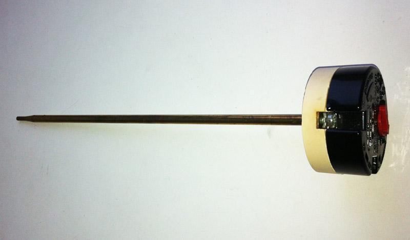

This is what it looks like when pulled out.

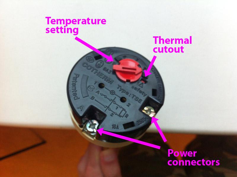

This shows the thermal cutout - tiny red button that pops out when the element overheats. This is your first thing to try if you have problems - press it in again with a pen point, it should give an audible click if it has popped out. But be careful and keep an eye on your cylinder if you turn it on again afterwards - the cutout is a safety feature to deal with overheating, and if the heater's overheating there may be a problem with your stat that must be attended to.
The temperature setting in this pic is where you set the general heat you're aiming for - mine was set to about 4, which was fairly hot. The power connectors are where the elec wires connect the stat to your mains.

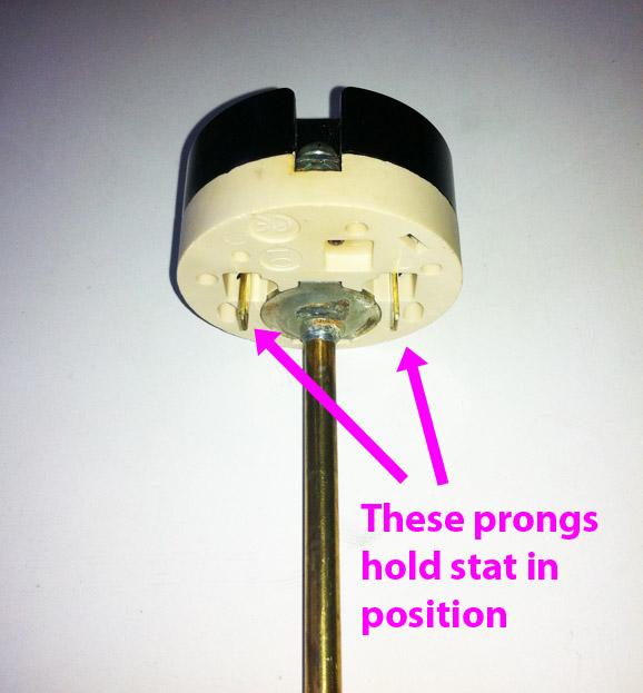

This is the back of the stat showing the two prongs that hold it in and pass the mains current to the element.
