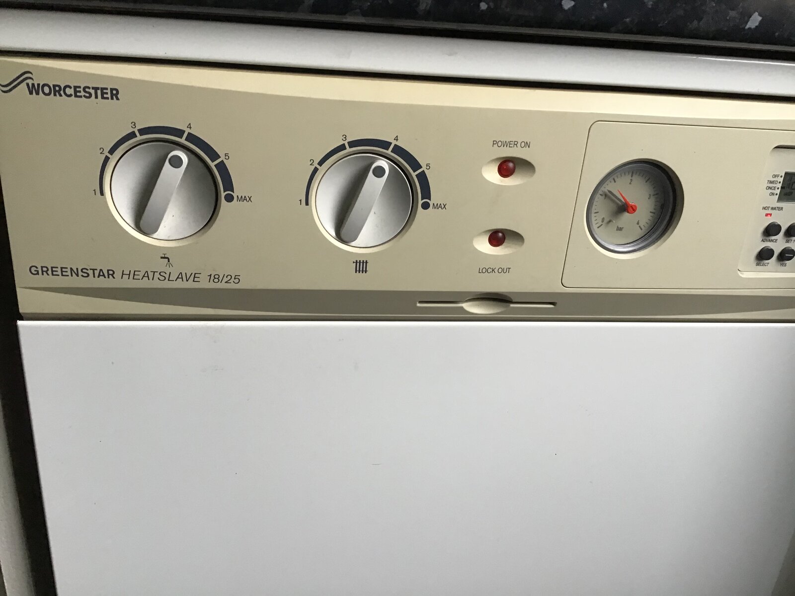

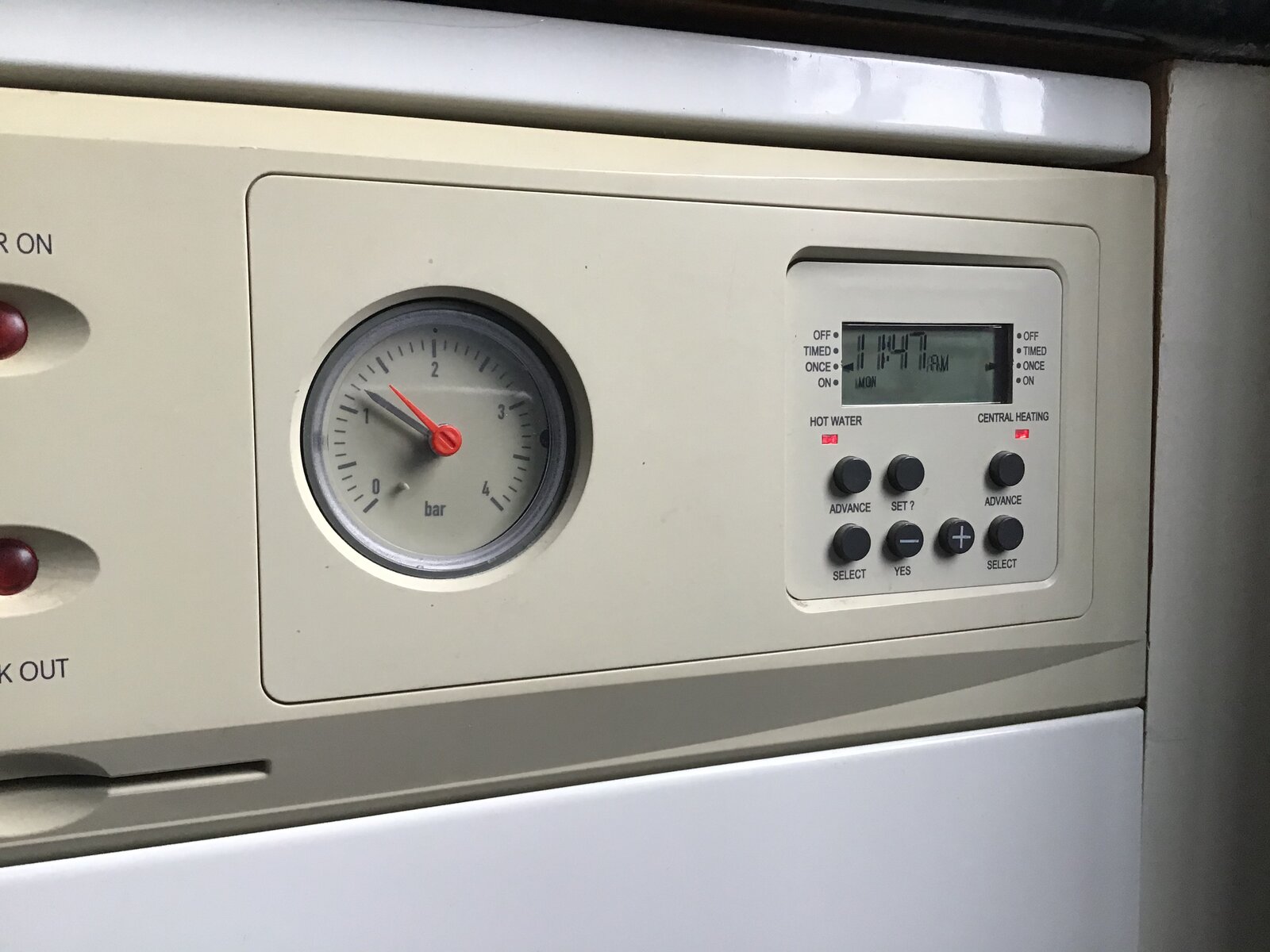

Hi. Can anybody help? I have an Worcester Greenstar Heatslave boiler (2008) with an internal digital programmer which is playing up. The programmer has 3 programmable periods for both CH and HW but when I have tried to find a replacement with the part no (7716192033) there only seem to be units with 2 periods. They all look the same as the original unit but I ideally want 3 periods. Is it possible to fit a Worcester Comfort programmer instead? Did the programmer change to just 2 periods? It seems strange that if it did it retained the same part no. Many thanks.
Can you post a pic of the programmer that is currently fitted please
Here is a photo of the programmer. As I said it has 3 periods for both hw and ch.

Part no I have for the one for your boiler is
WORCESTER 87161053910
try searching with that number

Why not see if you can obtain a blanking plate and fit an external timer with 3 on/off periods?
Hi Hanks for the reply. Ideally I would like to replace the programmer with another internal one but I do have a blanking plate for it. Could you recommend an external programmer that would work?
call Worcester customer service , they are pretty good they will give you the part number and availability that you need , if it is no longer available you can fit any controller you want next to the boiler
As per @ianmcd really, call Worcester and they’ll tell you which ones of theirs will fit internally, if you do want an external one, any 2 channel programmer will work.
