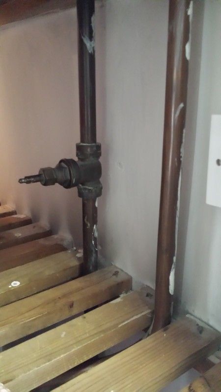

I then refilled the system, and bled all radiators starting with the ones downstairs then moved up. After this I switched on the heating, and repeated the bleeding process as the radiators now had some pressure from the pump. Now here's where I'm struggling, I have some old radiators with the bleed valve pictured below, and I'm finding I'm having to almost pull them the entire way out and jiggling them about before I hear any air escape. After a few minutes of doing this the radiators start to get warm but they never seem to get hot like they used to (even though the flow pipe is boiling!) and I have literally tried bleeding them for 10 minutes with no luck. Am I doing something wrong? If I can still hear hissing, does that means there is still air in there? Also is my bleeding process correct?

Never bleed a system when it's running. As long as you get water from the rad, then the air bleeds are working ok. Ensure all rad valves are on. Bleed pump, and finally balance the system using the lock shields. If after all this you still have a problem, come back.

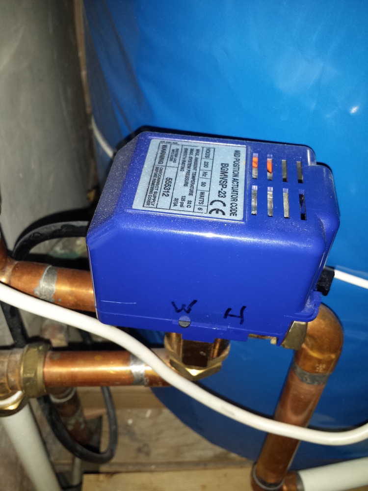

I'm pretty sure its a two port, the unit I have is pictured below (pic from google), I have an an "M" and "H" on the side (not "W" and "H" as the pic shows). I'm 99% sure the reason the rads won't get water without quickly turning on the heating is something to do with this valve as the pump really doesn't do much in the 1/2 seconds I switch it on.

System should fill via gravity, operation of valve and pump should not affect it, although it may fill quicker and reduce trapped air if the MV is open whilst filling. Valve wont do much in 1/2 a second, you need to give it chance! Once it gets power from the appropriate stat, the valve should then motor open, and once it reaches full extent of its travel, activate a micro switch. This in turn energises boiler and/or pump. However, it needs to be opened manually using control on the side for system filling purposes. It will reset once power is applied again.
That is a three port valve!
Ah... my mistake! :oops: I assumed because water was being distributed to 2 places it was a 2 port!

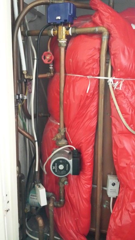

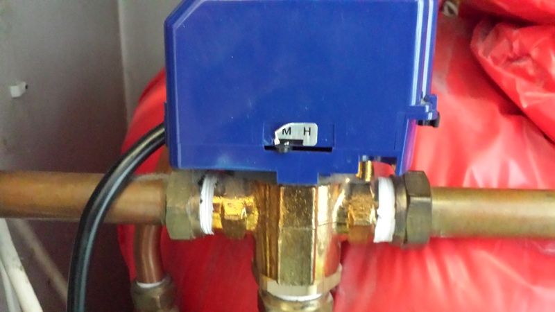

I've attached some pictures below of my setup, the feed pipe to the tank is 22mm. Is putting the valve on "M" as pictured below all I have to do to allow the system to refill? I have no idea why but the water reaches the cylinder no problem when I refill the system, but its not untill I switch on the heating for 1/2 seconds that all of a sudden all the rads fill up.
3 port valve :!: :p
Feed pipe on the left
Enters the cylinder at the bottom
Brand new pump

Wrong feed pipe! Thats the cylinder feed from the cold storage tank, the CH water is completely separate. ;)
The green can, it's a Myson 'aerjec', I would put a wager on that's full (blocked) with carp. (Try the magnet test!) The cold feed from the F&E cistern should join the system via the aerjec. The only solution would be to cut it out, it maybe possible to clean it, otherwise replace it. I'm not sure if these are still made, but either way it would probably be preferable to lose it altogether and rejig the pipework as necessary to negate the need for it.
That is a 3 port valve, the W end of the sticker is missing! Following the pipe from the W port, it tees off, and goes down to feed the cylinder coil, where does the upward leg go to?
Hi Hugh, thanks for all your help. In the end I decided it might be better if I stuck to my day job and called out a pumber! :p He came to the same diagnosis as you and will be removing the aerjec, rejiging my pipework and doing a power flush.
