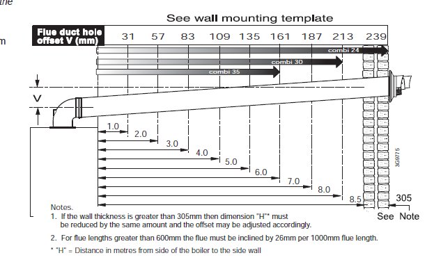

Is the flue in Mike from London's £3500 installation correct apart from being unsightly?
First of all unsightly flue means it complies with minimum clearance dimensions from any openings, so had to be routed away from that door, and it is in a utility room where no one would give a honk, may be you are picking on its slope, it looks level but the inner flue is eccentrically laid to form a slop towards the boiler. So far so good its been going for two years with no problems, no dripping from the flue. The guy was going to put the boiler up on that wall where the flue is existing, but there was going to be problem for condensate drain, and he was suggesting using a condensate pump over the door, and since majority of other plumbing ran on the adjacent wall, therefore he decieded to take this route. The door has since been blocked with a 3/4" thick plywood and stuffed with insulation leaving just the vent exposed. Washing machine sits in front of that door now.
So if you know what is wrong with that flue other than the slope, spell it our in the name of safety, I can point that to the installer what he think of your comments?
May be he will say I should not worry! I haven't got the picture of the flue terminal, but it is also offset pointing upwards.
He will be soon conducting a safety check in April, I could ask him to check slop and the inner condition of the flue making sure there are no standing pool of condensate that may cause corrosion, if he does not bother, I will send in a small camera for my own piece of mind.
And of course there's nothing wrong with this one?

Who said there was nothing wrong with that installation, couple of things, one being overflow PRV tied up to condensate drain, even I can tell despite not being an RGI, but why should I lose my sleep over it since the guy who did the installation and parted with my money should know better and any consequences arising out of PRV tripping will be down to him. I am sure it won't be a jet of boiling hot water shooting out a stream a mile long, at best it may just dribble a few drops, nothing to worry about and don't get paranoid. My pressure cooker is what i am more scared off than this PRV tripping off. And no one is going to die if condensate trap dries up due to this PRV discharge pushing its contents back into the boiler, gravity will soon pull it back in and no one has died of this. secondly the tee section in the drain is pointing wrong way to flow, again hardly an issue, not that it is going to be the end of the world.

MFL, I'm only a humble DIY'er and I wasn't saying that your flue was wrong, just that it didn't look that good and inviting comment.

Dave, I have absolutely no problem with your comments, it is good you made me aware as well, and I did not even raise an eyebrow over that flue slope, photo may be deceiving, but next time I am around Harlow, I will take my spirt level and check, if the installers did not provide enough slope, then they better redo it, I just hope they will acknowledge their error and put it right at no expense to me. I will speak to the company who did that installation, they are based in Harlow, You made constructive remarks, there is absolutely no need for anyone else to use inflamed language and leave nasty comments. Some people are so arrogant.
