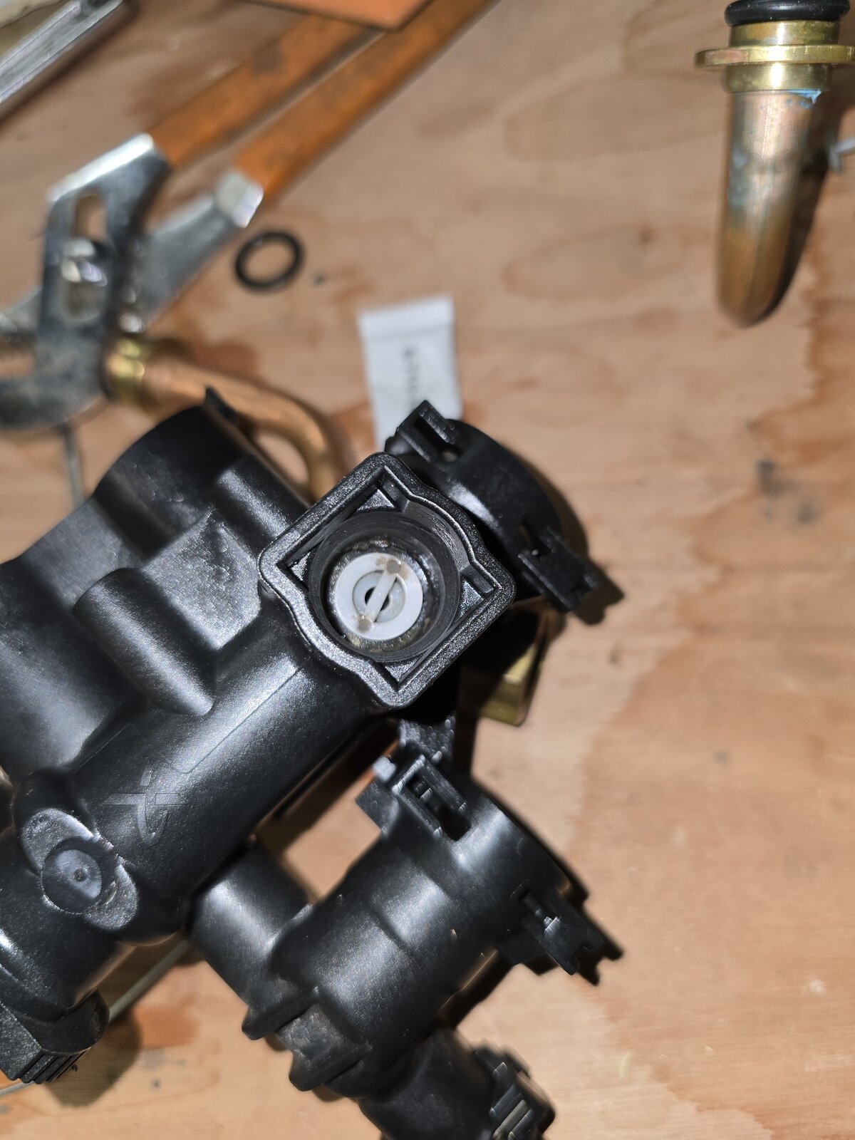

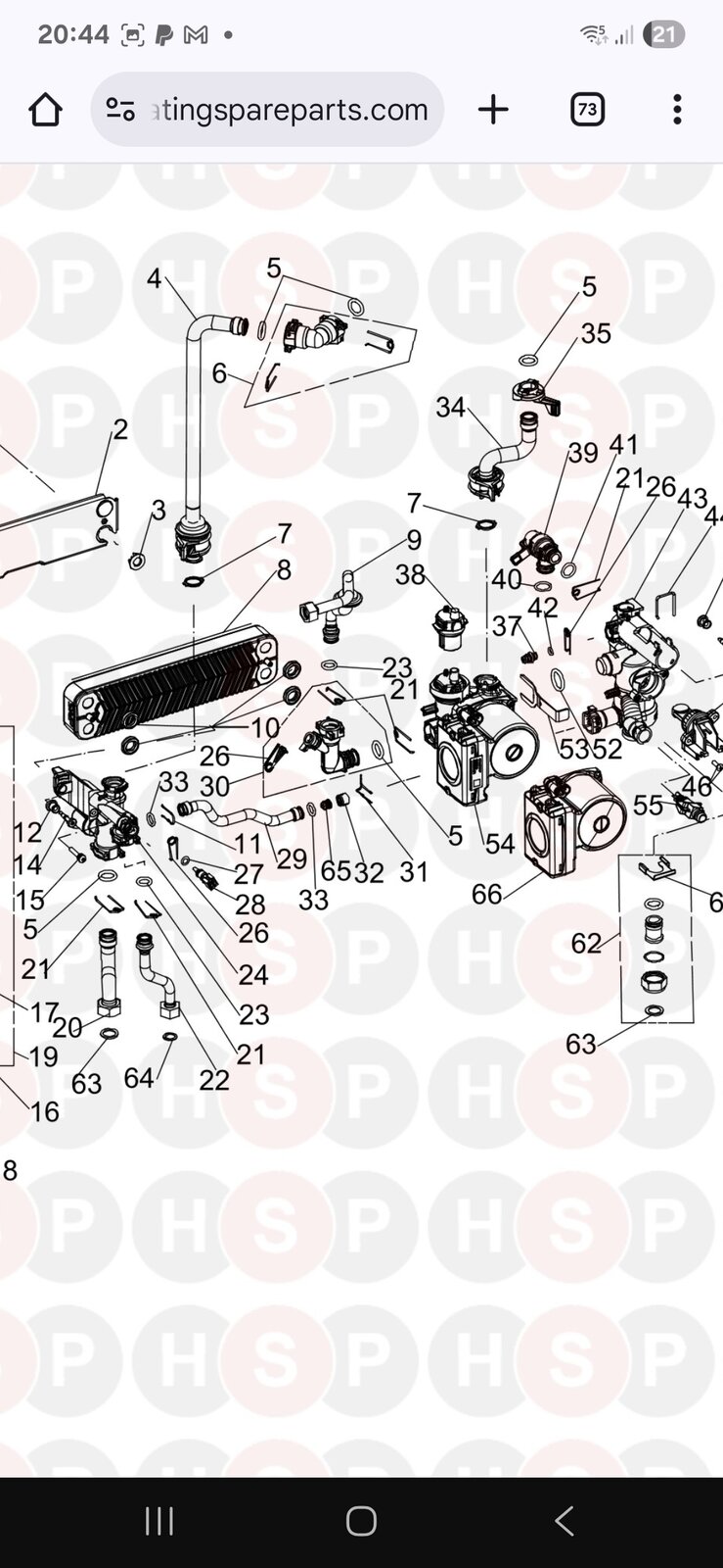

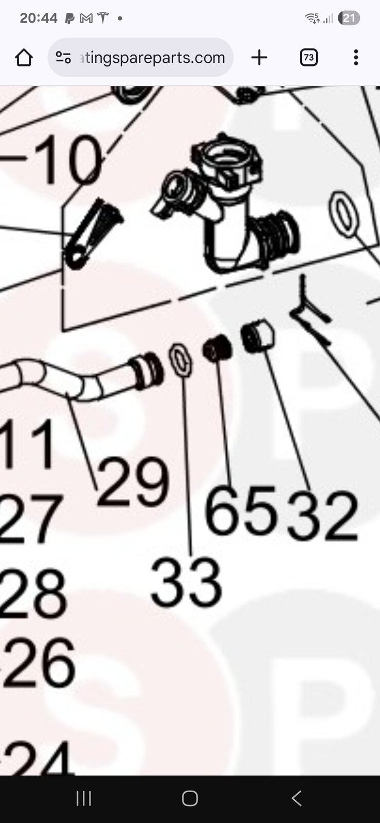

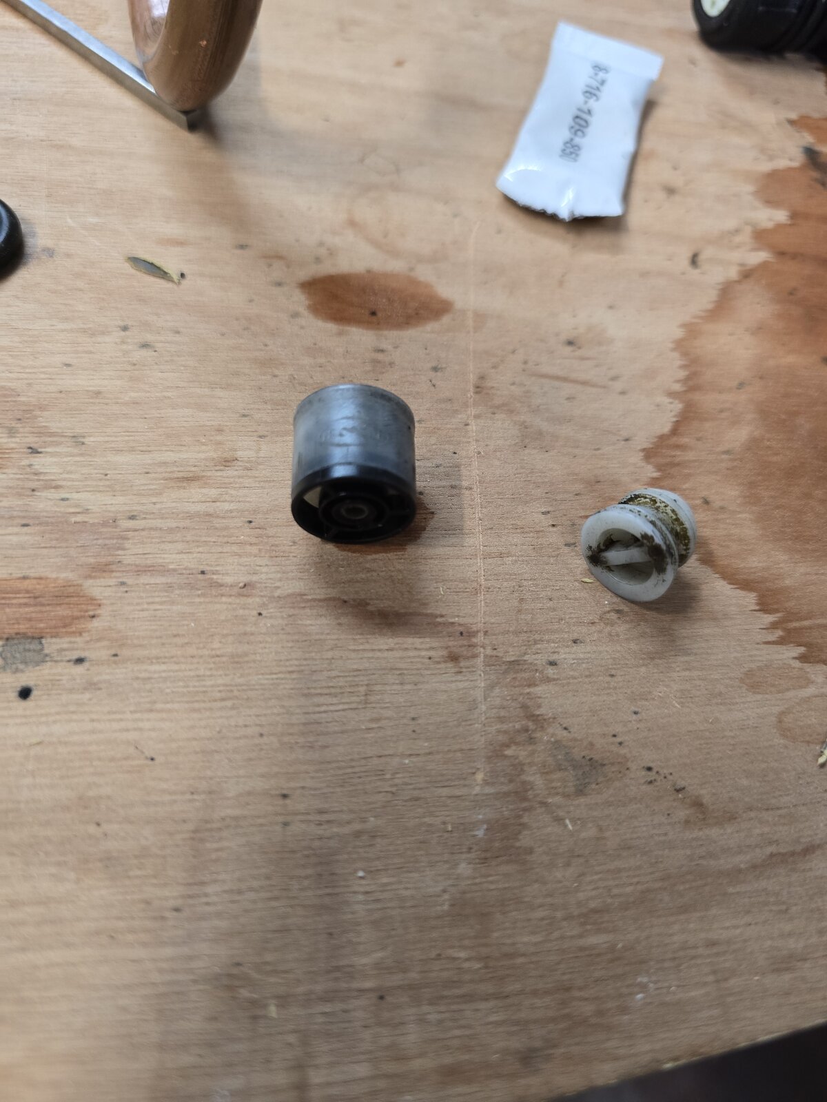

Anyone know how/where this bypass pipe restrictor fits please? Only seems to be on the 30i not the 30si.
Show as item 65 on the parts diagram, item 32 is already in the Return blick/rhs manifold. Does it go over that then the pipe on top? As it seems small for the hole it's in. Or does it push into the end of the bypass pipe item 29?
Any help much appreciated as were currently on cold showers

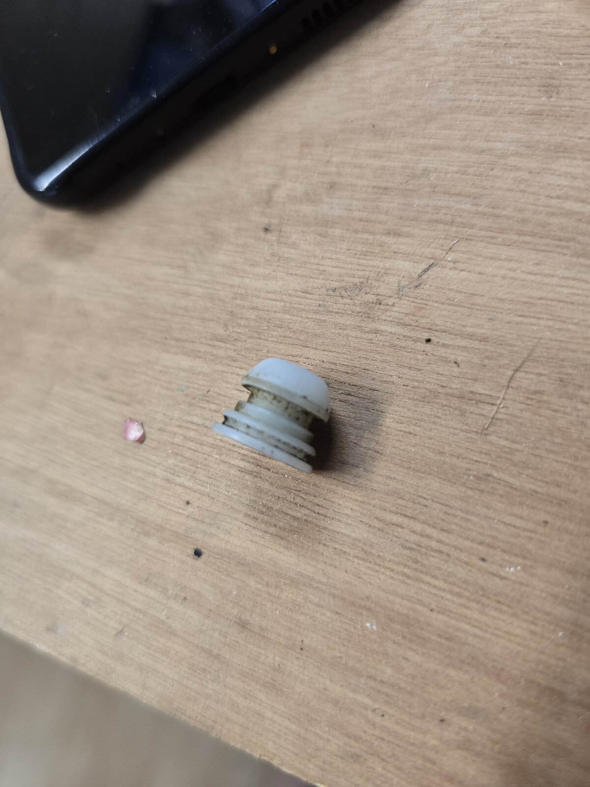

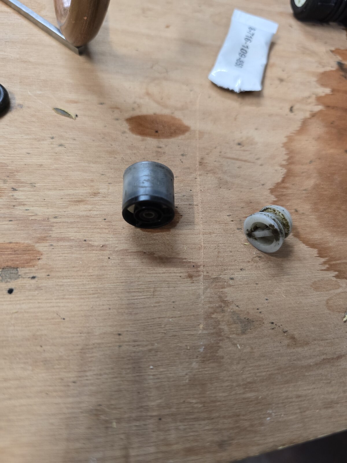

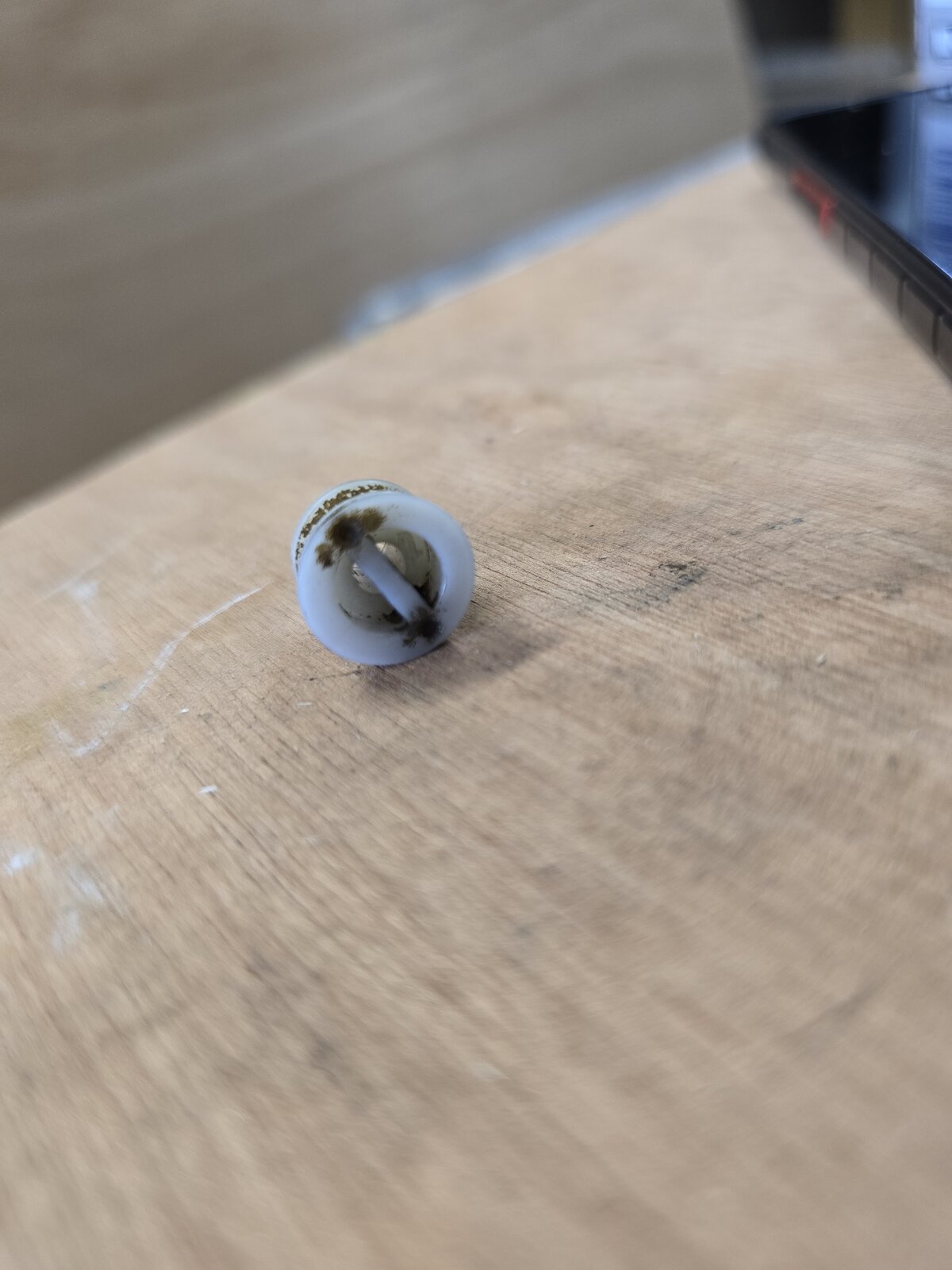

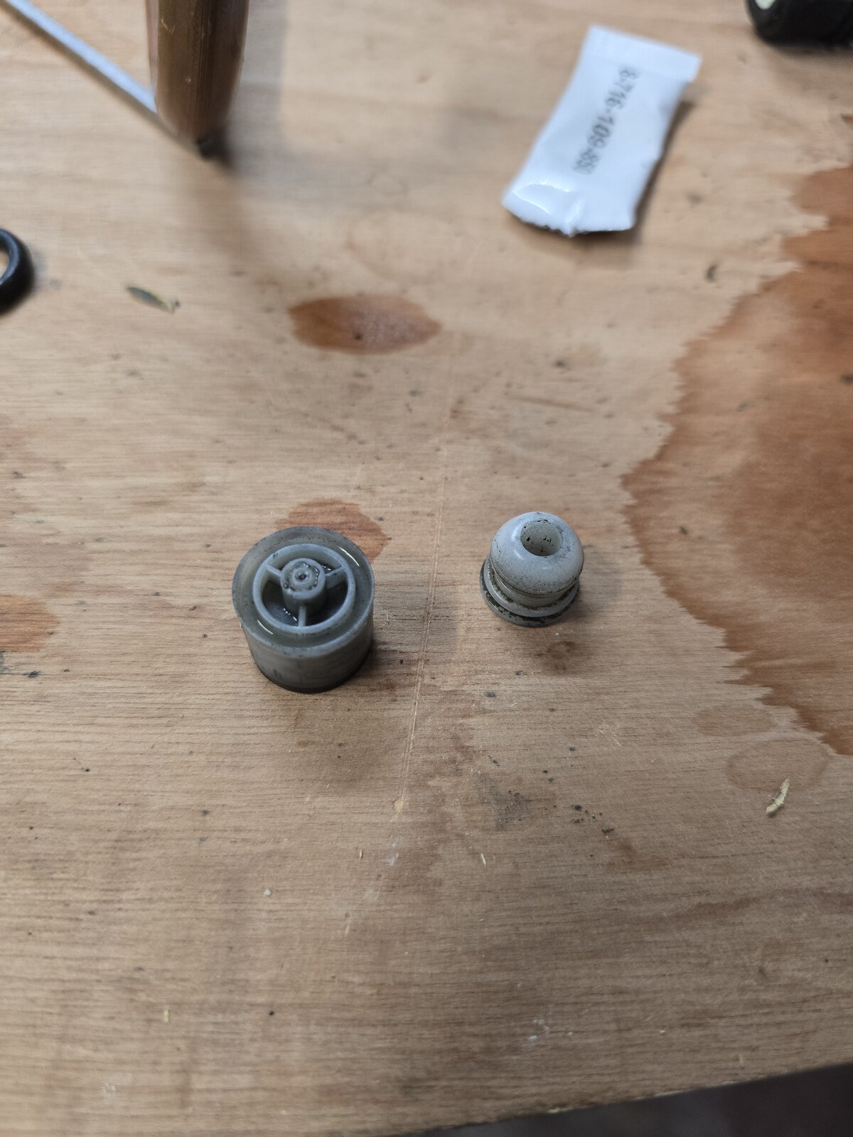

Left part is Part of the bypass assembly and appears to be already fitted in my new rhs manifold. If anyone's looking in the future.
Still not sure what this domed item is though
Cheers

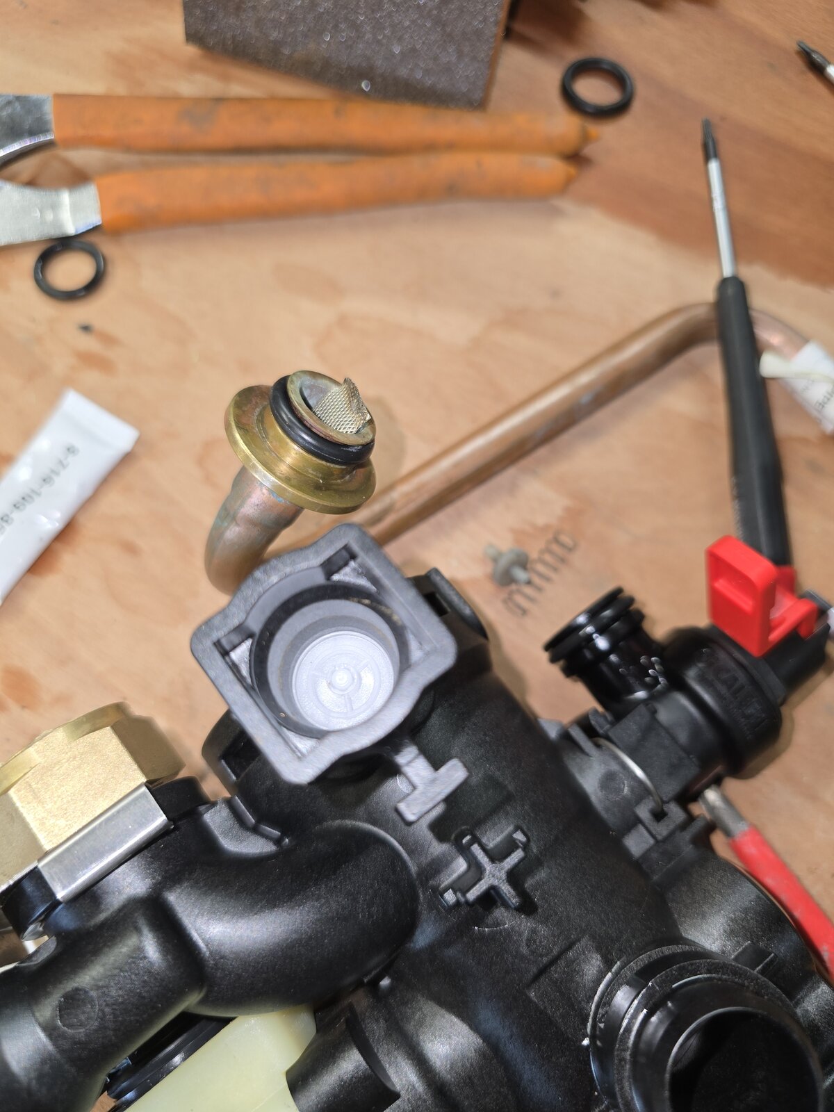

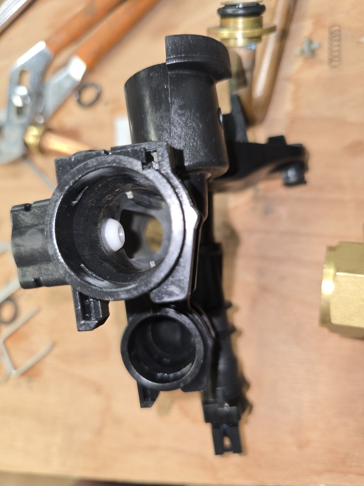

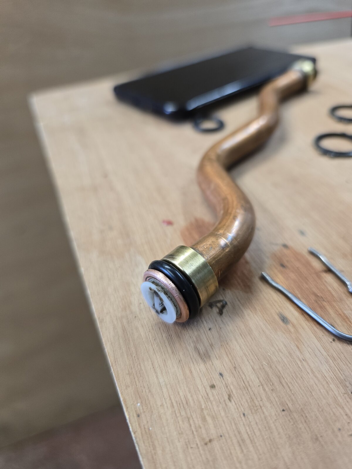

Looks like it may fit in the lhs manifold in the appature that the lh to Rh manifold pipe sits. Pipe seats over it but clip just off ( might be able to force it but don't want to if not correct location)
New lhs manifold doesn't have one pre installed though.
Doesn't look like itll go in the rhs end as it's just rattling about in there
Thanks again

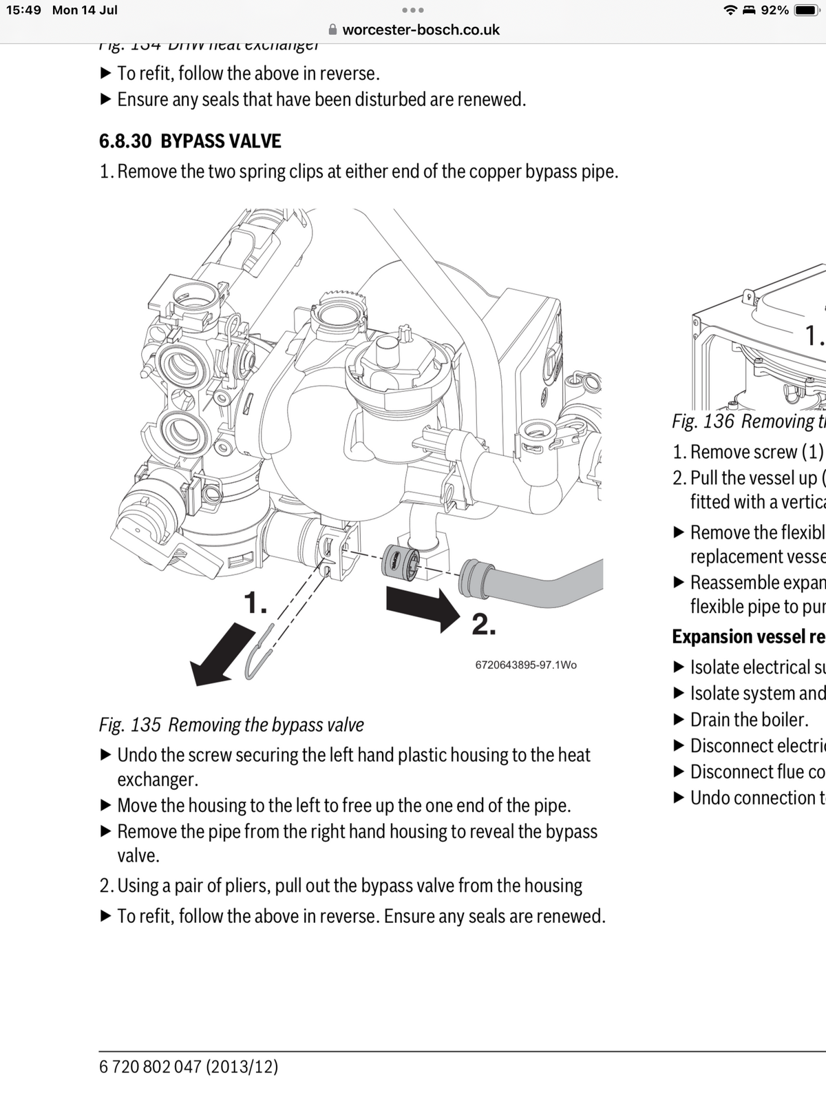

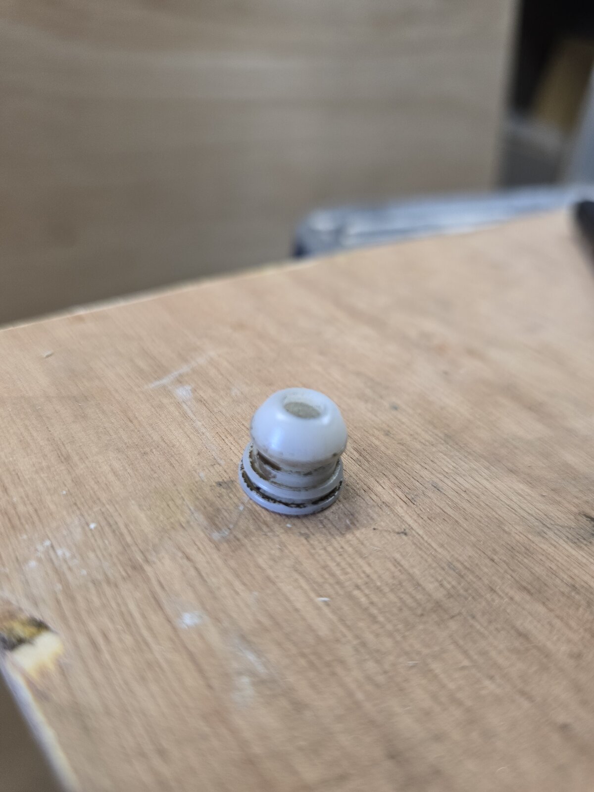

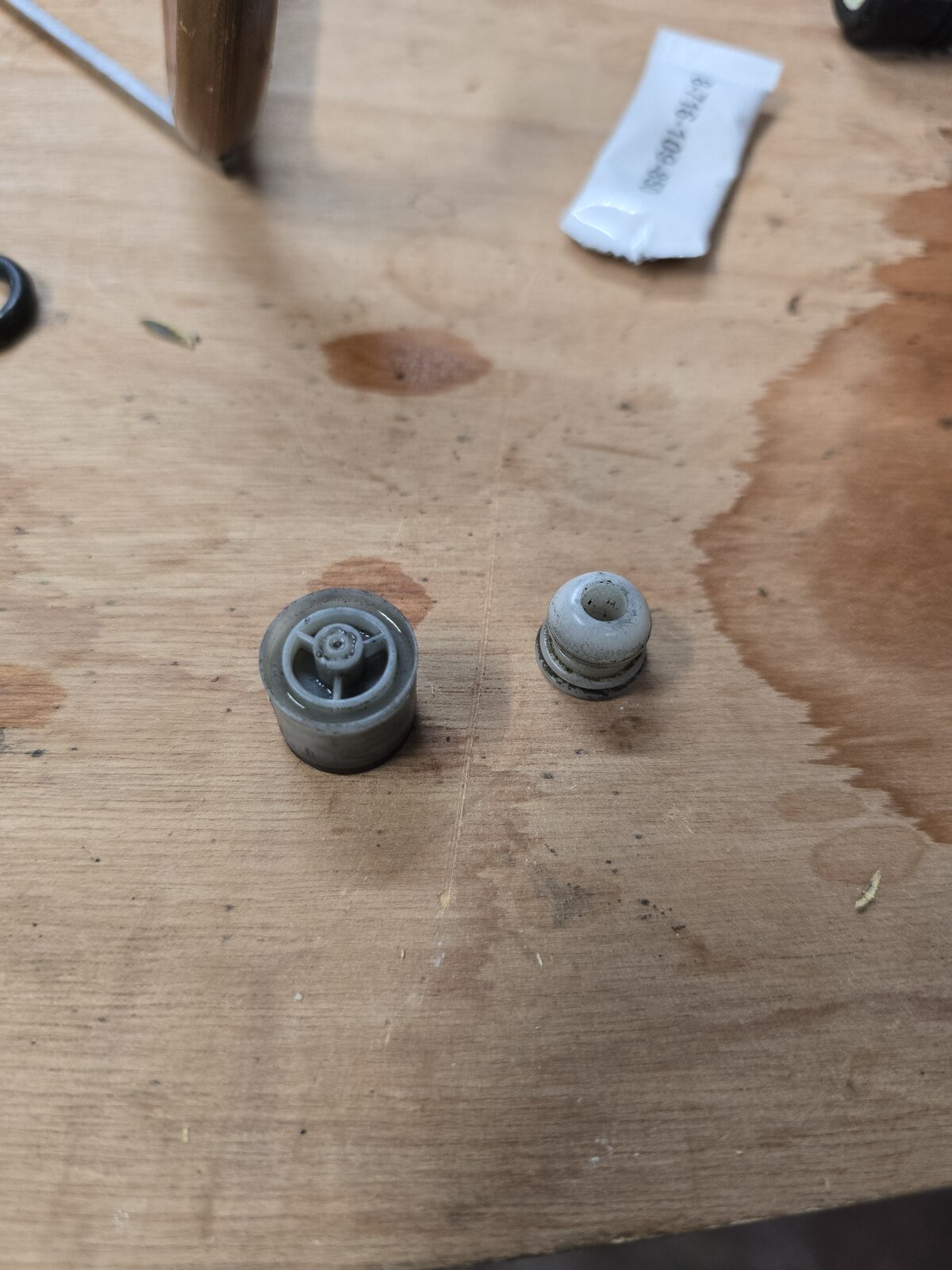

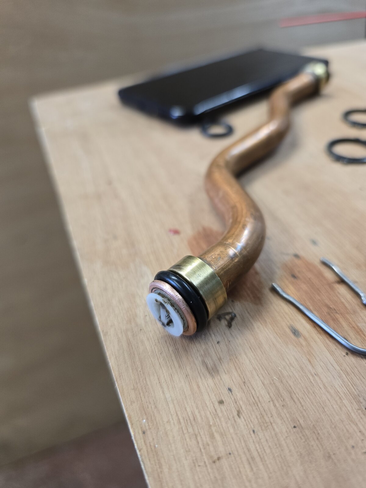

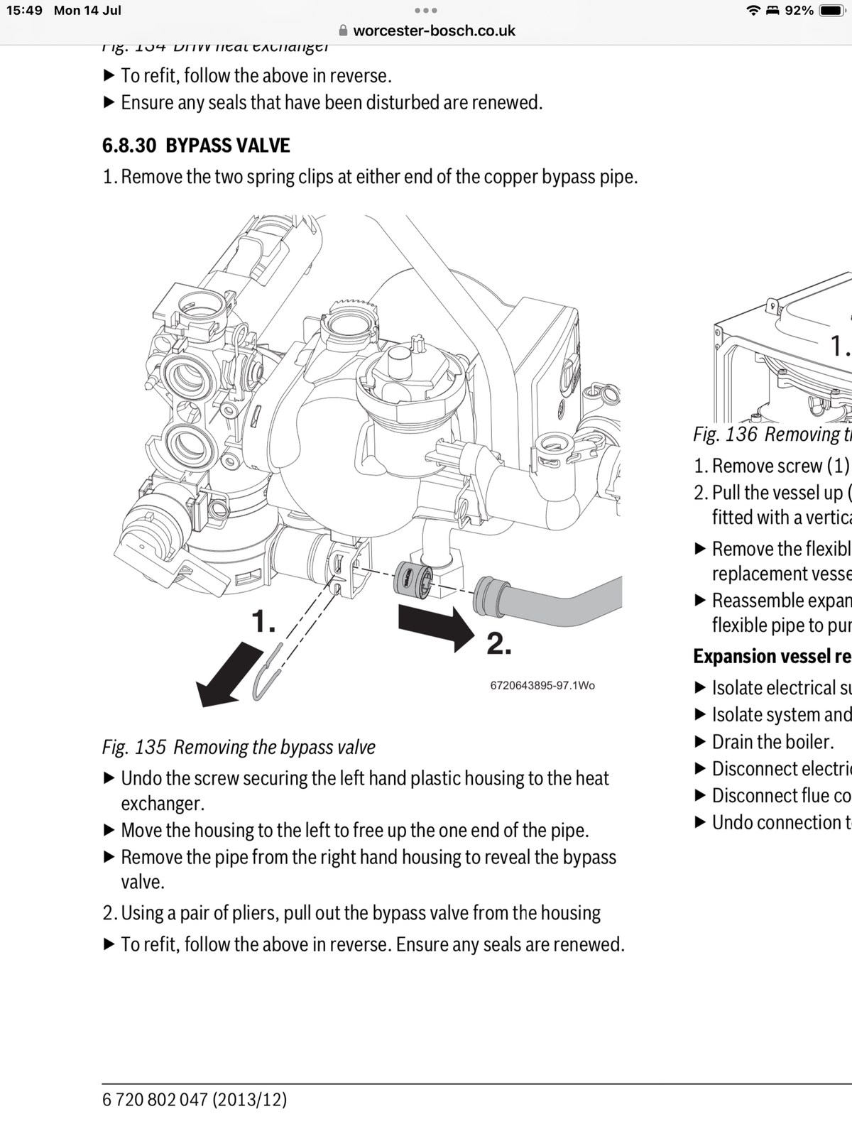

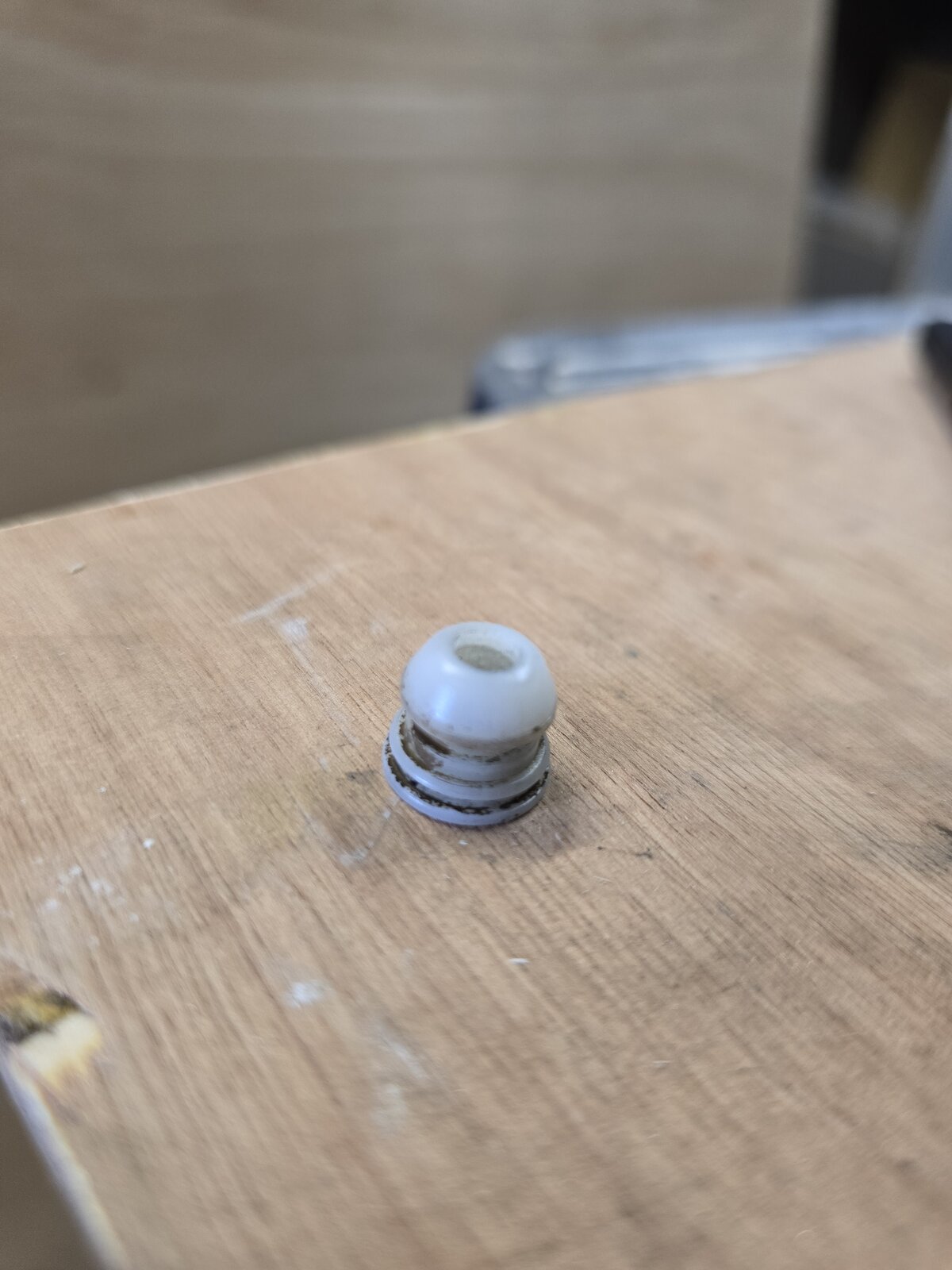

Thank you, I've found that one already fitted into the new rhs manifold (return block)
So im happy where that goes, it's the piece below im not sure on. Any idea with this one please?
Thanks for the help really appreciated
