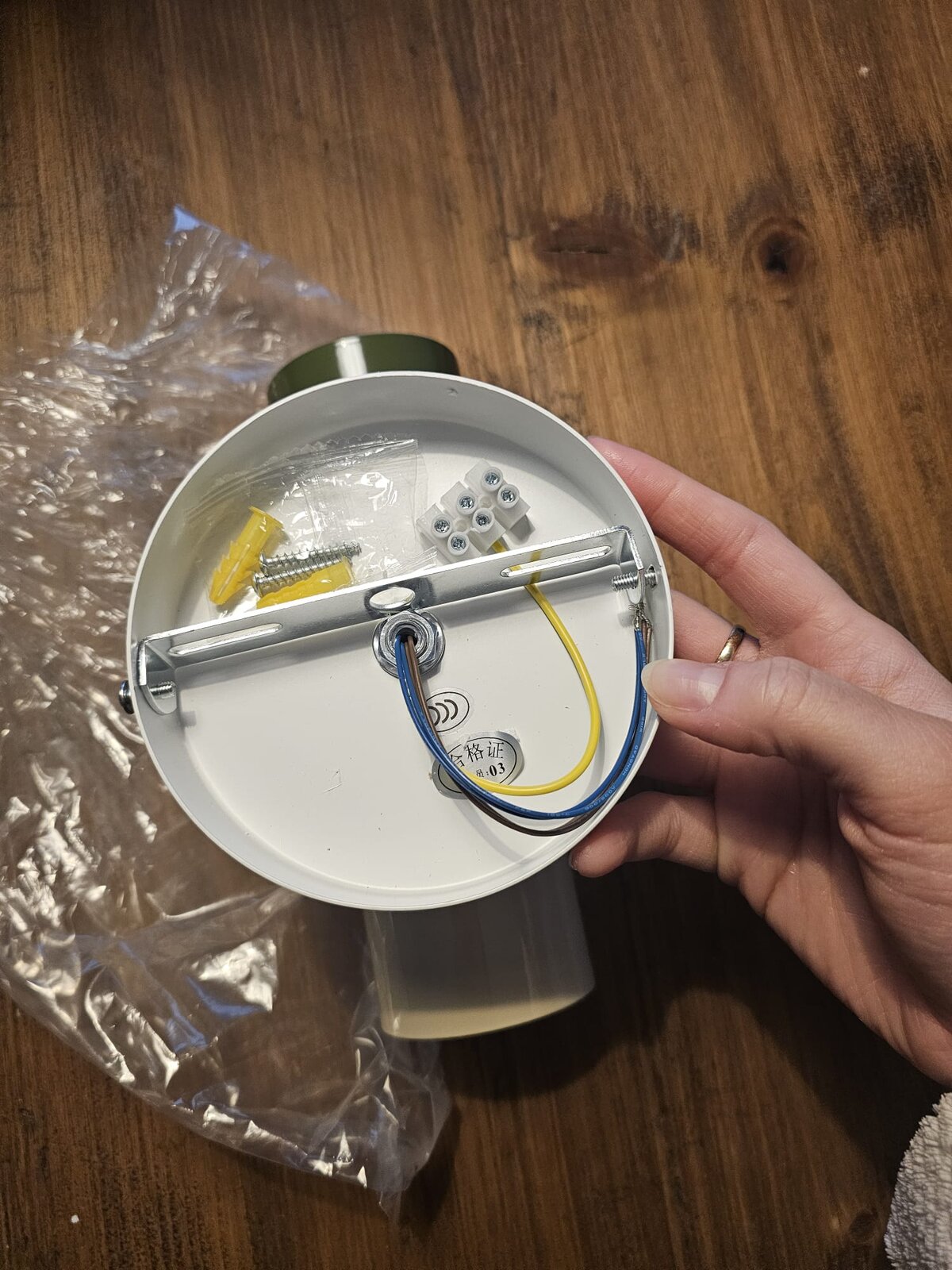

So I disconnected one of the new living room lights, and connected it to the connector block in the kitchen. Worked fine with the switch from the wall turning off and on.
Connected new light in the living room also worked fine off and on with the switch on the light and the switch on the wall.
Yes only difference I can see is wattage. The living room light does have a ground but that doesn't seem to have made a difference otherwise the cabinet light wouldn't have worked in the living room.
Pic of other light, I don't have a pic of it working but it was wired up the same minus the earth. I used the same connector block that is already in the kitchen, not the one in the pic below:

Basically I have tried another light wired up the same under the cupboard and that worked, I have tried the cupboard light wired into another place and it worked then. So I know the light works, and I know the wires in the place I want to put it work.
It's just the cupboard light doesn't work when wired in under the cupboard. I have connected it all up the same in each place.

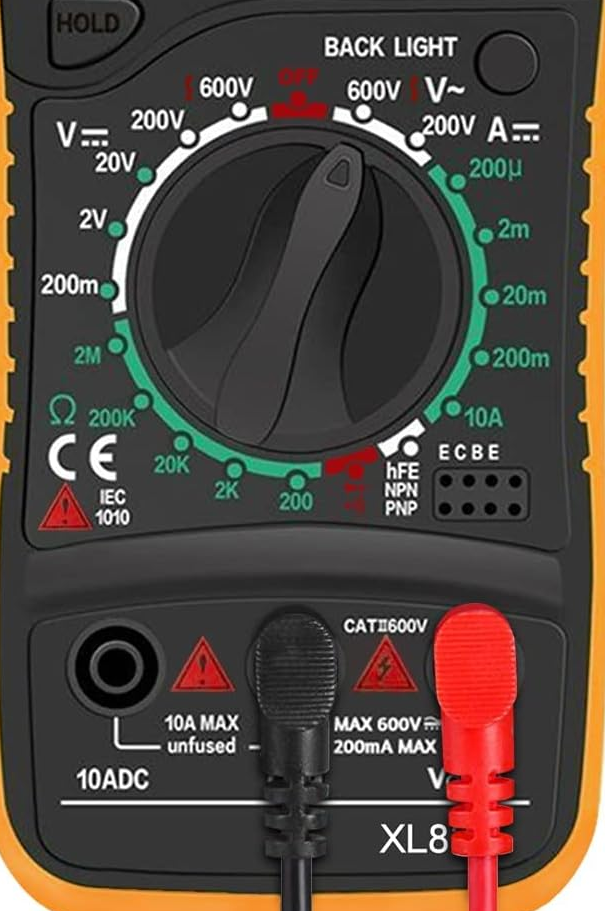

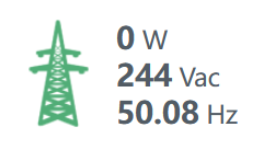

Leads and switch as shown in picture 1705407380672.png it needs to be measured with light on. Note mains voltage does vary a little 1705407638249.pngthis is what my solar panel software says it is now, it can be in theroy 216 to 254 but in real terms 220 to 245 volt is normal.
very strange ...
