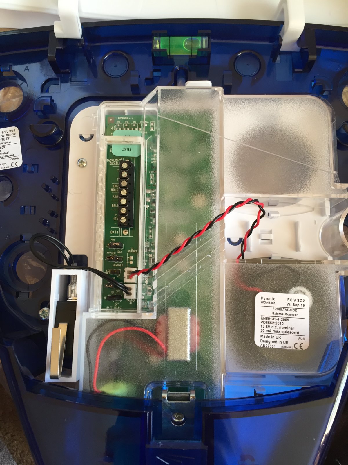

When you say change it over , is it a switch Im looking for?
Took a picture of inside the bell box just to clarify as I cant find anything to turn on/off?
It's the little black jumper J8 at the bottom
You need to change it from ext batt to int batt
