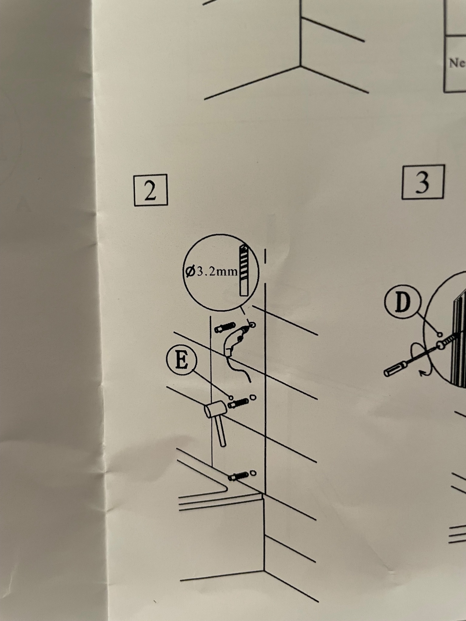

I need a 3.2mm drill bit for tiles. So I guess diamond tipped? It’s to put up a shower screen.
I cannot for the life of me find a 3.2mm drill bit for tile.
Help?!
Why does it need to be 3.2mm diameter? And what are you going to put through the hole that is thinner than 3.2mm?

These are the instructions. It’s a shower screen. I took this to mean a 3.2mm drill bit.

A 6mm bit would make more sense. But what’s the reference to a 3.2mm
You'll find it even harder to find a 3.2mm plug!
Drill a bigger hole to suit the plugs you will use
I mean, the instructions really do make it look like they want you to drill a 3.2 mm hole in the wall but it’s a ludicrous level of precision for a hole in masonry, that doesn’t even make sense, because you’d be fitting a 3mm plug with 1mm of plastic around a 1mm hole and then driving in a 1mm screw. To hold up a shower screen? Clearly absolute nonsense that would see you wearing the screen/it in bits on the floor
I’d expect more like you use a 5-7mm bit and plug to hold the mounting channel to the wall, then you drill a 3mm hole in the channel and screen edge and screw in a self tapper, after you’ve arranged the screen so that it’s plumb; screens often come with a U shaped channel that goes on the wall first and grips another metal bar running down the side of the screen, to allow the wall to be slightly out of plumb/squate and still mount the screen with no gaps

Don’t stress about 3.2mm - get a 3 if you can’t find anything; the screw will wind into it fine. Feel free to post a picture of everything that was in the package so we can check

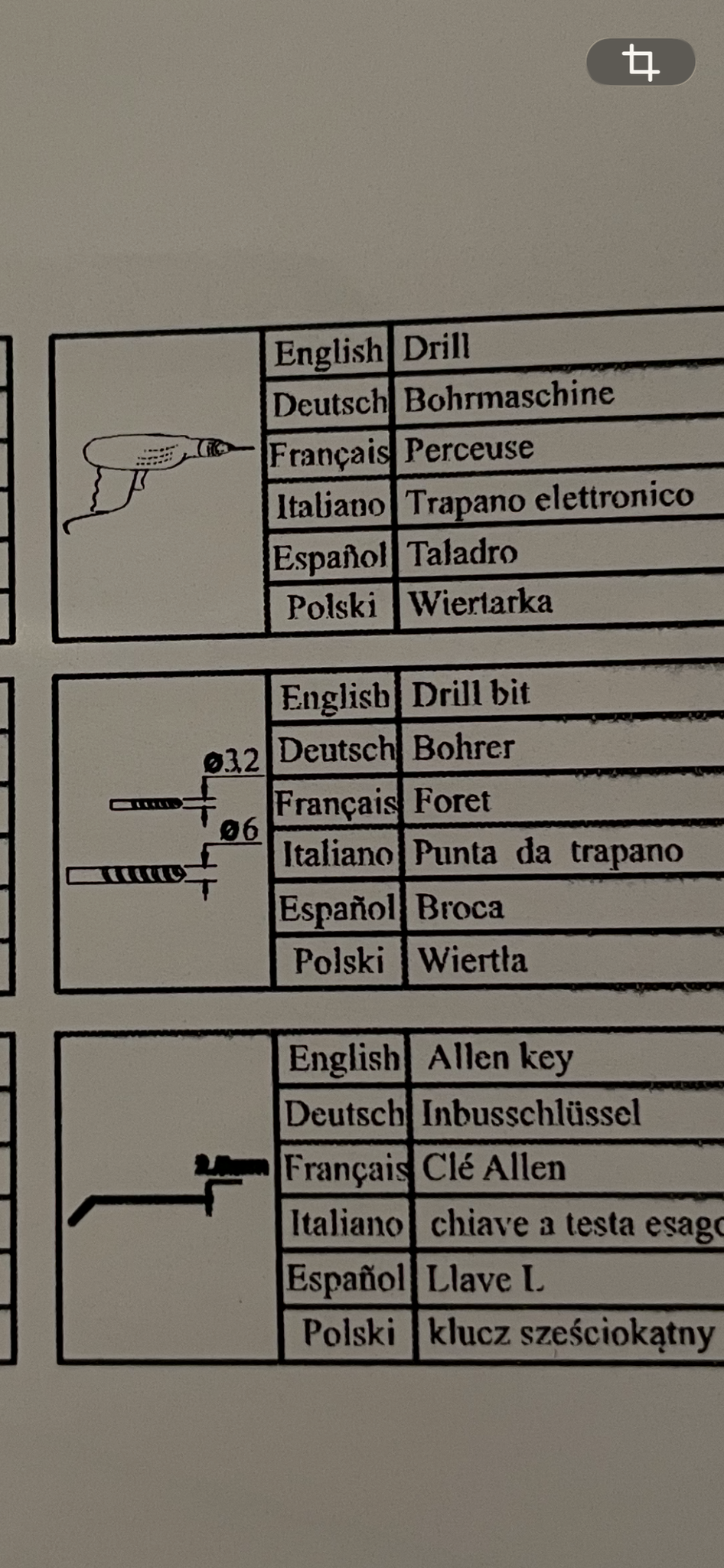

The 3.2mm bit is to make or enlarge a hole in the metal structure of the shower screen. Makita do them in hss steel. It’s probably for a 3.5mm fixing.
3.2mm is an eighth of an inch (1/8). I would just use a 3mm bit. But if you must have it,look for an eighth part bit.
for the accuracy needed, just use a 3mm bit and push it in and out of the hole a few times on max speed, it will soon get to 3.2
