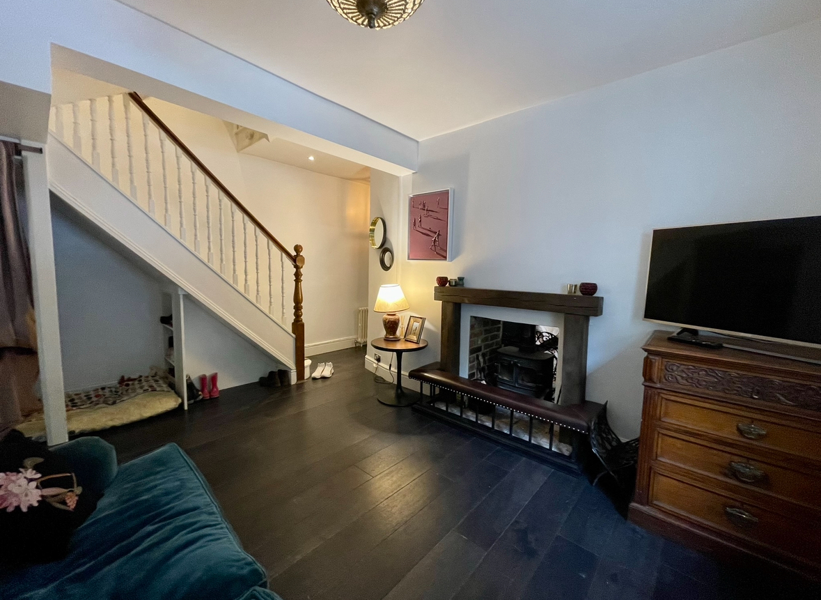

I bought a house with an existing open plan loft conservation. The house is two floors and the loft.
Bottom floor: Hallway leading to small, open plan dining room, directly next to the staircase:

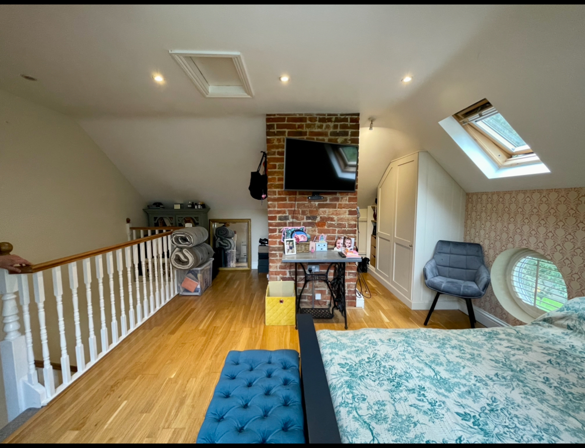

You go up the stairs to the middle floor, then up the stairs again to the loft conversion:

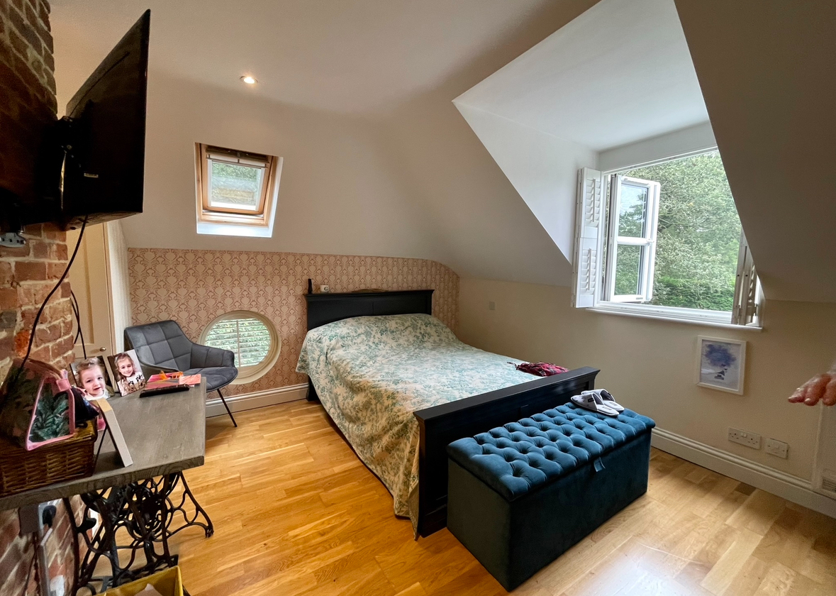

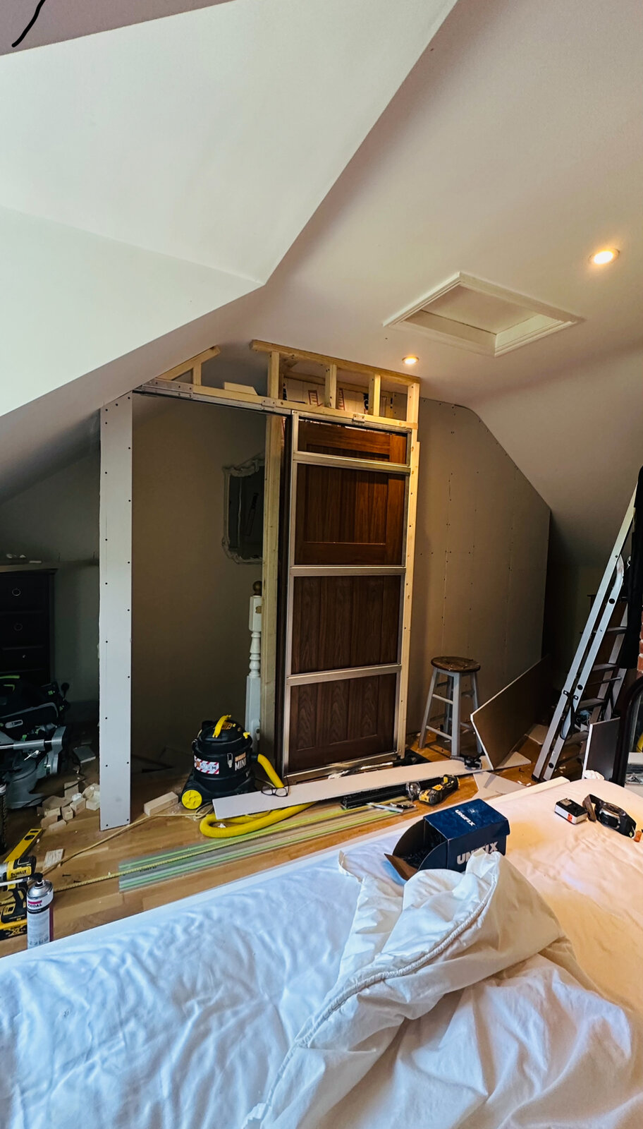

I have now removed the bannister and added a wall and fire rated door:
As I'd understood the fire regs, I was OK because I had a fire rated door, and an unobstructed run from the loft through to the front door, but apparently, the existence of this dining room next to the staircase means I'm in breach of regs?
I have smoke detectors on every floor, and every other door in the house is fire rated.
Am I OK here, and in the event that I'm not, what are my quickest means of complying with building regs?
Thanks!
My understanding is that the protected escape route should offer 30 minutes of fire protection, all the way to the exit.
Having a dining room open plan to the hallway wouldn't comply.
This may be mitigated against by providing sprinklers in the dining room (if BC agree), or by boarding in the stairway.

So originally, in 2003, the loft conversion was completed. It was an open plan conversion, where the loft was accessible via a standard staircase, with banisters, etc.. When we bought the house, we took the loft room as our bedroom, but since it was open plan, it wasn't very private, so I've decided, after two years of daily 4am wakeups by our cats, to remove the bannisters and close off the loft with a wall, as visible in the pictures. The house is also extremely cold, and I figured putting in the wall on the loft and turning it into a proper room would create better heat retention within the room itself and the rest of the house.
This has been completed, but as I now understand it, I've fallen afoul of fire safety regs, and need to make things right. I followed bilding regs as far as insulation, placement ofdoor, etc, but I wasn't aware of the fire safety regs.
The original loft conversion was signed off by building control, that's all good. However, I'm assuming that no longer counts, since I've added the wall that effectively closes off the loft and turns it into a habitable room. I now want to know the best steps to take to make myself good again, and as far as I can tell, it seems to be putting up a wall in the dining room so that there's once again an uninterrupted route from the loft room to the front door
