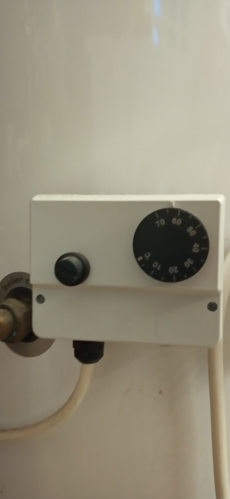

Hi there, I just wanted to check it's not something I can check before I get an engineer out...
Basically the system boiler isn't heating the water for the hot water tank as hot as it used to.

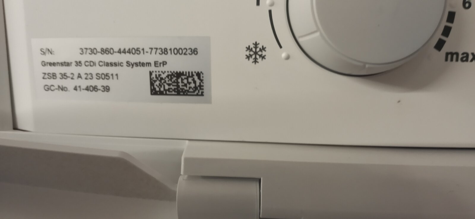

Details: Worcester Bosch Greenstar 35 CDi Classic, about 4 years old, serviced annually by the local company that installed it, always worked well.
I noticed today that it just isn't heating the water going to the tank as hot as it used to. Thermostat on tank is up and clicked on, tap water power on boiler is set higher, not sure what else to look at,
Thanks for your thoughts, let me know if you want different info or pics.

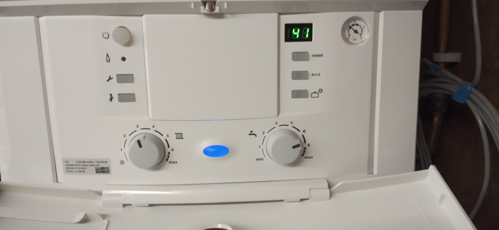

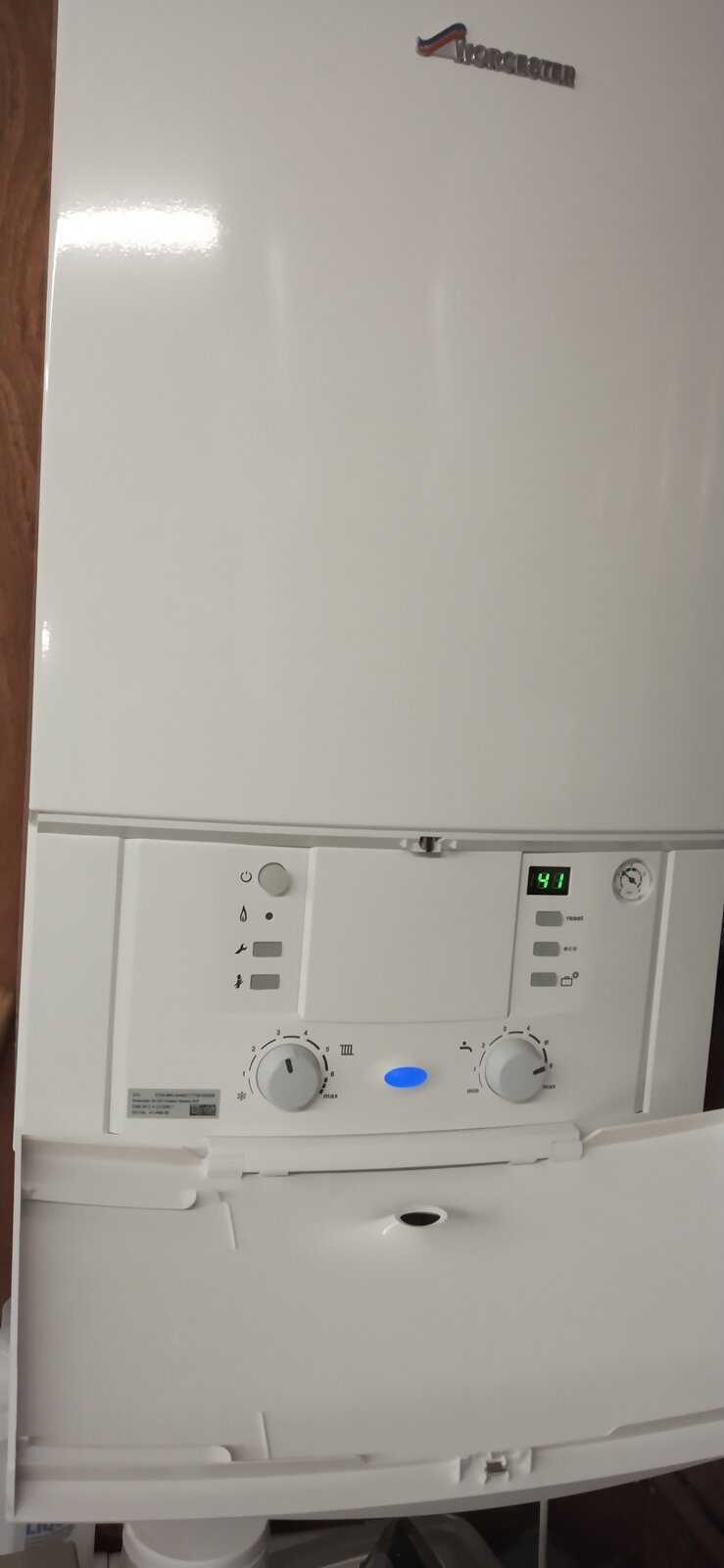

when the boiler is firing to heat the hot water only, what number do you get on the digital display?
On this system boiler when you have external motorised valves only the thermostat with the picture of the radiator is used.
The one with the picture of the tap doesn't do anything unless it has an integral motorised valve. (Which you don't)
So basically you need to turn up the thermostat with the picture of a radiator on it.

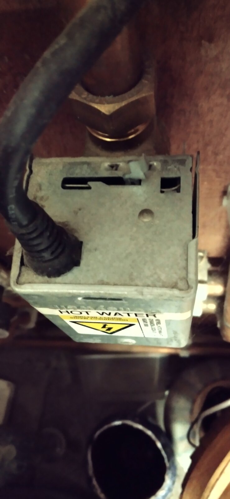

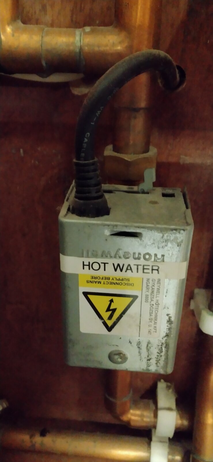

When on DHW, can you feel heat going into the cylinder coil?
Check motorised valves are opening and closing according to demand.
First things first, turn boiler stat up as mentioned above.
Thanks all, yes that worked - turning up the central heating temperature control increased the temperature going to the cylinder coil.
The feeds to all the CH loops remained cool beyond their motorised valves.
I assume the hot water motorised valve is working correctly - it's making a noise on being turned on and turned off, and the hot water is moving through it.
