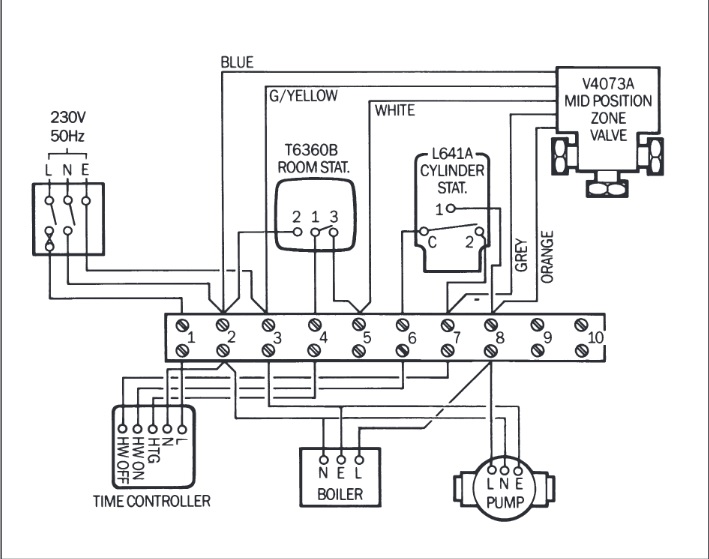

On the cylinder stat there are two sets of contacts, one set normally open, one set normally closed, don't like that terminology as you need to define normal.
With power to make some thing happen easy to understand, but with the Y Plan the grey wire is powered to stop hot water, so a fault with time controller (programmer), cylinder thermostat, three port valve, or wiring can all cause the DHW to get too hot when the central heating is running.
When central heating not running then must be the cylinder thermostat, but when running so many things can cause over heating.
With my C Plan I simply have not control anyway, so not such a big deal.
I have shown the Y Plan Y-Plan.jpg however not easy to test, as the valve is complex. mid-position-valve.jpg The diodes and resistors in the valve mean need a volt meter to fault find, first time I came across Y plan I also had problems, I felt likely problem was the V3 micro switch, but not sure, Sunday so could not buy a V3 micro switch, so only option was whole valve, and it fixed it.

That is, or could be, the problem. Without studying the mid-position valve operation in detail, I would think if something goes wrong it defaults to the HW position, like the either/or W-plan valve. So if CH is calling, the cylinder gets overheated.
