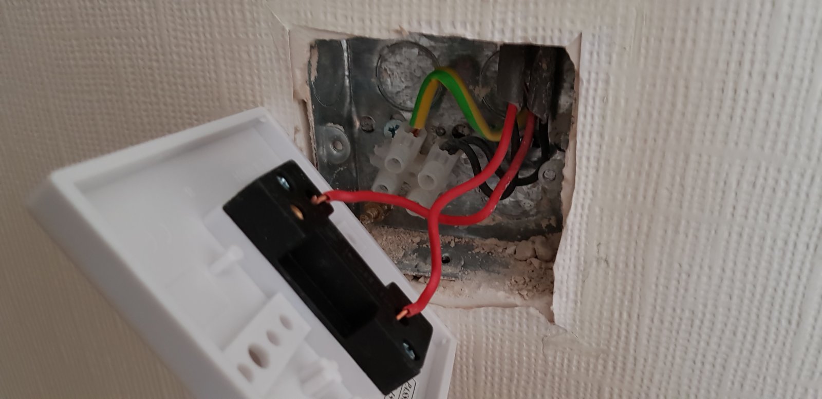

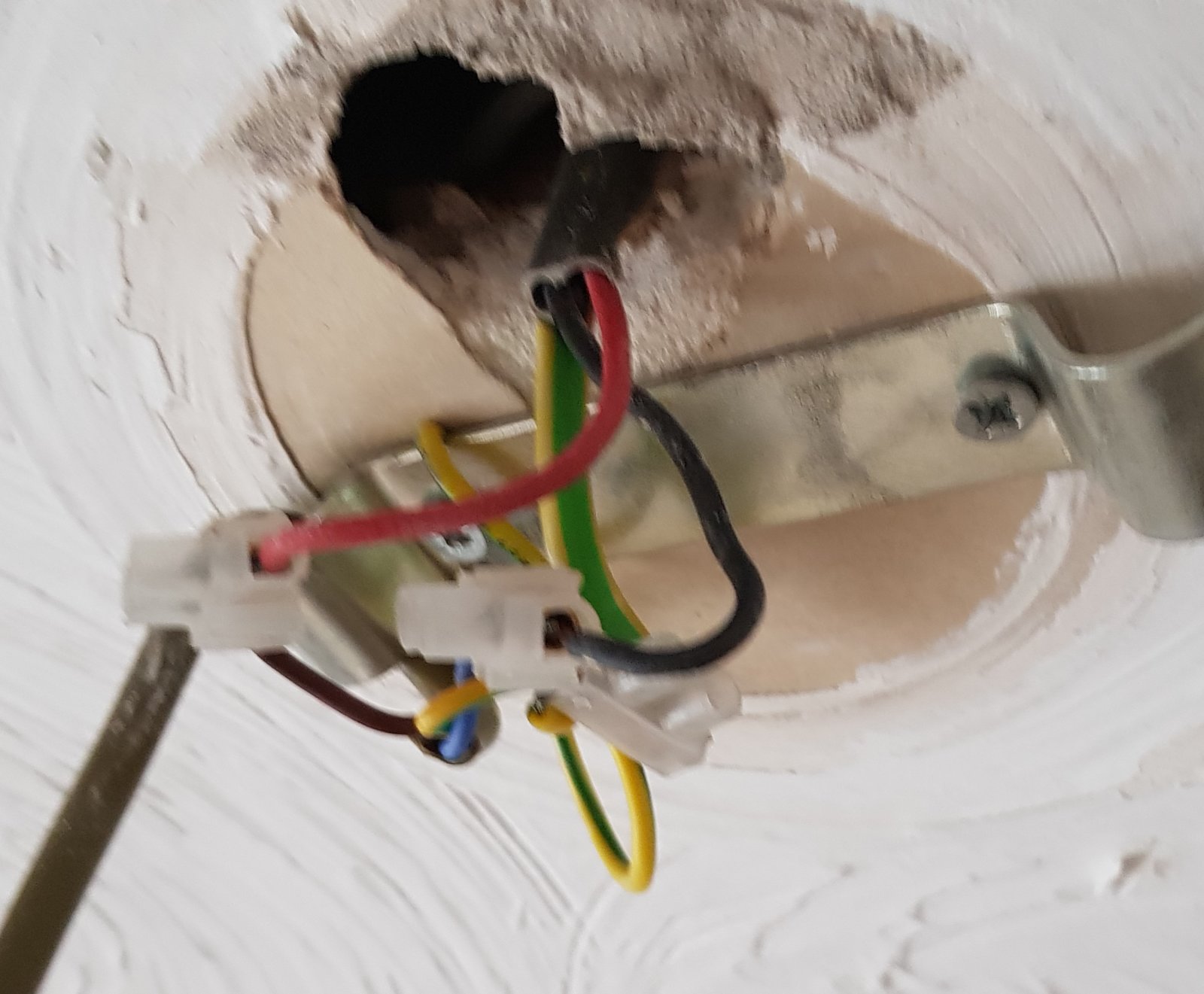

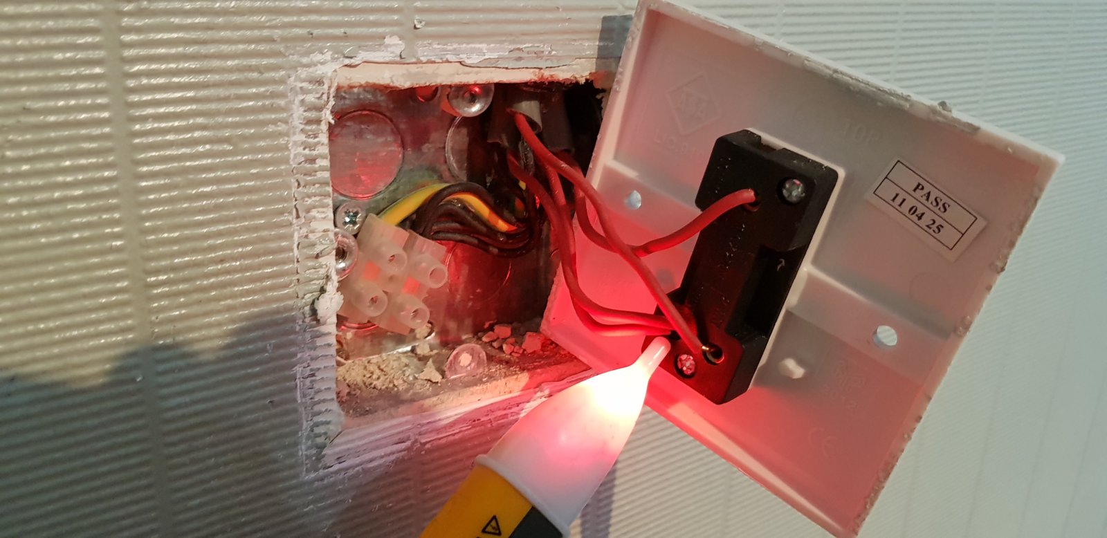

Hi, Problem with downstairs light not working, has worked for years previously just stopped working one day , have no live feed to switch or light connections so I'm guessing that we must have a junction box somewhere & radial wiring so a loose connection in a junction box? I have checked the continuity from the red out wire to the lamp and it's OK. 3 wires run into the light red, black & earth. I have traced the switch 2 black neutral wires with a toner 1 goes to the CH thermostat the other goes in the same direction but stops short of the thermostat, when the 2 black wires are separated the thermostat stops working. How do I locate the junction box if there is one to minimise the work to rectify if behind plaster wall or ceiling, are wire detectors any good? Thanks appreciate any help I'm stumped. Photo 1 of light switch. Photo 2 of kitchen light switch in the next room.
Kitchen light switch (second picture) is wired wrong.
I don't think you have any junction boxes, each switch acts as the junction box.
The kitchen light has been like that since we moved in 14 years ago as far as I know, can you tell me what's wrong with it, do you think it has a bearing on the light not working? I get your point about the switches but where is the break in the feed to the switch? I have checked all the downstairs rooms for any loose wires.
Re check all the switchs. As the permanent line runs from switch to switch its the most obvious place for a loose connection / broken conductor . Make sure all terminal screws are tight.
I should have said, the kitchen switch MAY be wired wrong.
It looks like all three terminals on the switch have wires in them.

If the kitchen light only has one switch, only two terminals on the switch should be used, it looks like three on your picture.
So maybe this is related to your problem, maybe it isn't.

Assuming the two wires at the bottom are feeds, and the top wire is the kitchen light, then that bottom one wire is never going to become live, so that bottom one wire may well be the feed to the light switch that has no power.
In other words, a one way switch as you should have in your kitchen should consist of all the 'permanent lives' in one end of the switch, the 'live to the light' in the other end of the switch.
A one way switch typically uses terminals COM and L1. Different makers use different markings though.

Sparkright apt name as you were 'wright' spot on, light now working thanks for your help, I was worried I would have to lift the floor boards or plaster so its a big relief. Think some one has changed a broken switch and replaced it with a 2 way switch and wired up wrong due to extra connector, the house was rented for a while so I'm guessing it happened then so I never connected the 2 events, so to me it seemed to stop working suddenly. Big thanks again all.
