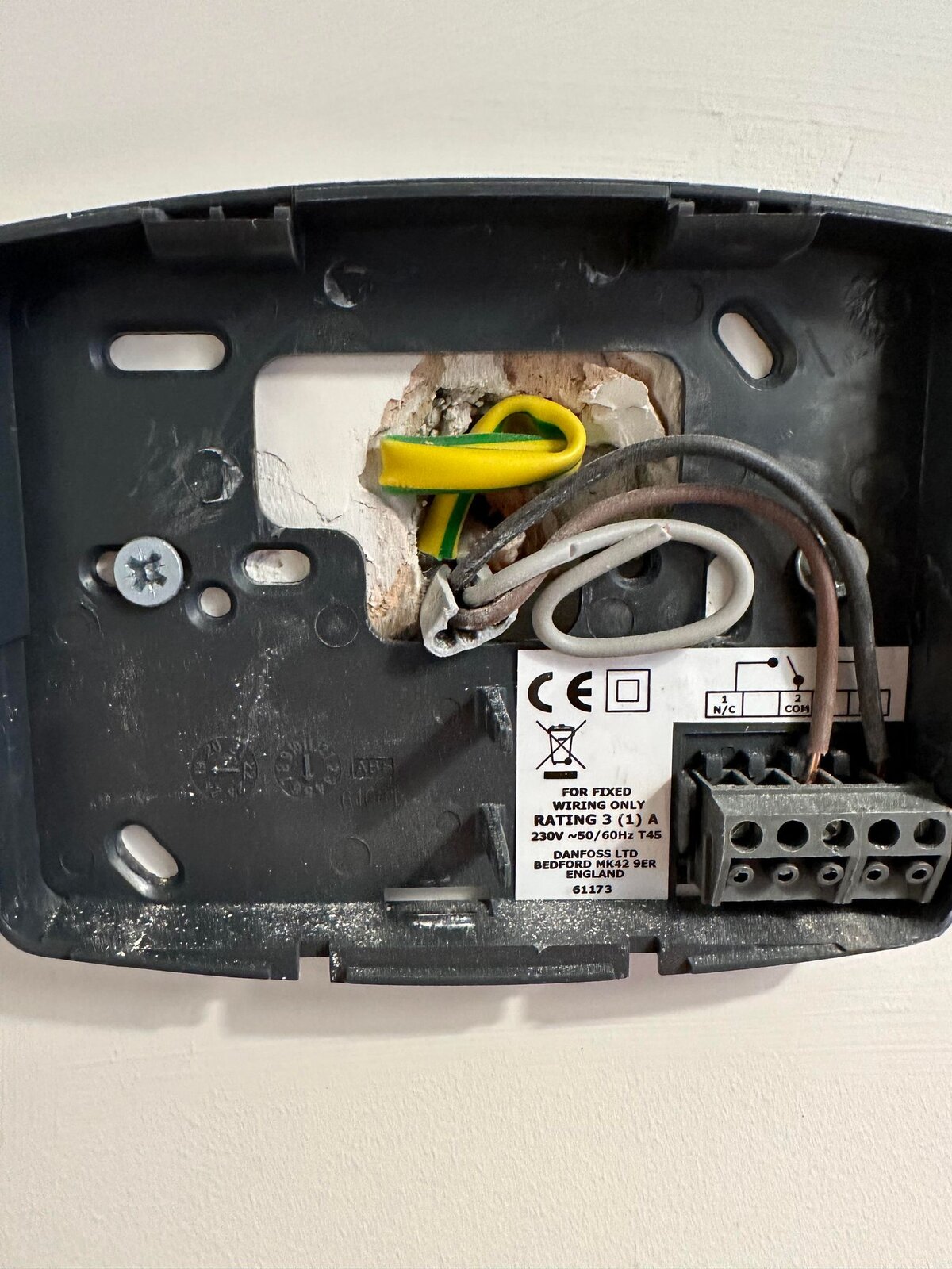

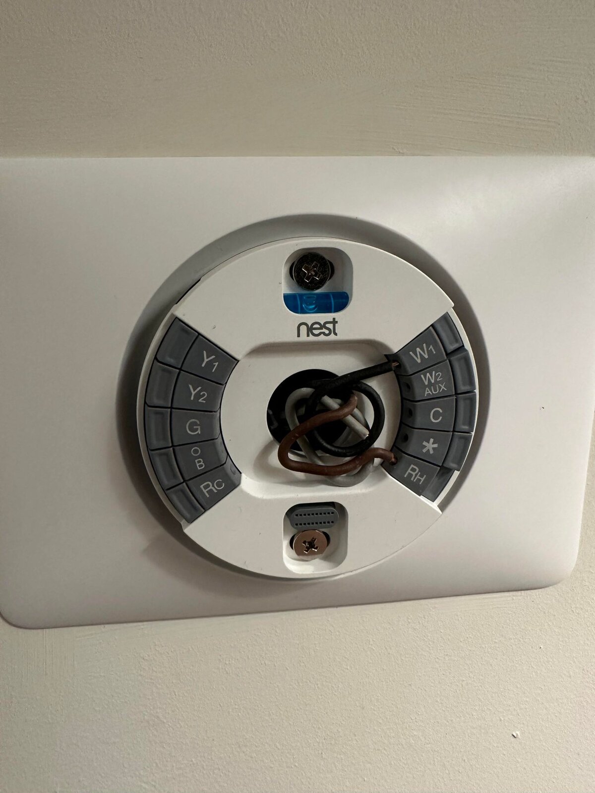

Hello all, I bought myself a new thermostat after doing a online compatibility test and proceeded to try the install. My previous unit had two cables coming from it, COM and N/O, this lead me to believe i had a two wire system. After looking around I found that with two wire systems Im meant to plug the cables into W1 and Rh of the nest unit. I did this and after powering on my boiler and letting everything settle I noticed that even after setting the thermostat to 9C it would keep the radiators on and is clearly not working. Have I missed anything? Images included below
As above questions, and I think you’d still need power to it.
Th only 2 wire Nest you will get to work is the Nest E. If you want Nest learning thermostat, then you could use the 2 wires for the T1 and T2 connections for heat link and wire in the rest at the boiler or wiring center
The USA Nest can use sensors in different rooms, but the Europe Nest is a single stand alone unit, there are two for the UK the Gen 3 will work DHW as well and comes as two parts, and the Nest e not used but is two wire only, in fact only wireless thermostat I have seen which is two wire. How you have got a USA version I don't know.
