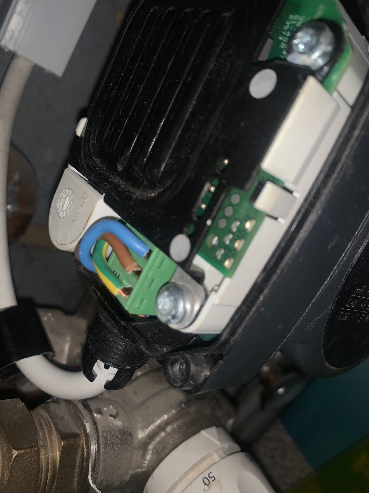

Hi All,
This forum helped me a lot in the past and I am hoping that I can get help and advice this time .
I just noticed that UFH is not working and when checked the pump it appears it has no light on. It has been working fine for 8 years.
There is supply current and boiler control unit (Valliant VRC470) is showing pump status as ON, but there is no light, and pump is clearly not operating. All pipes coming in and out are cold when touching.
I am wondering if it is possible to replace the pump DIY and what would be the best way to do it without flooding the house?
Pump is located inside the base cabinet so access is not ideal but possible.
This is Grundfos UPS2 25-40/60 130.
Should I order exactly the same model or there are better/newer and possibly more reliable options which would fit?
Any help would be very much appreciated as it is quite cold outside.

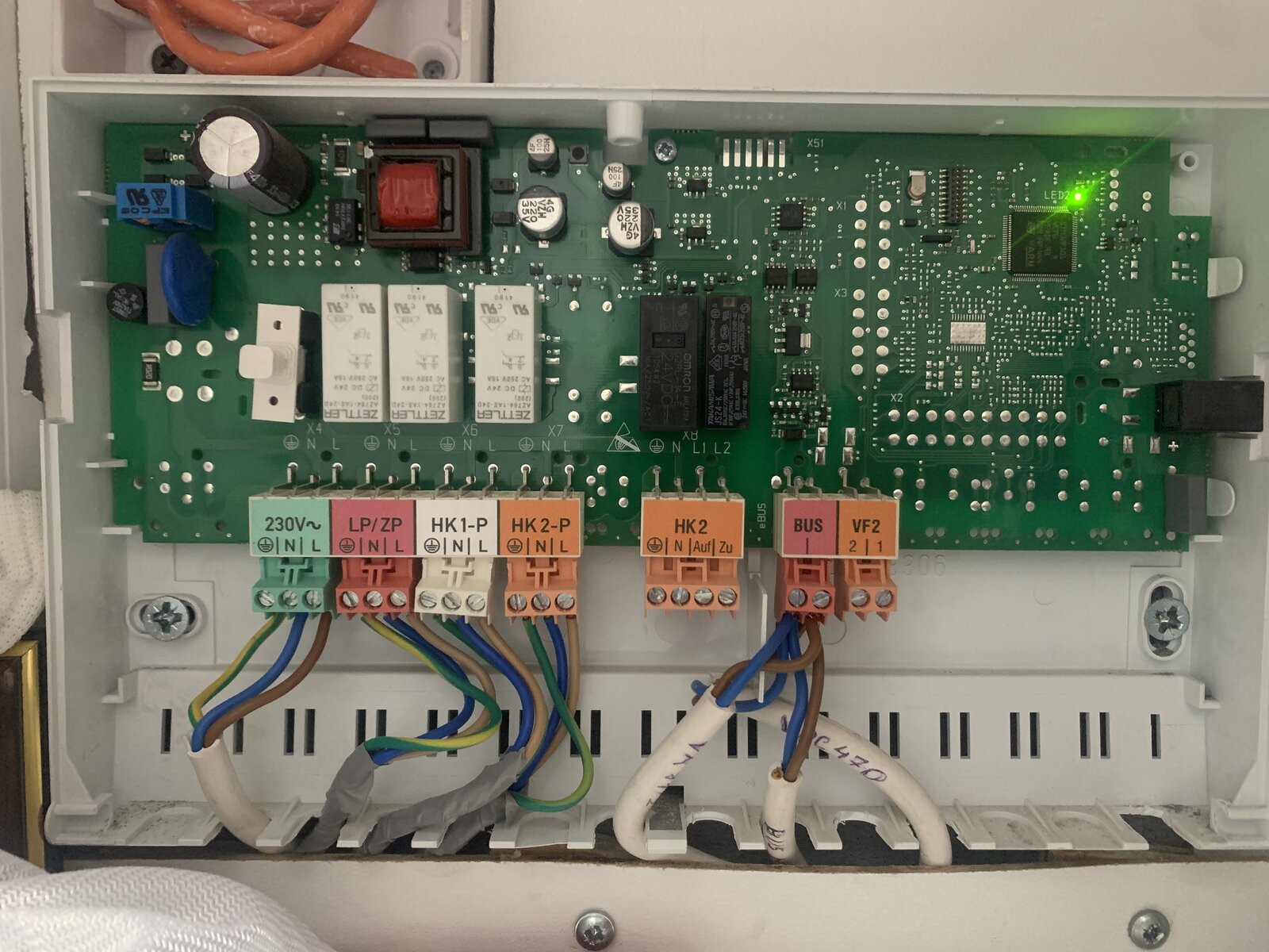

Need to test for 240 v at the underfloor pump before going further
Thank you Cross Thread, I added more photos. Indeed there is no current at the pump at all, the simple tester doesn't light up. There is also no current on the rightmost connector in the wiring box. I tested after boiler fired up to activate UFH.
Not sure what is wrong, but this morning pump and UFH worked, everything was fine, but in the evening not working again and no current.
It also appears that motorised Honeywell valve for UFH and pump are not activated while VRC shows that pump is on UFH working.
Any idea what could be the issue ?

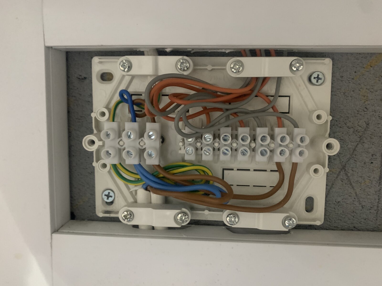

To be precise, you only get current if there is voltage or power.
Voltage is missing hence pump is not running.
Use a multimeter to check for voltage,

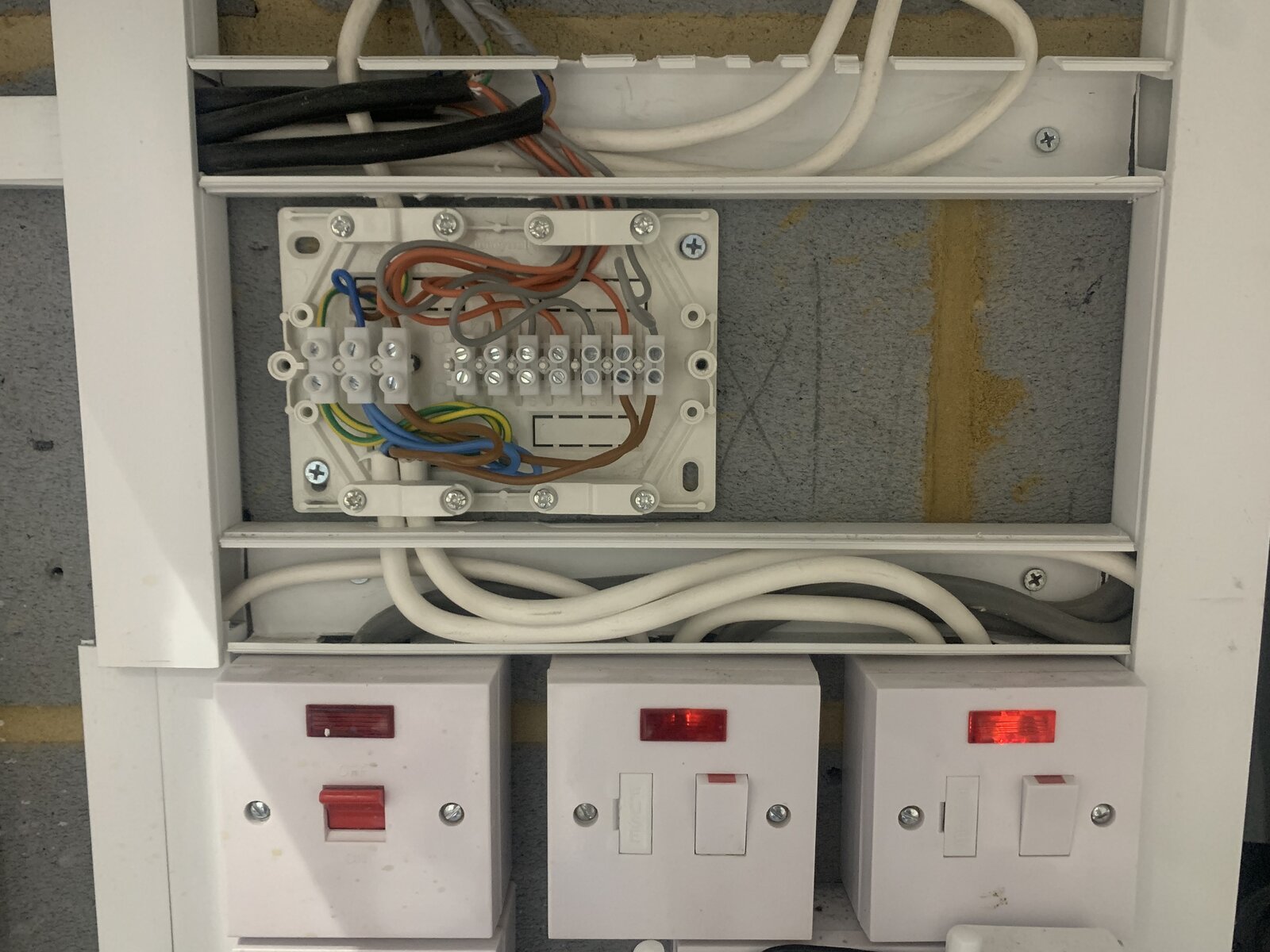

Warning. Be careful what you touch in the box on picture 2
SMPS. High DC voltage and capacitor that will bite long after supply disconnected
