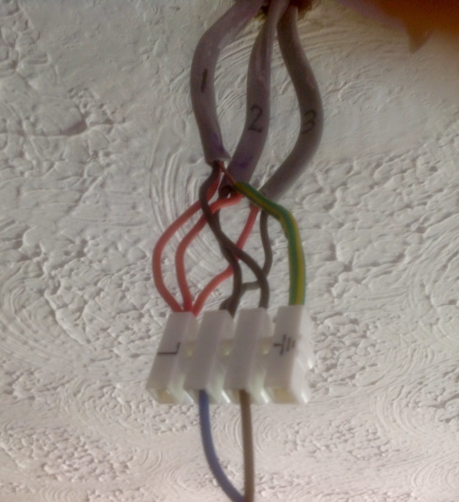

Help - new light flickering.

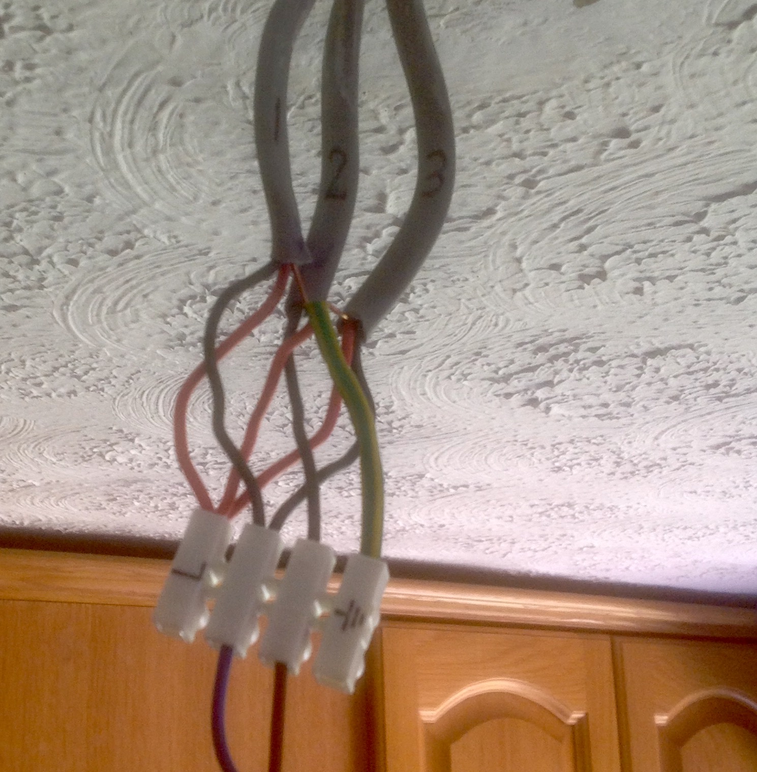

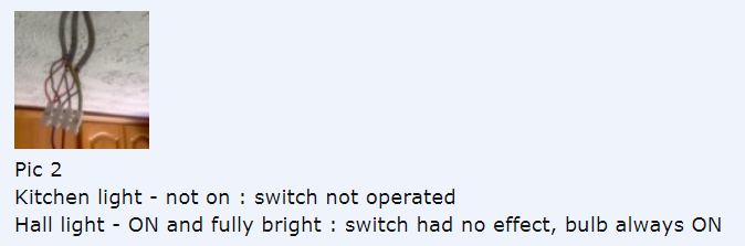

Ok. So that means picture 2 is correct.
Does the kitchen light work properly now?
If so, that then, assuming everything is as it normally is, means that the hall light is wired wrongly.
Cheers my friend.
Yes it is working perfectly now!

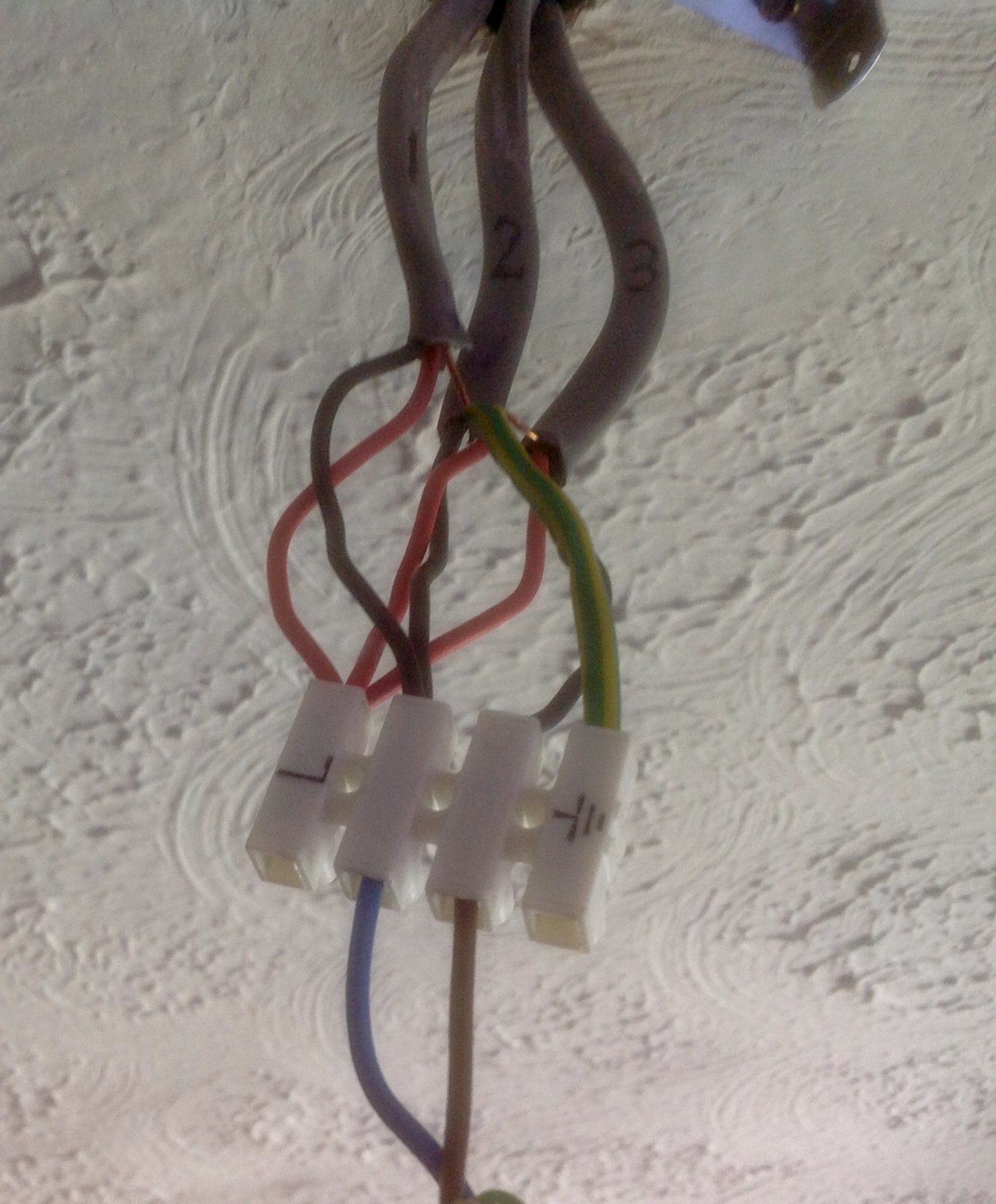

Tomorrow I will sort the other light.
Decided it (or I) couldn't wait, did it after a cuppa, no problems at all.
