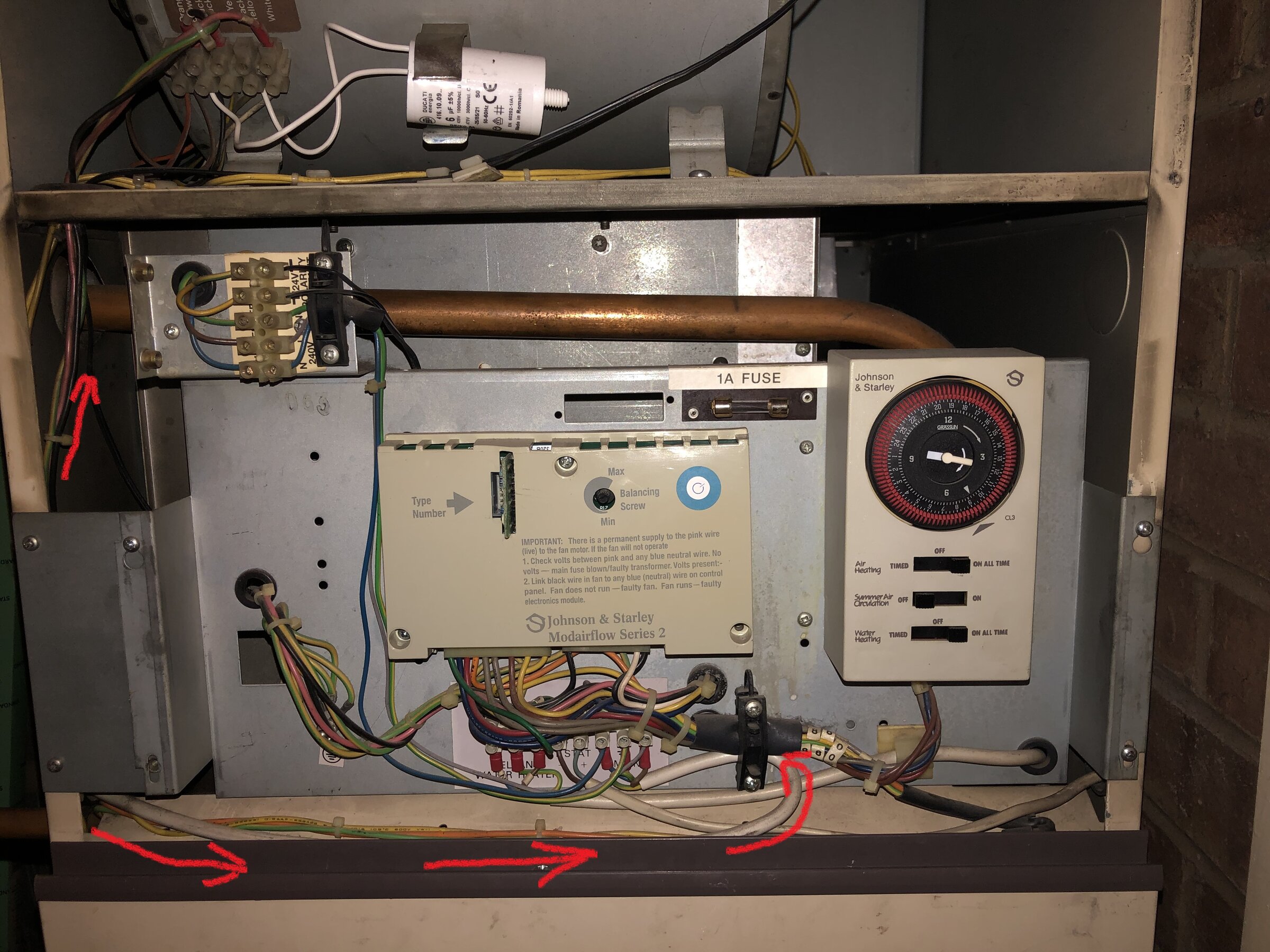

Hi Ian, I'm not too sure what you mean by plug & plate so here is a photo - I've marked with red lines where the wires come in from the wall plug - although they meet a bunch of other wires already there so don't know if that was what you meant!

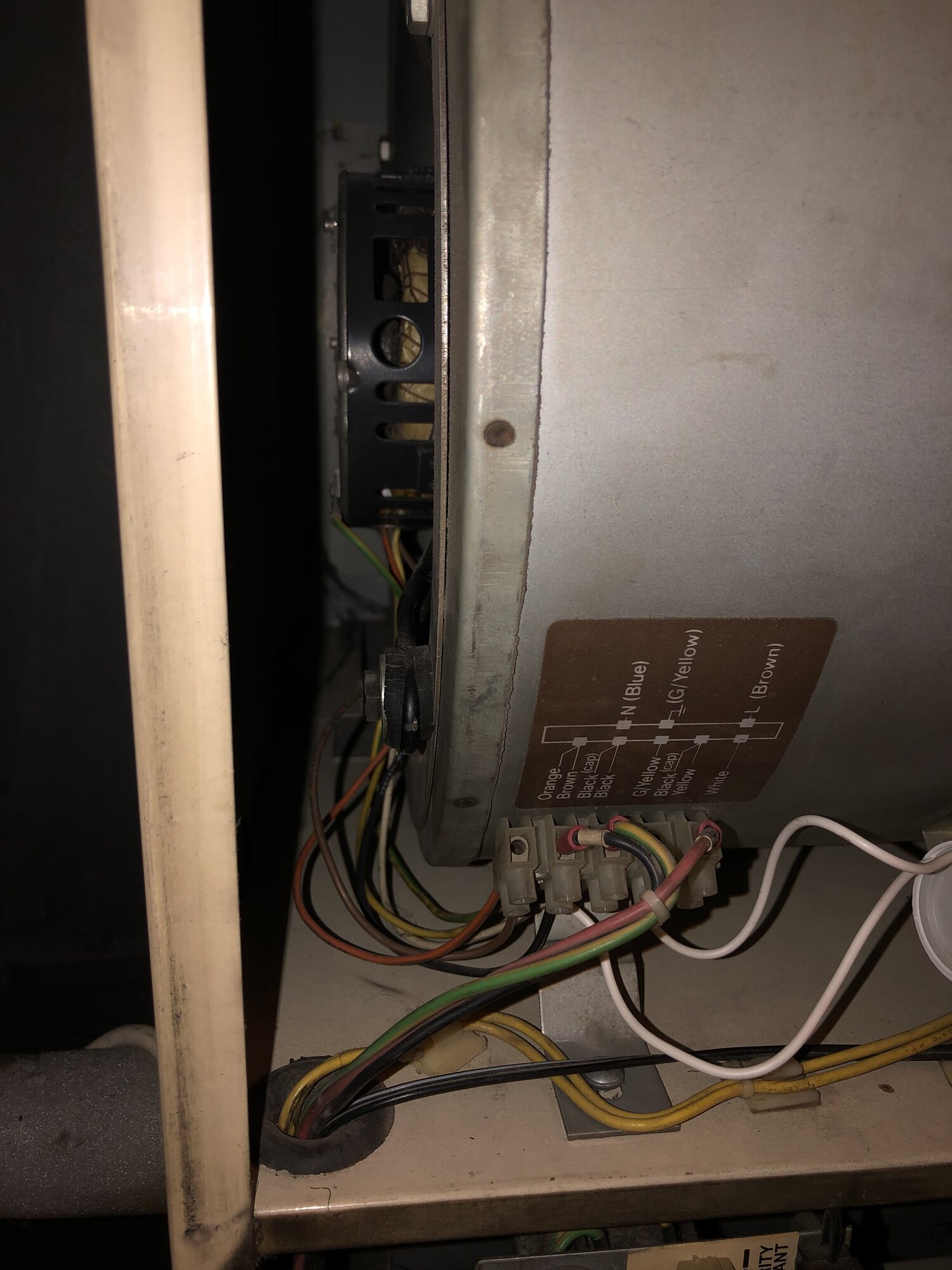

And here is a photo showing the wires to the fan
Does that show what you were asking? Happy to take other photos/closeups if I haven't captured what you wanted to see
No that is fine, some others had a plug that could be removed to service the fan, and these were prone to going faulty, you dont have one though.
Your unit is a modairflow, what that means is the fan has a variable speed, when the burner coes on the fan starts off after a short time, at a slow speed, then as the heat exchanger gets warmer the fan speeds up, once the thermistastat senses the room getting close to selected temp, then the fan slows down, this process continues all the time, sounds like your fan isnt modulating
