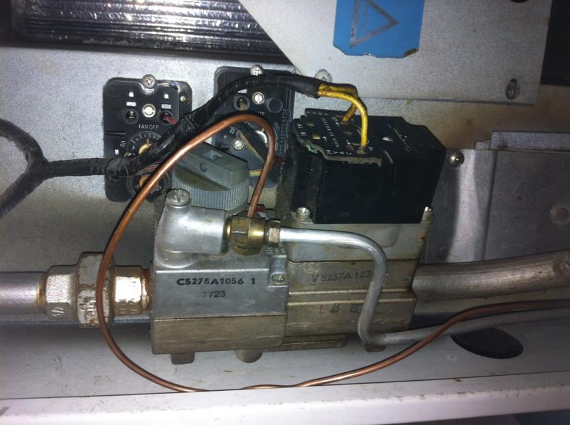

I have a JWD 25 Johnson & Starley warm air heating system in my 1 bedroom flat and I've just been told that the valve is no longer safe and I basically need a whole new boiler as you can't source the valves any more.

see if you can find the make and model of the gas valve that you need , someone on here might have one, if you cant find the info take a photo of it and post it,there is a good chance your WAU might have an asbestos flue in which case could be expensive to have a replacement installed

Do you know exactly why your gas valve has been designated as "unsafe" ?
only one valve i can think of on wau that are obsolete but they are around 40 year old.
As has been asked already ,photo will help as you maybe getting wool pulled over your eyes
First I would check the engineers badge to see if he his qualified to work on warm air. More than likely it will be an honeywell gasvalve which are readily available.

It's a Honeywell V8257A I think.
Think the plumber is genuine as he told me a year ago it was on it's last legs and he's done other decent work for me.
Have also been in touch with Johnson and Starley who confirm the valve is now unavailable :(

yep thats the obsolete one and has been since mid 80`s . All parts of the valve used to be avialable individually but not for many many years now
We (british gas) used to change them for a grey push button honeywell gas valve and use a pilot tube kit (aviable off shelf still) to make a new supply.
Some manufacturers now frown on appliances being altered like this but JS never did but then again its been around 20 years since i done my last one so there thoughts may have changed
Hi gas112,
Do you know what the grey Honeywell valve model was and what pilot tube kit would be required?
