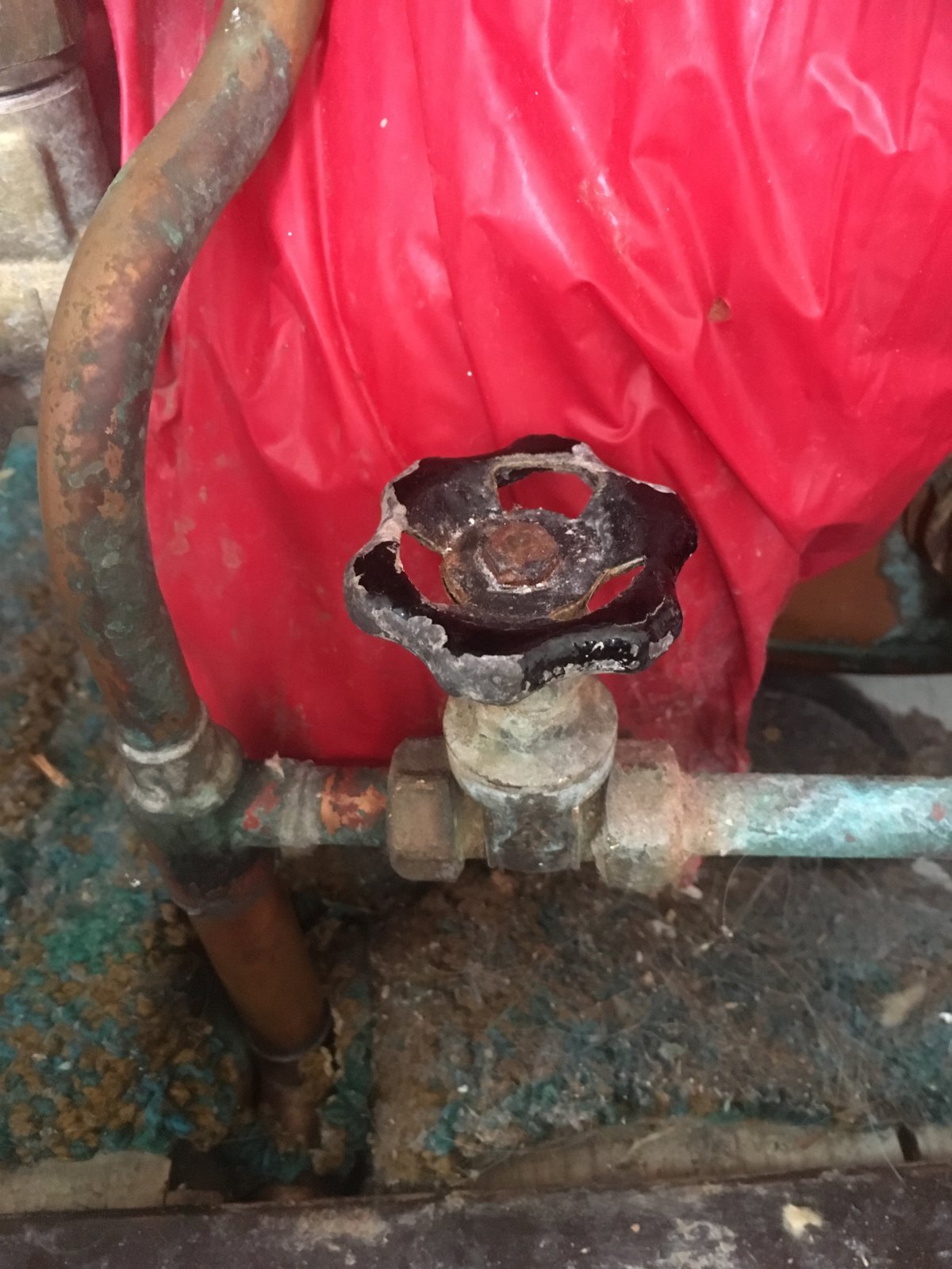

Would it have anything to do with this I noticed my grandad was fiddling about with this after for some reason
get the origional company back and refuse to pay any further charges need more pics of that valve to determine what it is
Is this the valve?

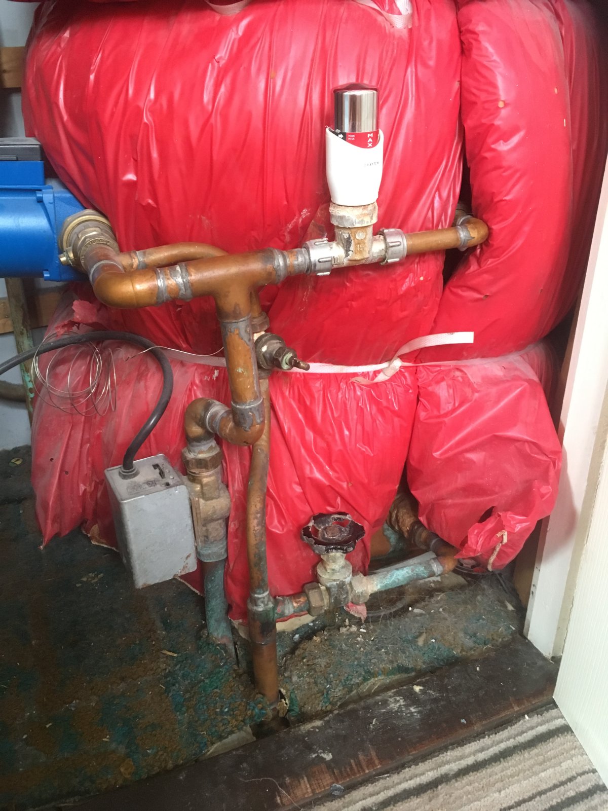

He's just got to bleed the high level air bleeds in the airing cupboard and your radiators, maybe force a little flow around the system....basic stuff. I can imagine he may not have done it on an emergency callout, merely made safe repair. He should have returned to bleed and check though.

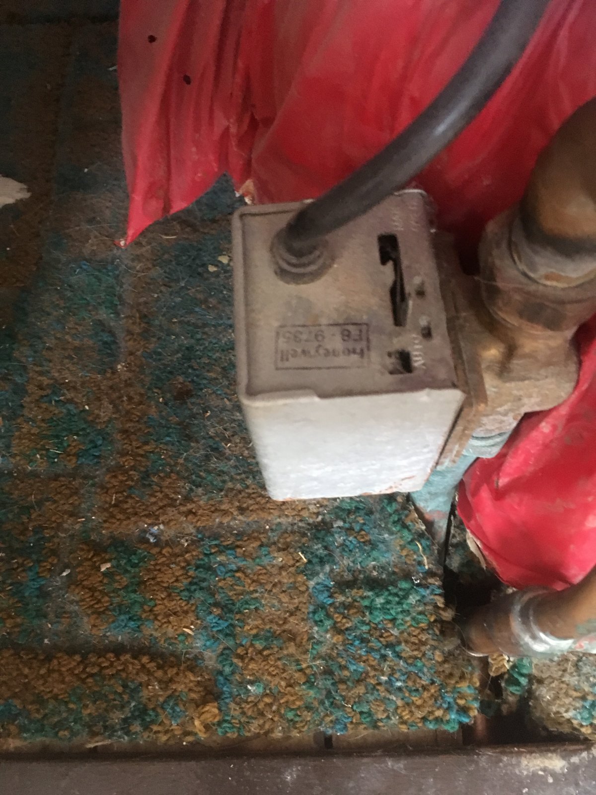

Post some more pics showing the cylinder and the pipes around it. I suspect, with regard to lack of hot water, there is air at the top of the coil.
