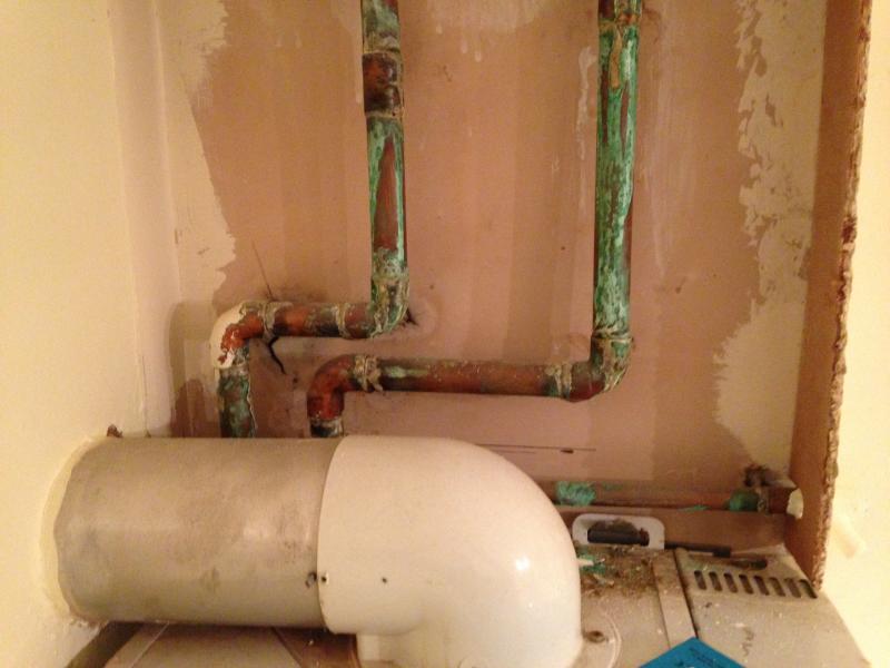

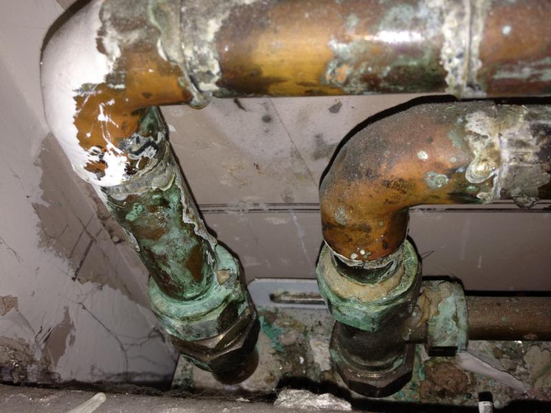

Flow pipe on that boiler is the left hand pipe coming out of the top of the boiler. Youre going to have to get into that boxing to check it. Or you could just make a small hole (just enough to get you fingers in to feel the pipes) and fill the hole when youre finished. As I said before, i strongly suspect that you will find they are reversed. So all that is needed is changing the pump direction. But you must check first.
OK, great. Well, I've broken into the box, which was only 3mm ply, so it just prised off, and there are, as you suggested, two pipes coming out of the boiler (see attached).
I am guessing that when I switch the central heating on, I am expecting the retrun (right hand side pipe as you look at the boiler) to heat up first, in which case, this is the flow and the pump simply needs to be installed the other way round?
Thanks again for your help. This really is a great forum.
Ash
OK, I've switched on the CH & HW, and within a second or two the right hand pipe was warm to the touch, and the left hand pipe (as you look at the boiler) was cool and getting cooler.
After a while, the left hand pipe started to get warm.
I've found the on line installation instructions for this boiler, which again, re-confirm what everyone has said:
1) The pump should flow towards valve
2) The left hand pipe is the flow, and therefore, my logic is that this should get warm first
I am convinced, based on everyone's comments (especially TCCHeating) that the pump has simply been installed in the wrong direction.
Just before I start to drain the system and reverse the pump, I am hoping that you could confirm that I am reading this right and that swapping the pump direction is he right thing to do?
Thanks again,
Ash
Yes. Swap the pump direction and all should work correctly. Classic case of engineer brain freeze! Changing a pump should be simple but youd be surprised how many get replaced the wrong way round. I've even seen it when the pump was changed by a british gas engineer! Pretty unforgiveable.
Whilst youre at it. Clean all those green bits around the joints on the pipework with some wire wool. That is flux residue eating into the copper and could cause problems in the long term.
