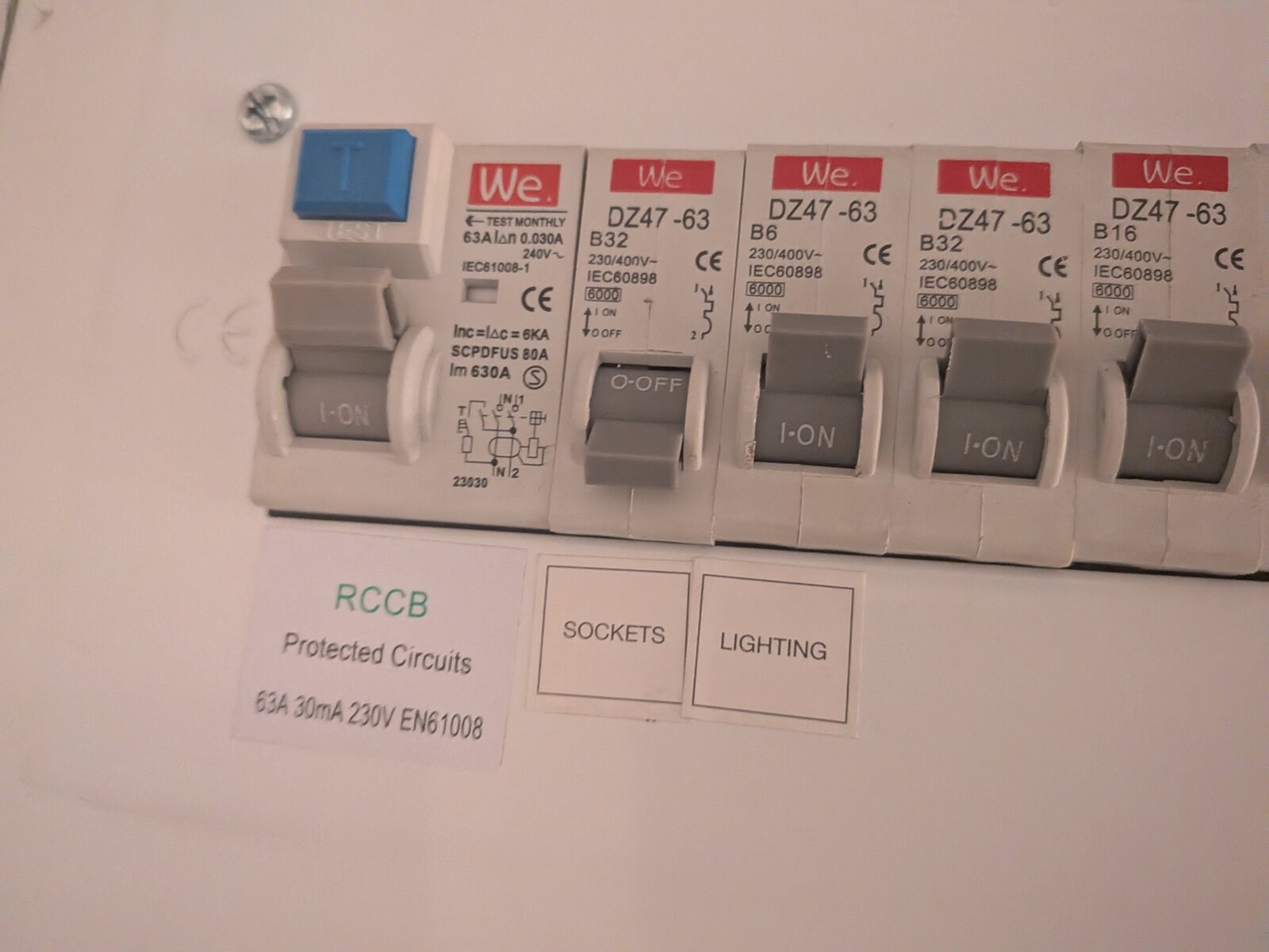

The circuit has a 32A MCB connection - so maybe a ring main with 2.5mm cable - if a radial - which I dont think was common many years ago , then a thicker wire proabbly 4mm - BUT there are all sorts of regulation regarding length of run - one of the experianced sparkies here will advice
if it provides other sockets in the ground floor , then i would expect it to be a ring and maybe they have done something else in the kitchen
Is there any way I can easily tell it is Radial?
if it SHOULD be a radial or happened to have been wired as a radial
May mean taking the front off the consumer unit and looking how many RED wired come out the top of the 32MCB - BUT not advisable as even when OFF there are live components in the consumer unit - i think its a ring based on your last post and cable going to other room from kitchen, so no real need to get anywhere near the CU YET - can be very dangerous - lots of things stil to do

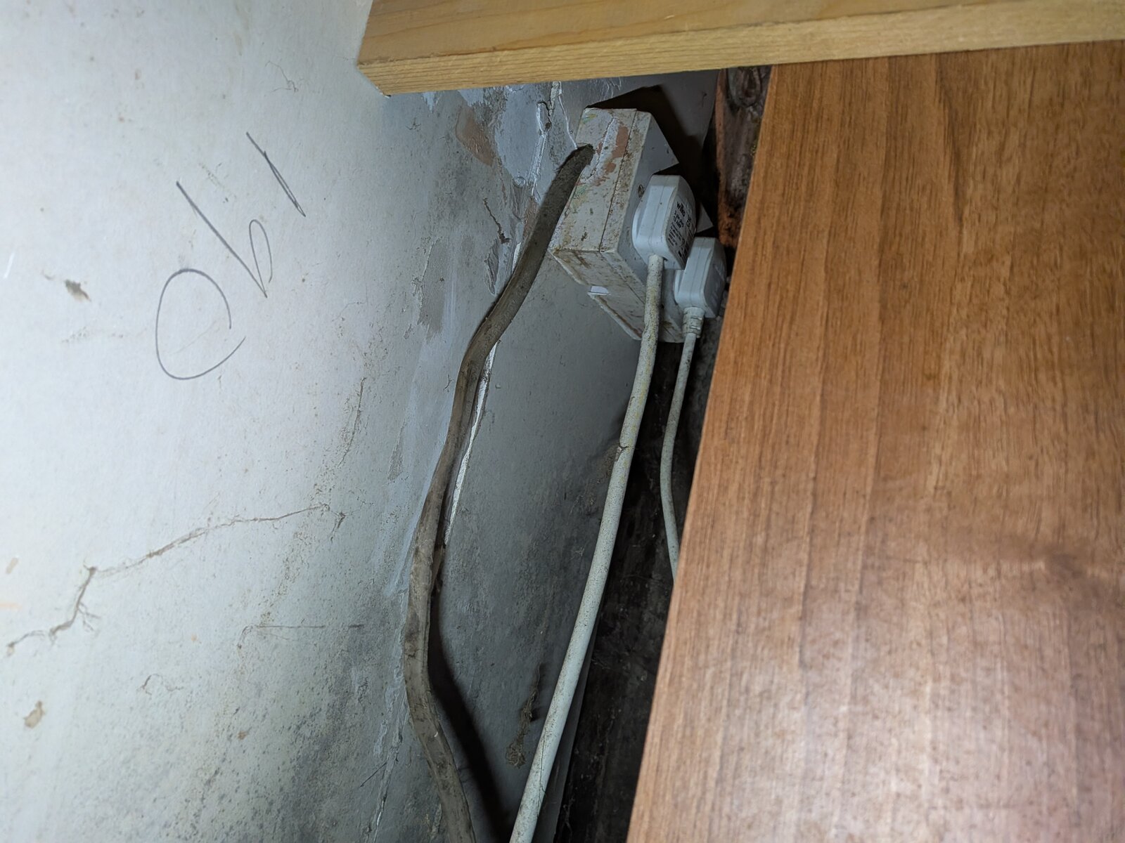

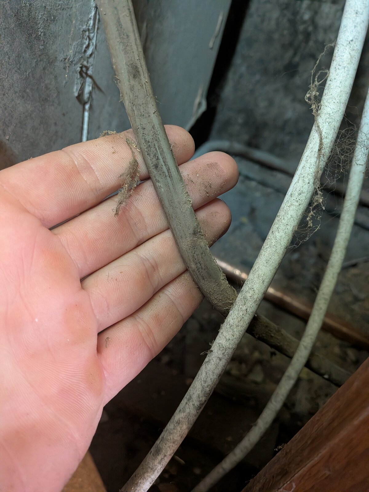

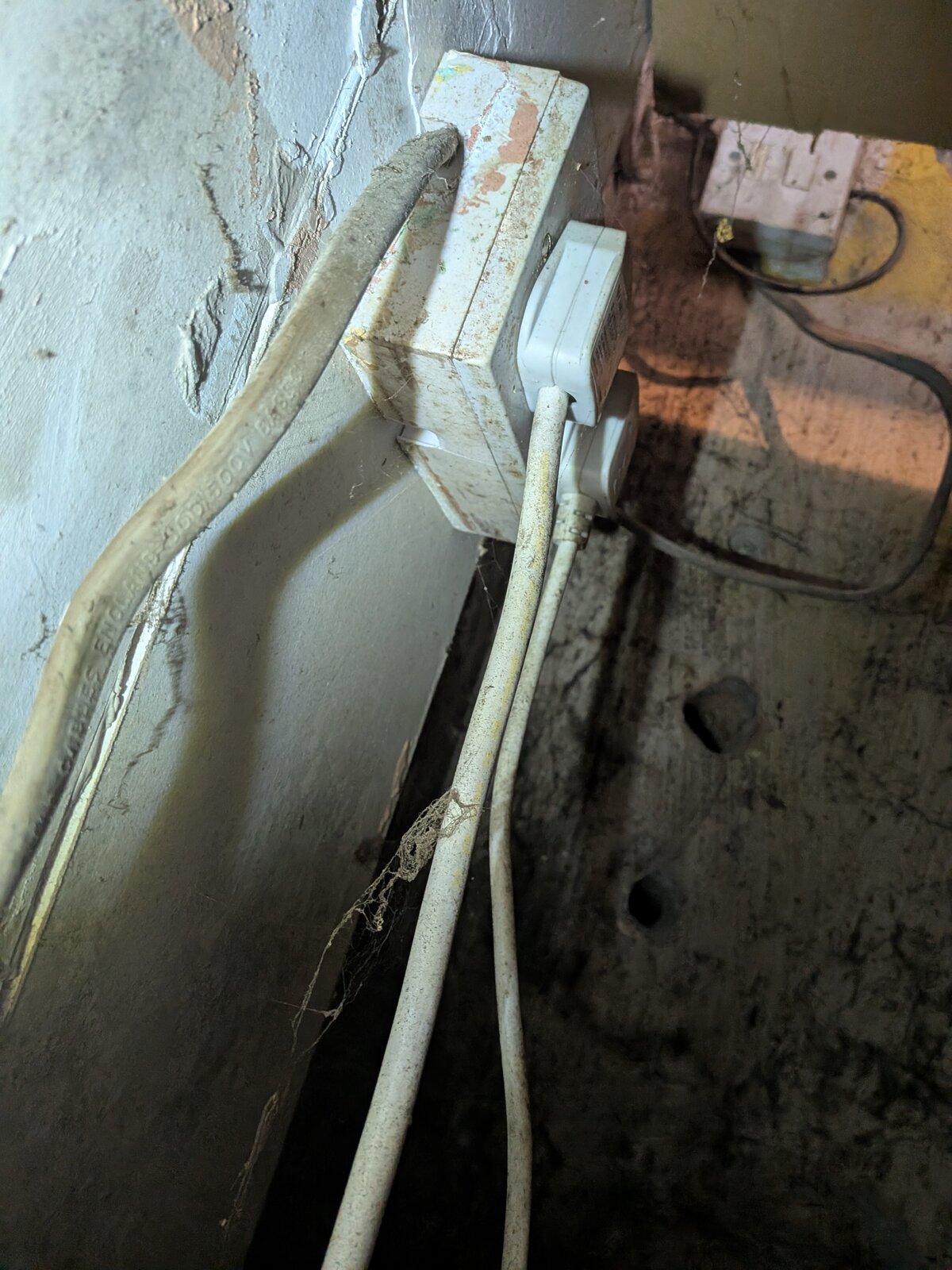

This is the last green socket location, the wire I have on my hand is the one that goes directly to the first of the red/not working sockets.
As you can see it will be a bit of a nightmare taking the cover plate off.
If have to start taking the kitchen unit apart. It's doable but rather not be the first thing I check.

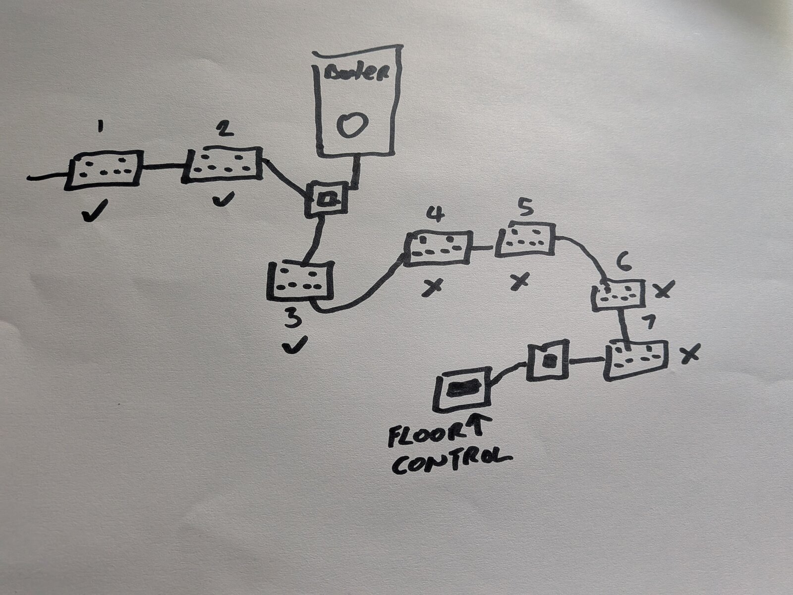

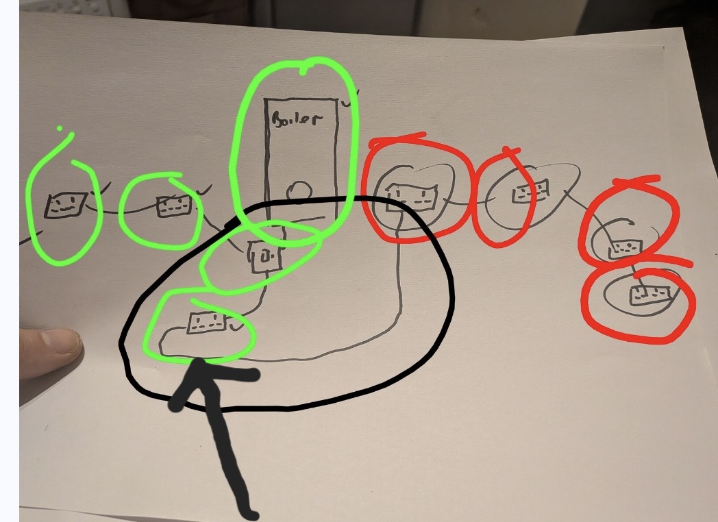

1. Socket 4 is where the toaster was plugged into. Sockets 4,5,6,7 immediately stopped working when I got a shock from the toaster.
Sockets 1,2,3 all working fine (including the boiler)
(I'm fairly certain how this is wired but can't be 100% sure as cables behind walls and hidden sockets can't trace them ).
2. When everything is switch on at the consumer unit ALL sockets work in the house apart from sockets 4,5,6,7.
3. When I turn this off it cuts power to all sockets in the house apart from 1 socket in a downstairs room that's far away from the kitchen
Another switch labeled sockets control that single socket

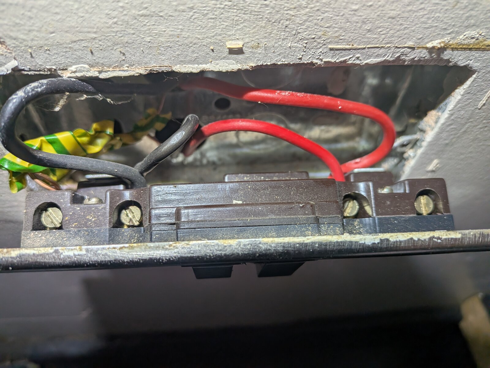

Socket (3) the last working socket in the run.
Access really difficult, can't check wiring properly without taking apart the kitchen.
Socket (4) what the toaster was plugged into.
Doesn't appear to be loose cables or damage. But may have missed something.
