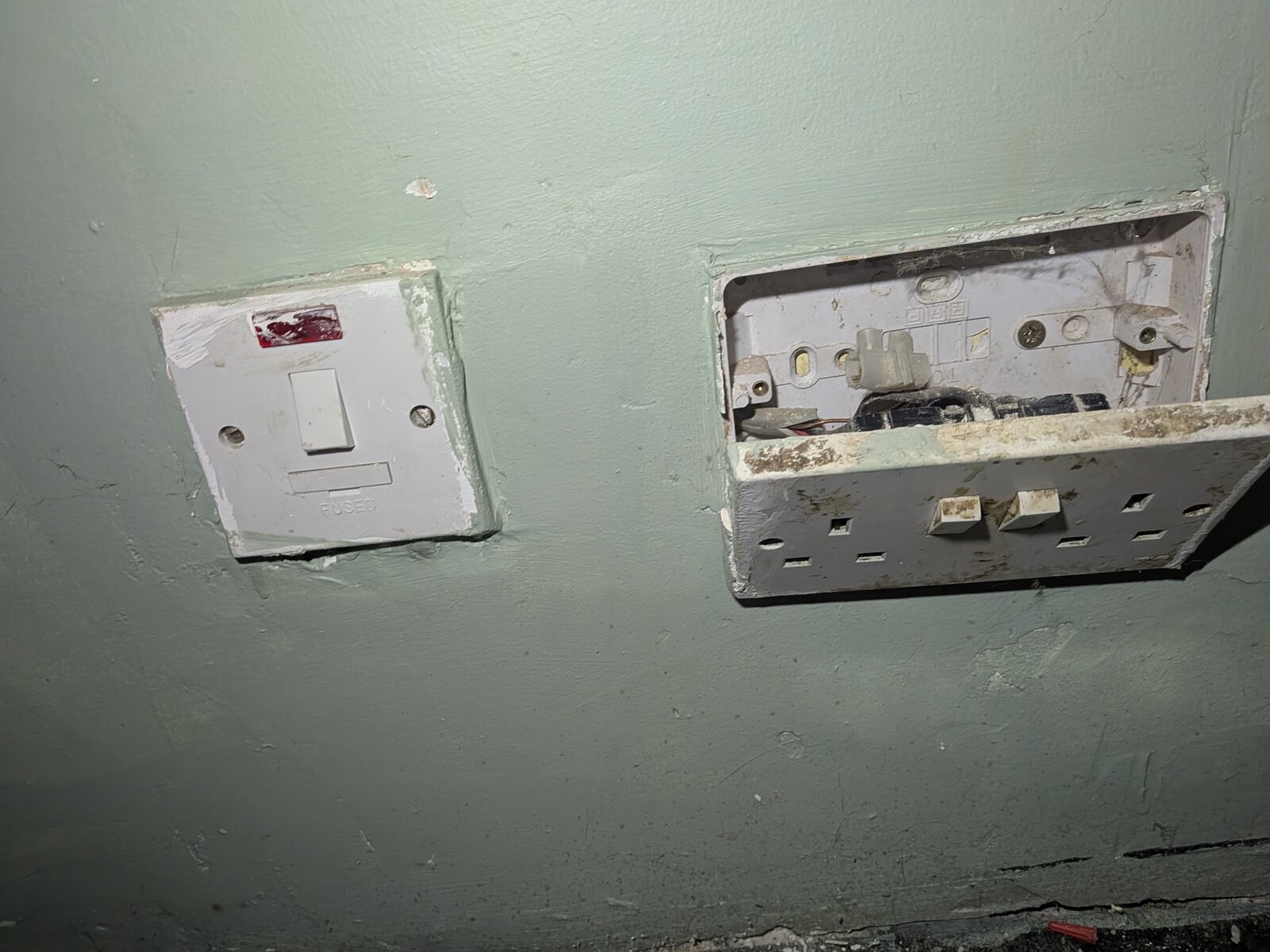

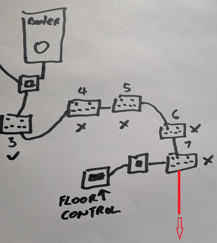

1. Socket (7) this socket i assume is the final socket (the one located in the other room).
2. A single wire comes out the socket and goes left towards the fused connector that consoles the heated floor.
3. Two wires also go out the back of the socket towards the kitchen.

sounds like lose wires - BUT it would need to be 2 lose wires if on a ringmain as it looks like from pictures
or the screw is on insulation and a wobble disconnected / connected maybe
maybe the screws need a tighten on the sockets - and insulated screwdriver would be good to do that with

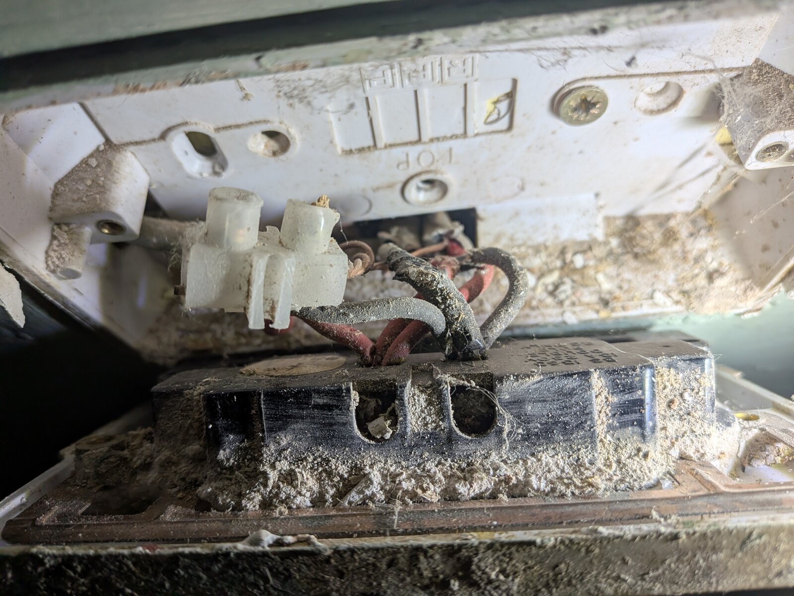

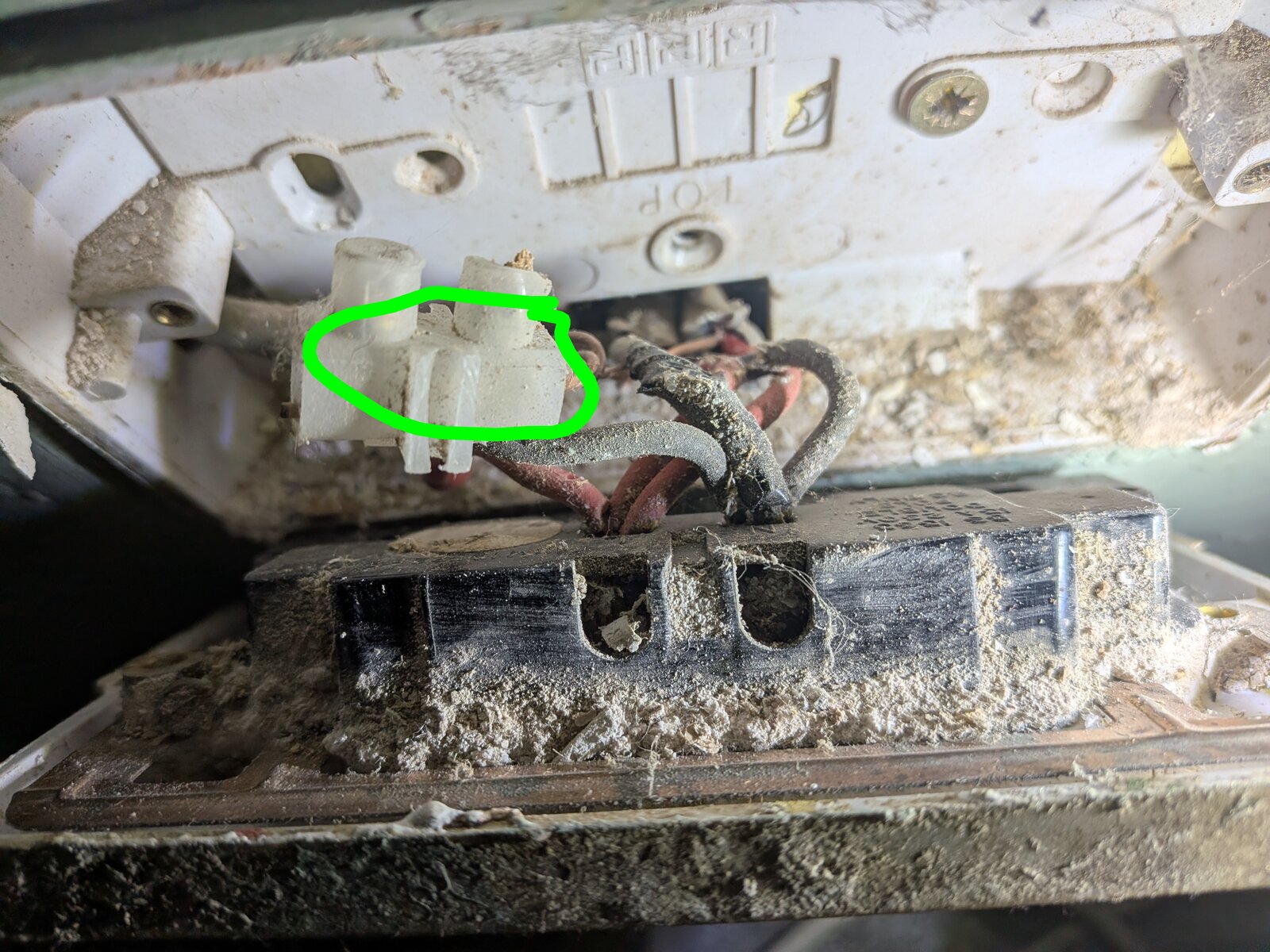

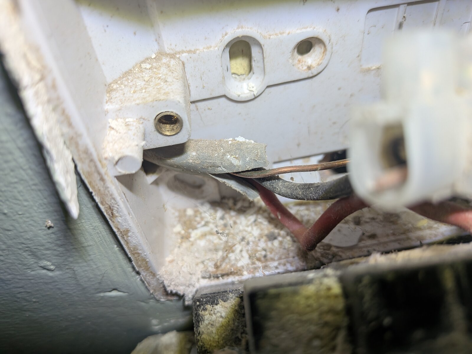

None of those photos, fill me with any confidence in that installation - basically, it looks like a really amateur botched job. I also spotted that lack of an earth to the socket, and was in the process of pointing it out, only to then read that it had been already noted. You should not use that socket, for anything, until it has been rectified.
I agree with H. It looks like a builder or amateur has done the work.
I would like to see every connection checked or re-terminated, earth sleeving and grommets fitted, and also the consumer unit should be checked for ALL secure connections too.
and the ring may be disconnected somewhere else as a loose connection in the toaster plug should not have taken out the other sockets - see the link i gave for a ring main its powered both ways
my daughters had this issue and they could not find where the ring was broken . i think it was just the earth - and suspected a junction under the floor after a lot of testing - so split to 2 mcbs
so that should also be tested
