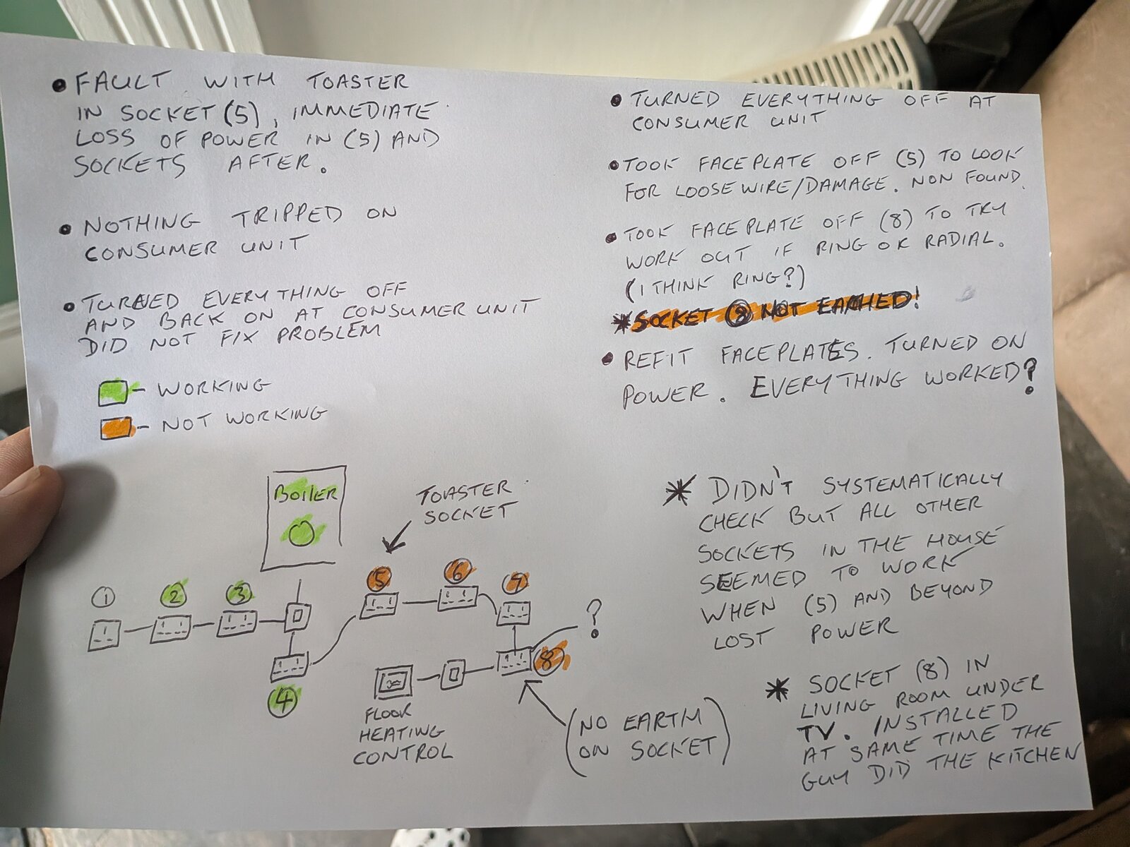

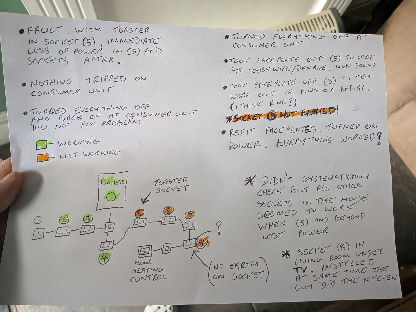

My knowledge is really limited.
1. Yeah I don't really understand how the toaster socket and all the sockets to the right of it went down at exactly the same time as the shock incident, if it was a ring.
So if it was a ring wouldn't there need to be two faults at the same time for this to happen?
For example....
Say A fault at the end socket (7) or slightly after that's been undetected for god knows how long.
AND a fault that occurred Friday night at the toaster socket (perhaps a loose wire , which remade connection when I took the cover plate off to look and re installed it).
If this were true. How would you go about detecting the undetected fault?
Also why wasn't the consumer unit tripped by the toaster socket incident or by the hypothesised fault around socket (7)
(I don't intend to try myself because it above abilities/ knowledge but I'm really curious to understand at this point. )
2. If there was a problem at the consumer wouldn't wouldn't it effect all the sockets on that ring (as in they all wouldn't work)?
3. Also I don't know for certain socket 7 is the end. Logically it would make sense for it to be.
But it's not out of the realms of possibility for some reason the wires doubles back, And finish on a different socket? Again very limited knowledge on my part.

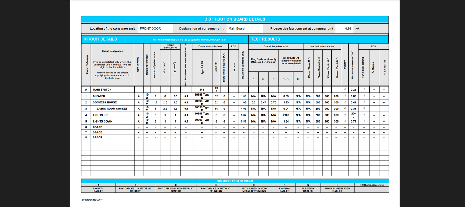

This is back from 2017 where the house was looked at. It was deemed unsatisfactory, then a load of work was carried out to rectify all the faults.
Can't find any paperwork after the rectification was carried out but I'm sure I'll have it somewhere. Possibly a paper copy.
The rectification work that was carried out in 2017 was the last time the house electrics were touched

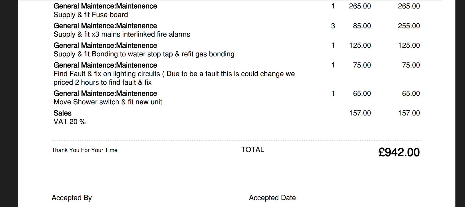

The sockets near the cooker weren't done. I'm assuming because c3.
This is what was carried out in 2017 to fix everything they found

My advice is - to make sure it is a genuine, properly qualified electrician. From what I've seen in those photos, none of the people who, the installation work, or did any later checking, was qualified to do the work. Even you guy who charged you in 2017, hasn't been very thorough.
Is item ten relevant as an observation on an EICR? Whether or not smoke detectors are present or not it is not a BS7671 issue.
If it is present and the wiring is defect then it is a BS7671 issue.
* Edit. I Understand now
The builder did the kitchen. So I'm not super surprised there but the company that came out and did the checks in 2017 were.
So legit and qualified as far as I'm aware
Just quickly wrote all this down to help me explain what happened to whoever comes out.
I'll also give him a printed copy of the EICR and what the guys did in 2017.
Anything else relevant or useful I could tell or give to whoever comes out to look at it ?

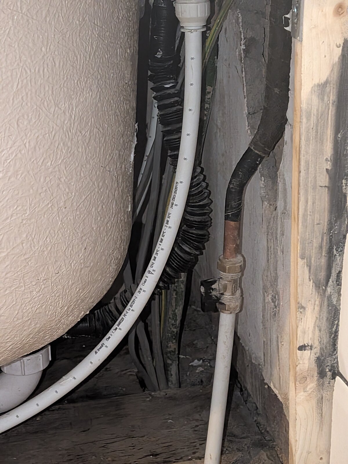

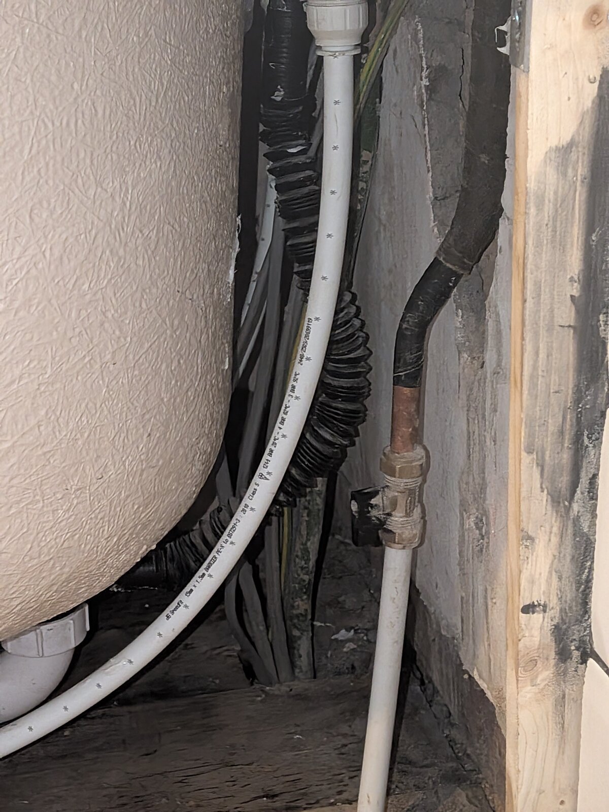

On another note. Bathroom is right above the kitchen.
Bath had a leaky dripping tap connection about a month ago, it's fixed but bath panels are still off.
I noticed a load of cables running behind the bath is this a huge issue or an acceptable way to lay cables?
Nice to see the copper pipe on the right is wrapped before being buried in the plaster.

Okay so the electrician his just quickly came out.
Did some tests , confirmed there is a break in the loop somewhere. Is coming back to try find the break, if not he said he will convert it into two radial circuits.
God knows how long there has been a break in the loop. I'm guessing I could have had a break for years and not been detected?
