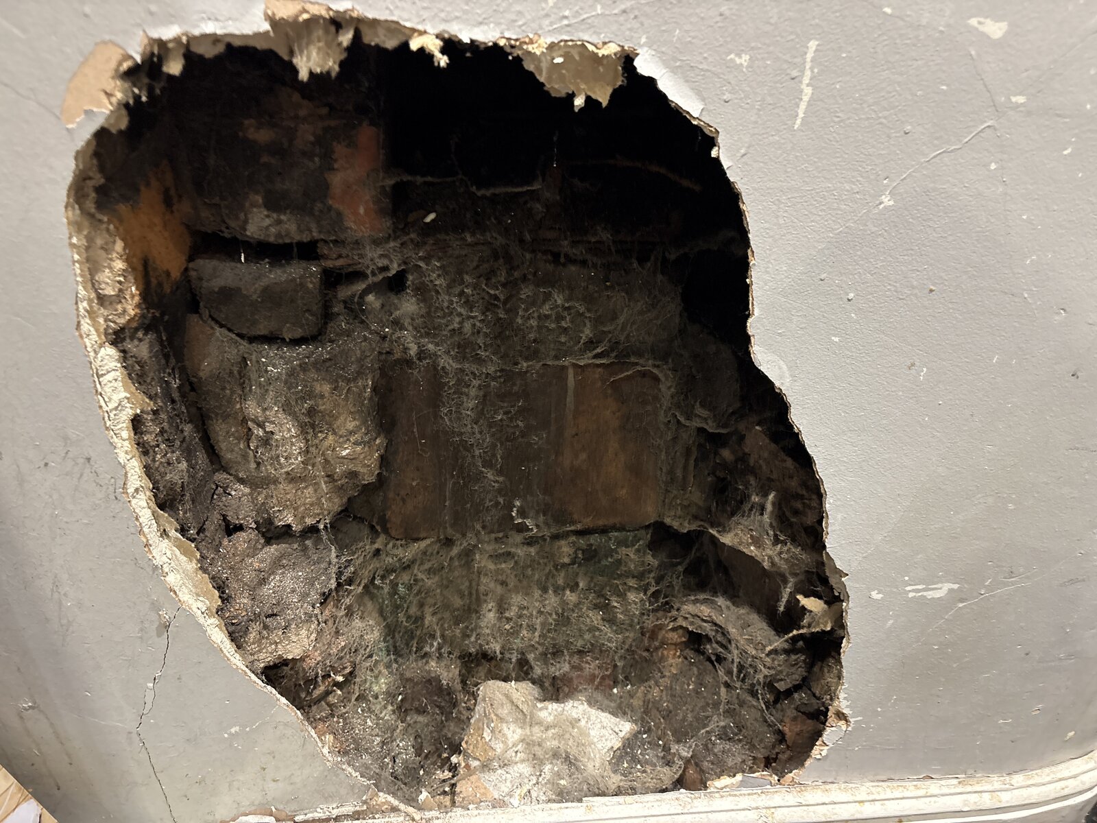

I can't see exactly but i would be looking at blocks, board and fill.
Hand saw and cut thermalite blocks.
Ready mixed sand and cement.
Do the best you can but get the blocks in.
Plasterboard over with dot and dab.
Fill and make good.
Paint.
