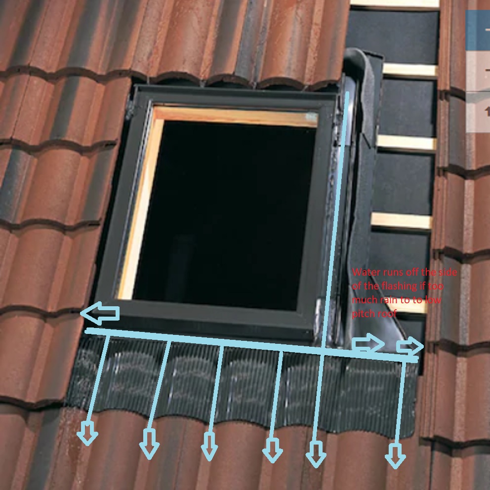

I took the opportunity earlier today before Christmas lunch to lift off a number of tiles to have another look.
I noticed that due to the low pitch of the roof, heavy rain water builds up a little at the bottom flashing piece (just above the corrugated apron), and some of the water is diverted horizontally and off the corners of the flashing onto the membrane underneath (see pic 1).
Matters are made worse as the foam gasket that goes along the side has disintergrated in some places and there doesn't seem to be any foam on the sides on the bottom flashing.
So what i'm going to do is make my own modification to the flashing.
I'm going to purchase some replacement foam strips & when the weather is dry, i'm going replace the foam gasket all around and extend the foam strips further down the corrugated apron and add another foam strip barrier that is going to be covered by the tile in the corners (see the the yellow lines in the 2nd pic).
This should hopefully minimise the run off water that's running off on to the membrane!

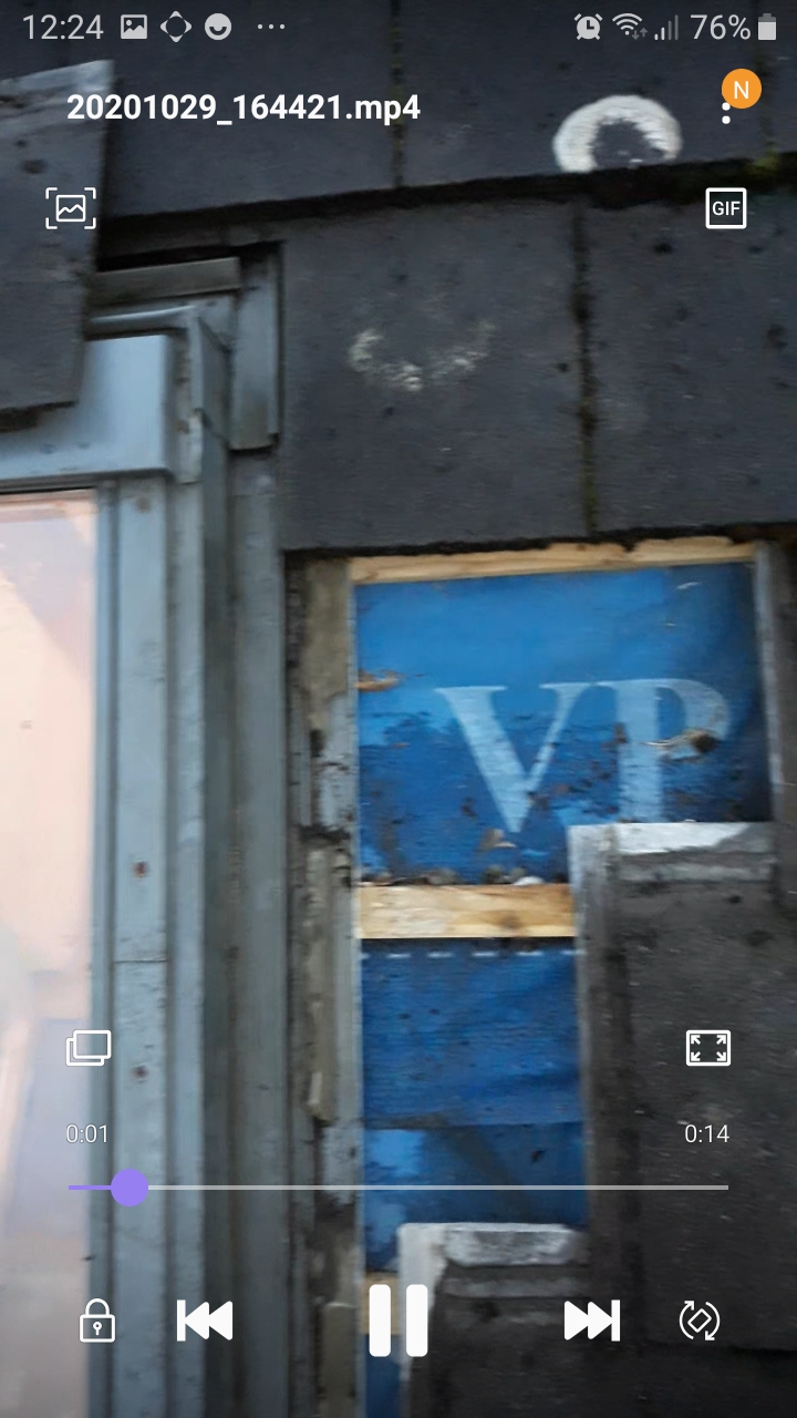

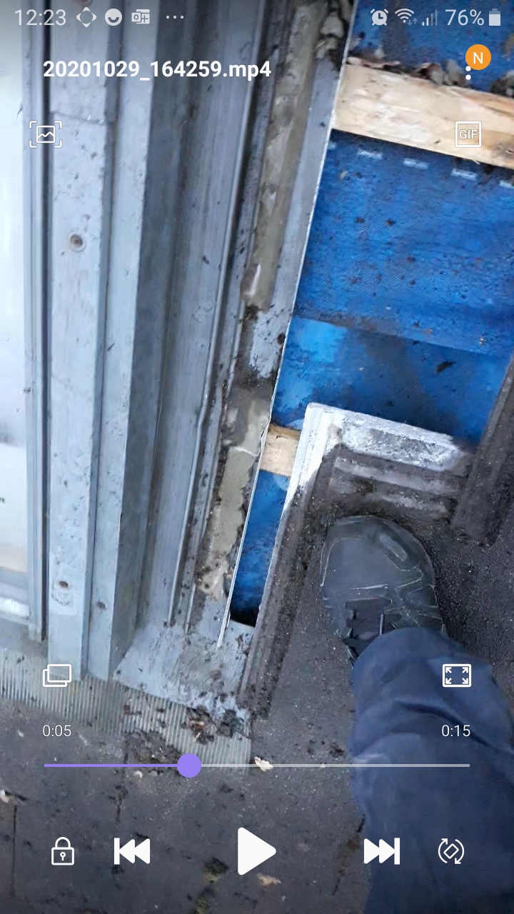

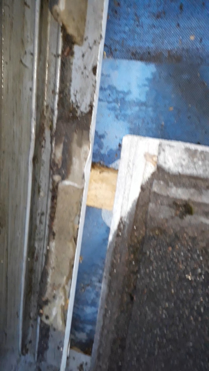

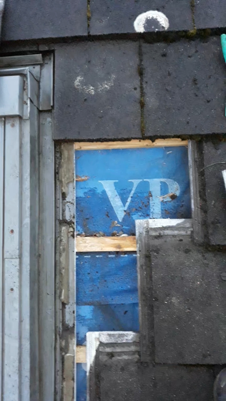

I also have this problem. The foam had disintegrated allowing water (and debris, leaves, twigs etc) to get in under the tiles onto the membrane. I replaced the foam with strips of foam padding that i had, spray glued onto the channel. I'm going to wait for a few weeks to see if it works.

I had a builder friend who told me he's had loads on issues with the foam rubber disintegrating. He said the smaller gulley was allowing rain water to flow across it into onto the roof side. The foam in my case had become detached and done little to keep the rain out. So having dealt with this issue on a number of occasions my builder removed the useless bit of foam and cemented inside the second gulley (like you would a verge at the end on a roof). This stopped the rain. I did buy a replacement foam rubber but didn't insert it as I thought it was an inherent flaw with Velux design.
I cut strips of seating foam and spray glued it on and it has worked for the last 2 months, even in some torrential rain and high winds. It has stopped the leaking. I'm going to get the proper stuff (linked by Steve above) and replace it with that.
