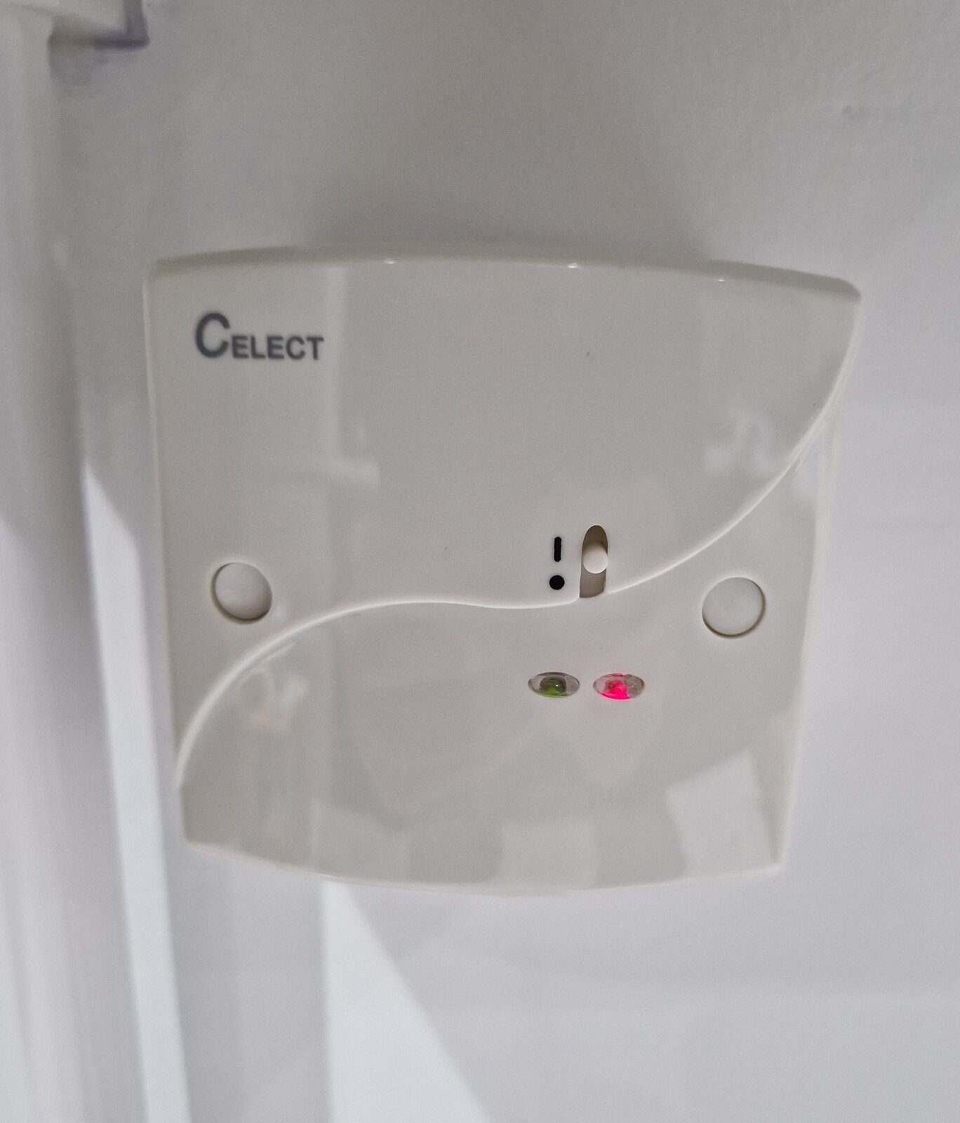

I purchased a HIVE mini thermostat that does heating and hot water for a conventional boiler plus separate hot water tank.
I was going to get it installed by British gas but they say they unable to do it as they are very busy.

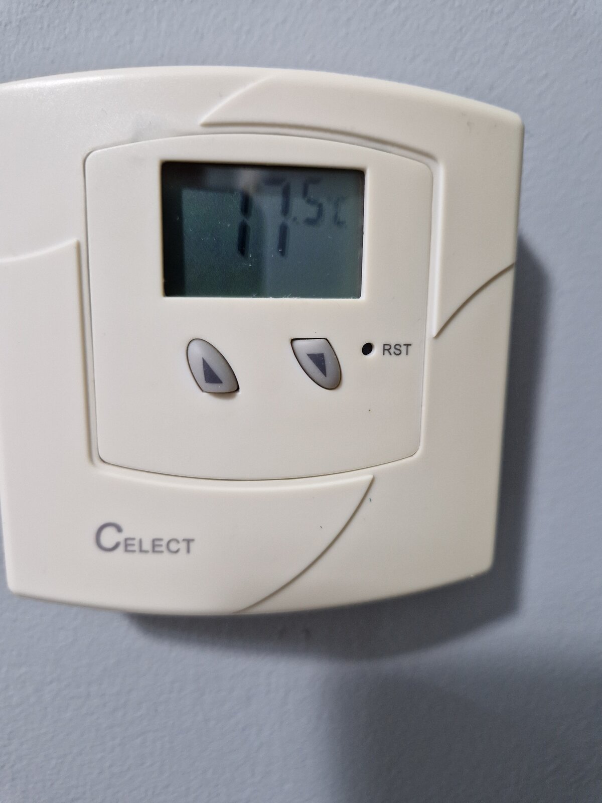

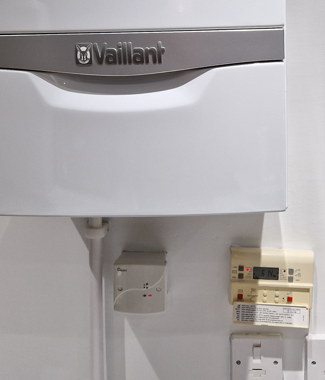

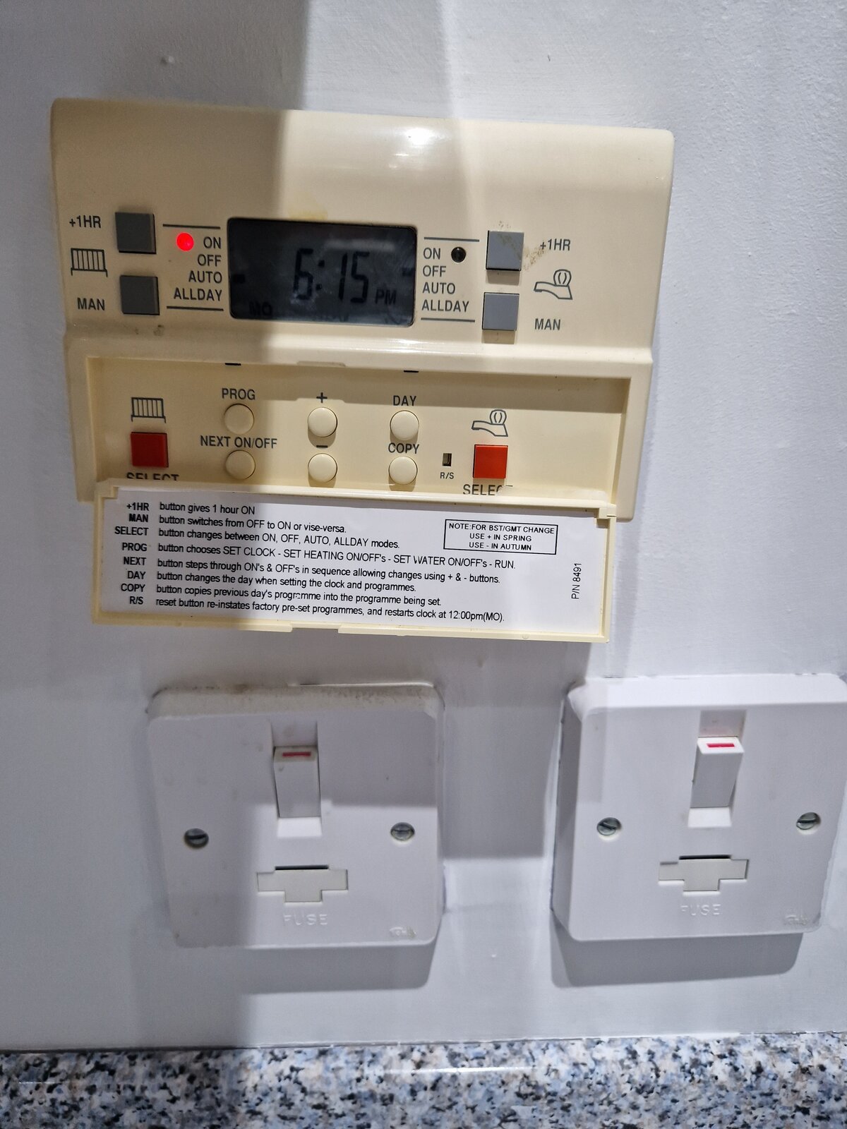

The current set up I have is a Valient conventional boiler witch is connected to a danfoss programmer and also I have a Celect wireless thermostat connected. I actually fitted the Celect thermostat myself about 7 years ago with the help of this forum, I replaced a wired stat.

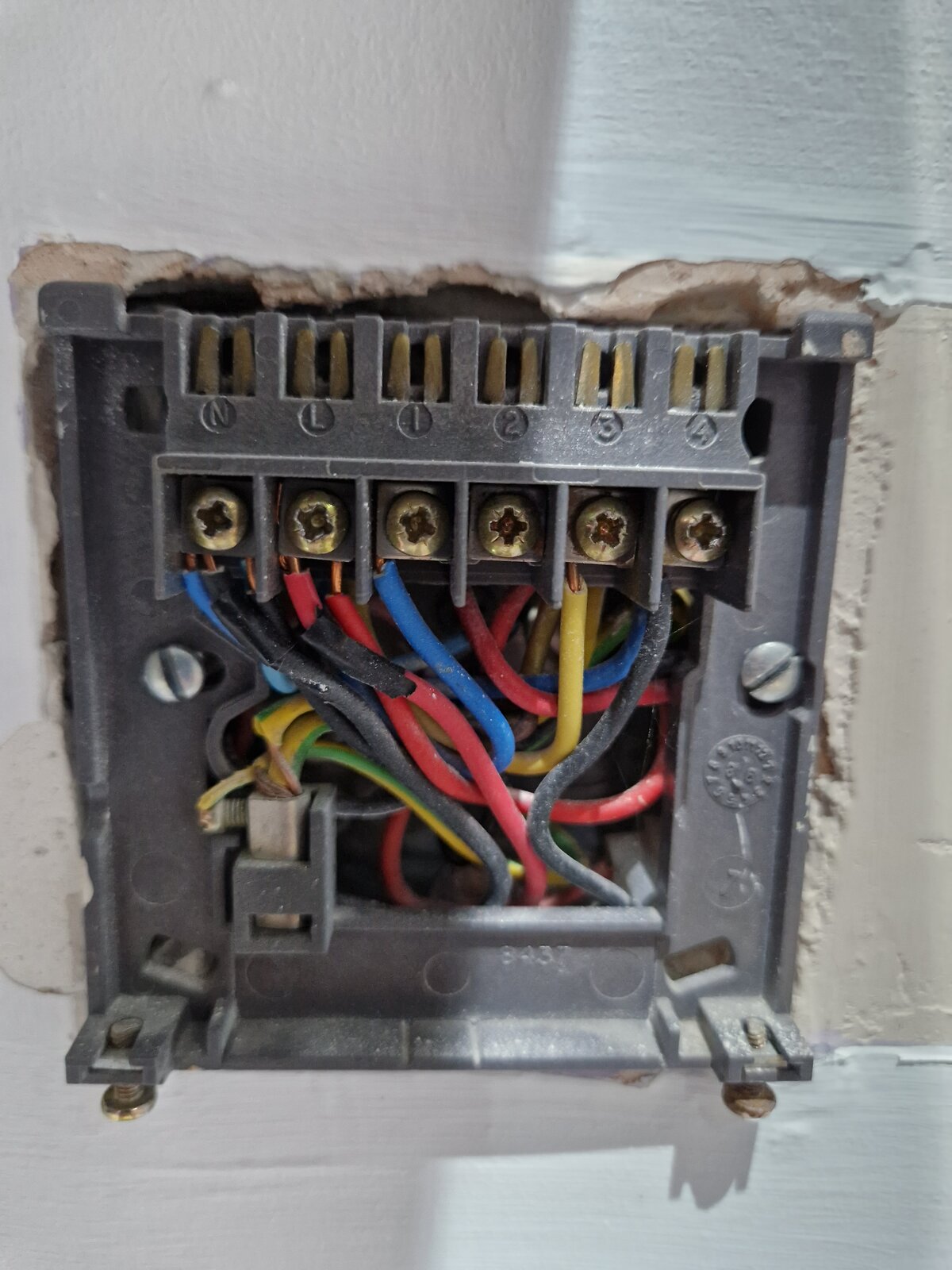

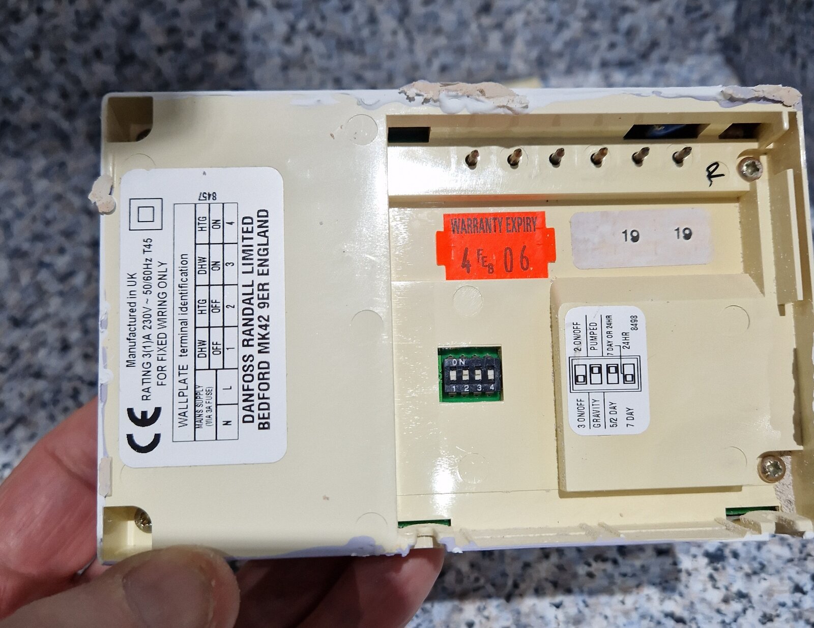

It was so long ago I have forgot most of what I did. I know the 2 wires in the programmer back plate that have black tape on going to N and L go to the wireless receiver. R2 on wireless receiver has a black wire that goes to 4 on programmer back plate and R1 in wireless is connected to a red wire that originally came out of 4 on programmer back plate (when it had a wired stat fitted)
I did make notes when I did this 7 years ago, but I have had a lot of sleep since then. I hope my description makes since to someone.
I'm going to try and fit the new hive thermostat myself, wanted to know if it might be within my capabilities.
I have attached photos of my current set up and would appreciate any advice before I start to disconnet the heating programmer just incase I do something wrong and lose my heating while it's cold.
Is it just the case of changing a couple of wires over, or im i being nieve?
Will the new hive receiver go in place of current Celect receiver or will it replace the danfoss programmer?
