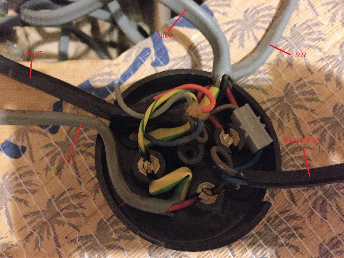

The existing room stat will need to be bypassed so the Hive can take over as heating thermostat. Can you post a picture showing where the CM907 wiring is interconnected with the pump cable.

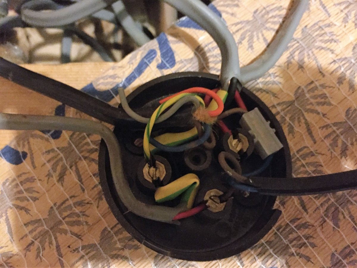

Dodgy connection under the upstairs landing is where the CM907 is connected - see attached picture. The black power cable on the left has 2 wires going to the CM907. The other black is going to the valve and the rest I would need to trace.
Hope it helps.
Hard to make out the thermostat connections in the photos.
If there are only two wires in that cable to the thermostat they can simply be removed and replaced by a wire link across the two terminals they were connected to. The disconnected cable from the thermostat shouldn't then be carrying any high voltages but cover it up safely and maybe label it as a possible future backup.
Yes there are only 2 wires to the thermostat
"CH ON(2) in Danfoss moves across to 4 in the Hive. ( Why are 2 cables connected here? )" Not sure why there are 2 wires here but both are from the wall which go upstairs to the pump/valve?
No problem, I'm just curious because normally the wire from 2 in the Danfoss would head off towards the room thermostat. Move the two wires across together and the system should work as before, but under hive control.

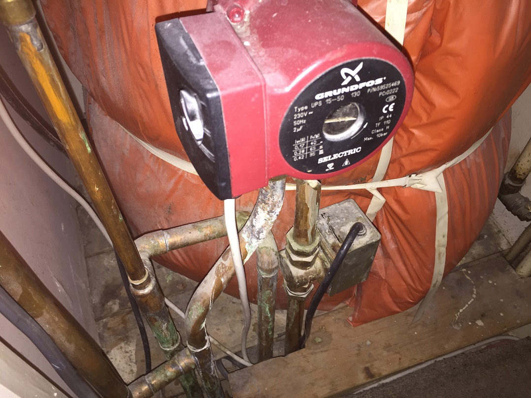

There is a motorised valve and the pump comes on in water only mode. I can hear the valve closing when the CH goes off. All seems to be ok now
Looks like yours might be a bit of a hybrid. Fully pumped, but only with a motorised valve to control the central heating. This is usually (but not always) found in bungalows or flats because there isn't sufficient height for the gravity circulation, or if the pipes between the cylinder and boiler would have to follow a torturous route.
In this case:
1) Selecting 'Hot Water On' will switch the boiler and pump 'on' it will heat up and hot water will be pumped to the hot water cylinder.
2) Selecting 'Heating On' will open the motorised valve so hot water will now circulate around the radiators. The hot water still needs to be on operate the boiler and pump.
