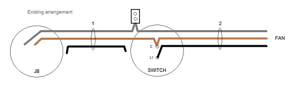

Hi,
I need some assistance in the wiring for a new extractor pull switch
Current wiring:
One black goes to L1, the other is cut and not used.
Both brown to common
Both grey into one connector

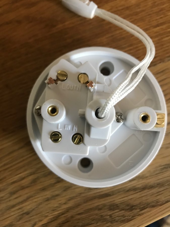

I want to fit a new pull switch with neon, but not sure how to wire:
Appreciate any assistance.
Many thanks, Mark
You can connect the wires the same as the old switch using Lin and Lout on the new.
Can't tell which way round from here. You will need to determine which is Line(live) and which is switched live.
You will not be able to have the neon working unless you can connect the unused black to Neutral at its other end.
So Line Live is the cable with the unused black - right cable in the pic
The switched the cable with the used black - left cable in the pic
Looking at the wires in the loft, the Line live - Brown obviously live and grey neutral

2 Browns - Lin
1 Black - Lout
NB - 2 Greys - Nin because the fan will need neutral when the switch is off

Photo #3 is a JB in the loft which contains the supply and further cables.
A Brown/Black/Grey cable1 has Brown connected to Line and Grey to Neutral with Black cut.
This cable1 goes to the Switch in photo #1 where it is connected to another B/B/G cable2 which (presumably/obviously) goes to the fan and perhaps light although that may be separate.
The 2 Greys are in the connector block (I first thought this was the spare black causing my confusion).
The 2 Browns are in switch Com
The 1 Black from cable2 in L1 is switched live

Spot on.
So to confirm:
2 Browns - Lin
1 Black - Lout
2 Greys - Nin
Nothing on Nout
leave the cut black as is, unused.
