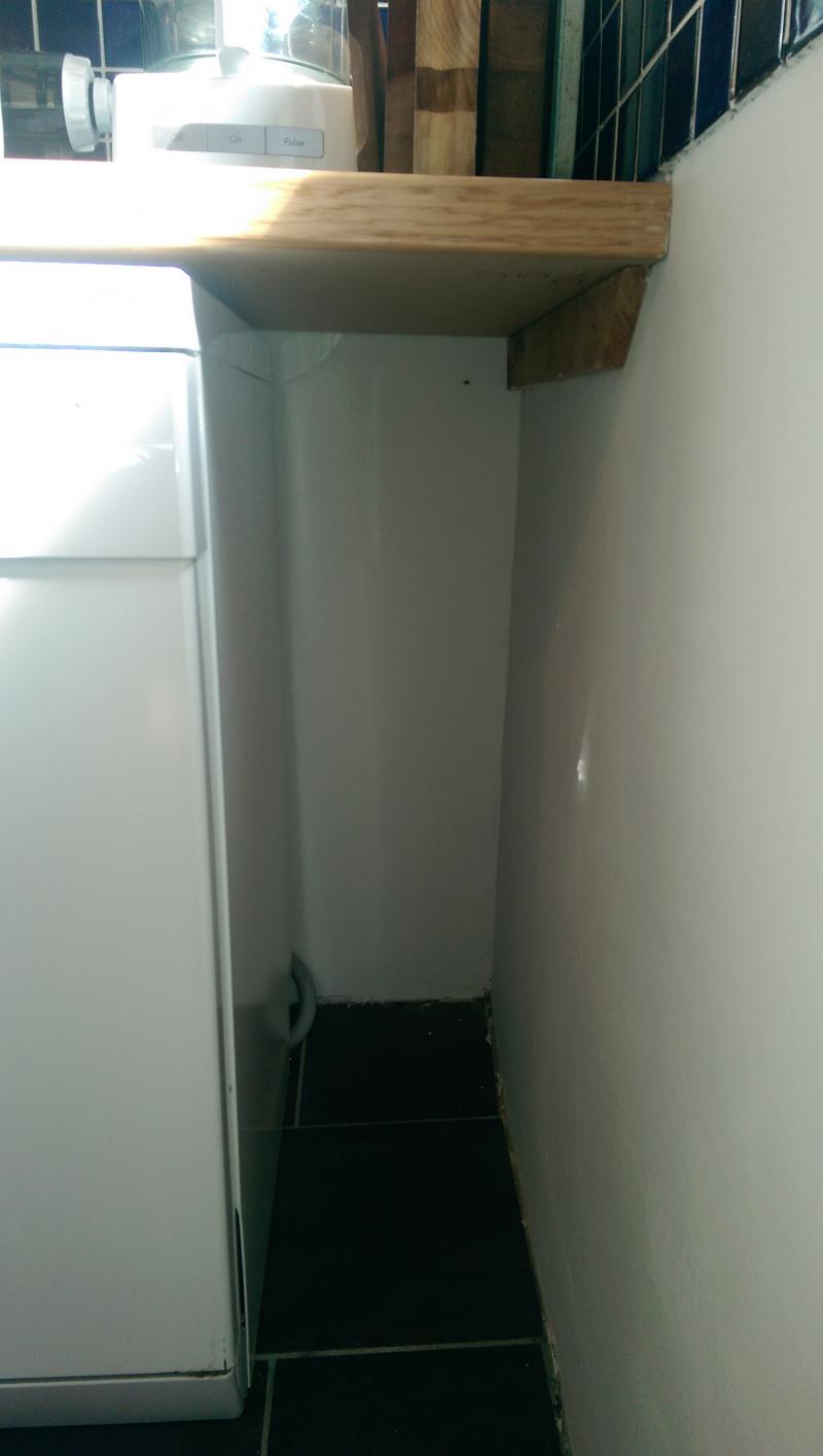

I'd like to build 4 shelves in the space between the dishwasher and wall as show in the photo below.
The shelves will then hold some wicker baskets.
I'm a complete amateur when it comes to things like this so would appreciate some advice on the best way of fixing the shelves. I could screw batons to the wall to hold the shelves but not sure what to do on the dishwasher side. Any ideas? Any advice on the best wood to use for the shelves.
i would make a unit to slide in as you dont have enough room to drill into the wall and cabinet
i would make it from white faced board or 12mm board
I would agree just make a free standing unit.
But if space is tight, and the weight in the baskets is not to heavy, you could screw battens to the wall side and back only, and then physically attach the shelf to the battens, so that the corner floats.

I did try looking to buy a unit but couldn't find anything narrow enough (28cm). Any one have any recommendations on where I could purchase something like this?
I'm attracted to the idea of using batons at the side and back only as I don't think we'll be storing anything too heavy in there. What do you think the maximum recommended weight would be? We'd probably look to store some kitchen utensils in one and maybe some dried goods in the others.

If the shelves are firmly attached to the battens, probably a fair bit of weight, like large bottles of drink for instance.
You could do 2x sets of battens above and below the shelf, so that it slots in and is securly held.

with the gap only being 11" wide you will be hard pushed to get a hammer drill into the gap then your stretching into the back blocking out the light contorted at a funny angle :D :D
push in unit looks the least difficult option :D
as an aside my bosch blue 10.8v hammer drill is 190mm in length 260mm with a 5.5 masonery bit in and 265mm with a 6mm bit so just possible with the right tools but not a easy job and impossible for a fat burger like me :D :cool:
