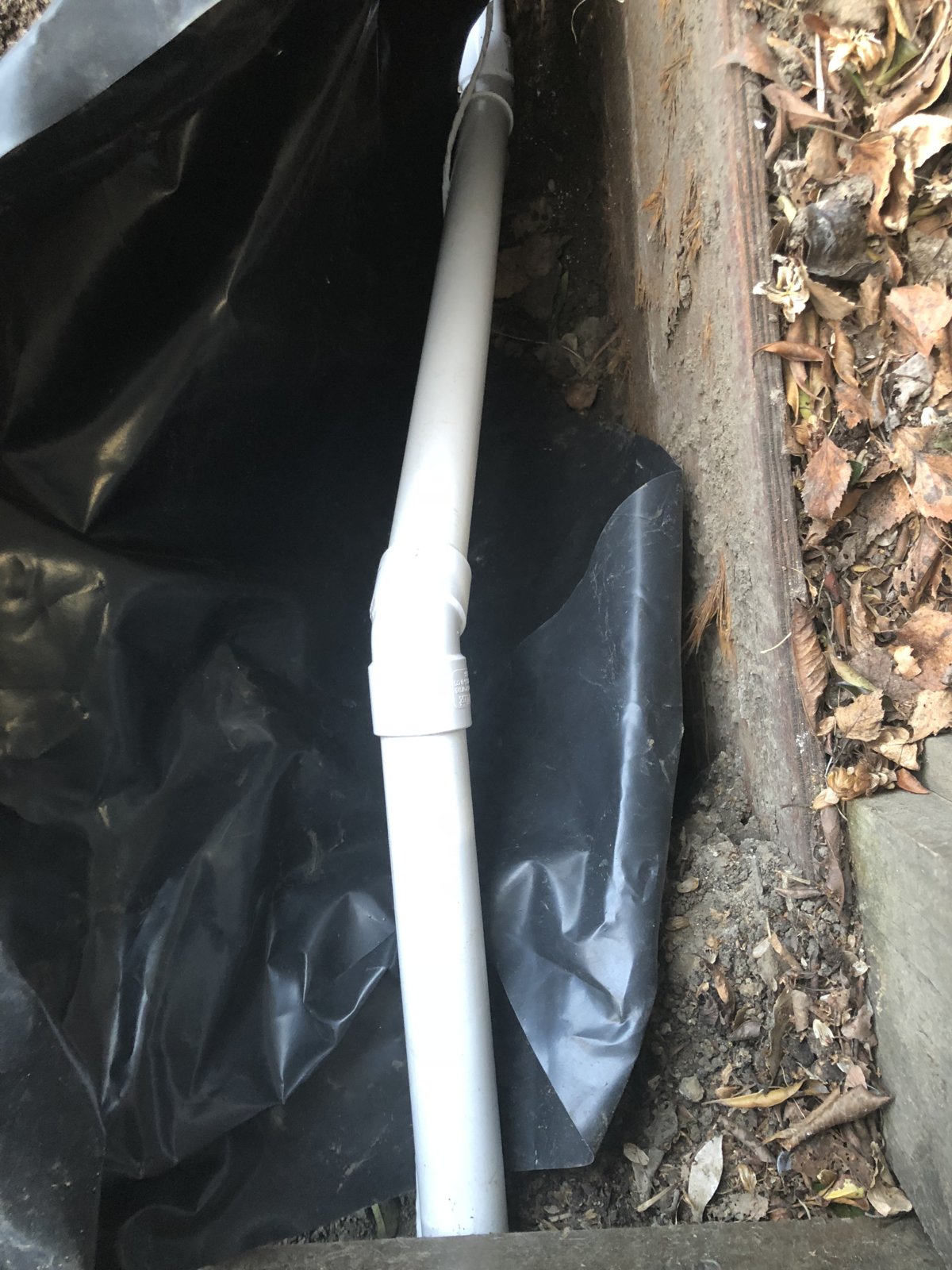

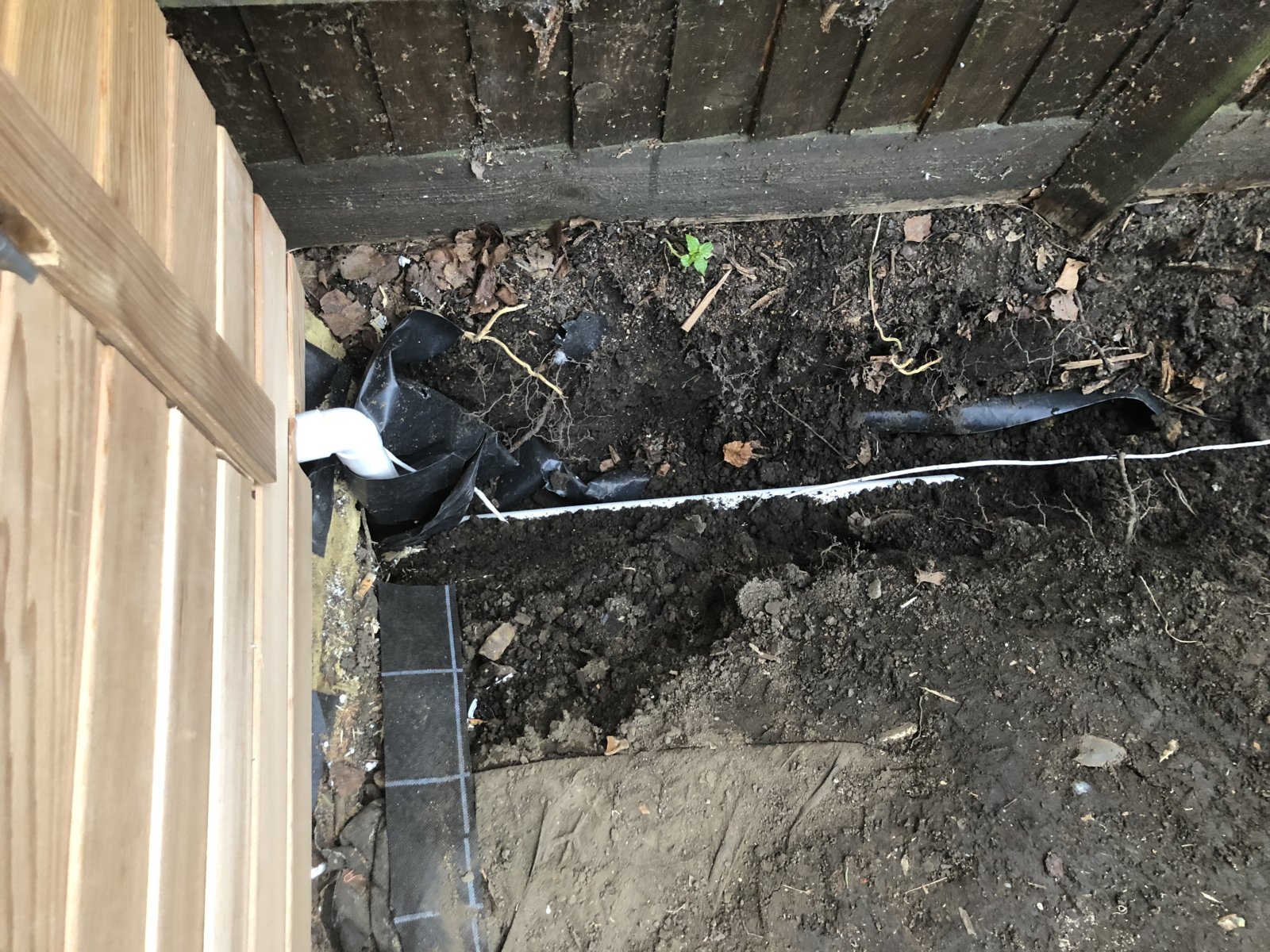

Can someone advise me on how I should proceed with this. I had a builder do a garden office for me and toilet for me. He put in a macerator for the toilet (insisted we need one). But he has left it unfinished and I don't think he is coming back and I will have to fix it or get someone else in. I think he made some mistakes and complained, but he wast having it. Please have a look at the photos.
So the 32mm waste pipe exits the macerator horizontally and then exists the building with a 90 bend. It flows along a 15meter trench to the decking where there is two 45 degree bends that rise the waste up above ground level where it goes under the decking before two more 45 degree bends cause it to drop again to connect with the main 110mm drainage pipe that leads to the manhole.
![Rise up to decking.jpg Rise up to decking.jpg](https://cdn.diynot.com/data/attachments/141/141086-622268354196daa61c41bc48e63b21f3.jpg)
I told him a 90 degree bends will cause trouble with macerators (according to installation instructions)
Secondly you cant have a second rise so far a way. Water doesn't flow up hill. He said it will be pumped.
Finally I have concerns about burying the 32mm under ground.
Hopefully someone can advise. As I need this connected and filled in next week before a family event.
