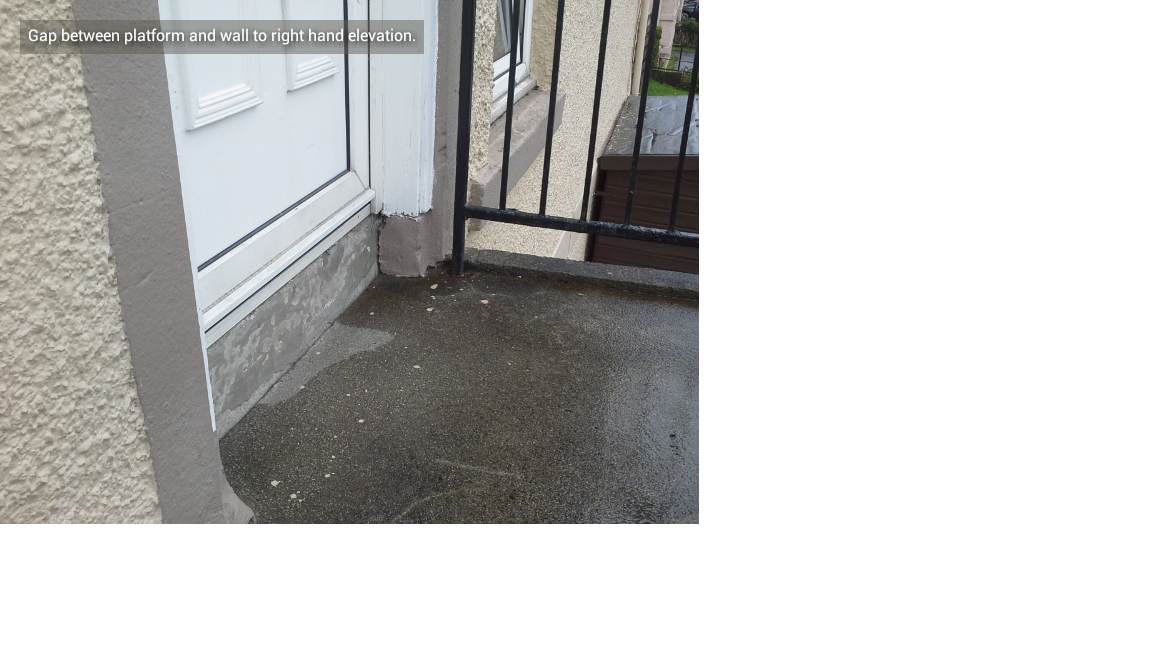

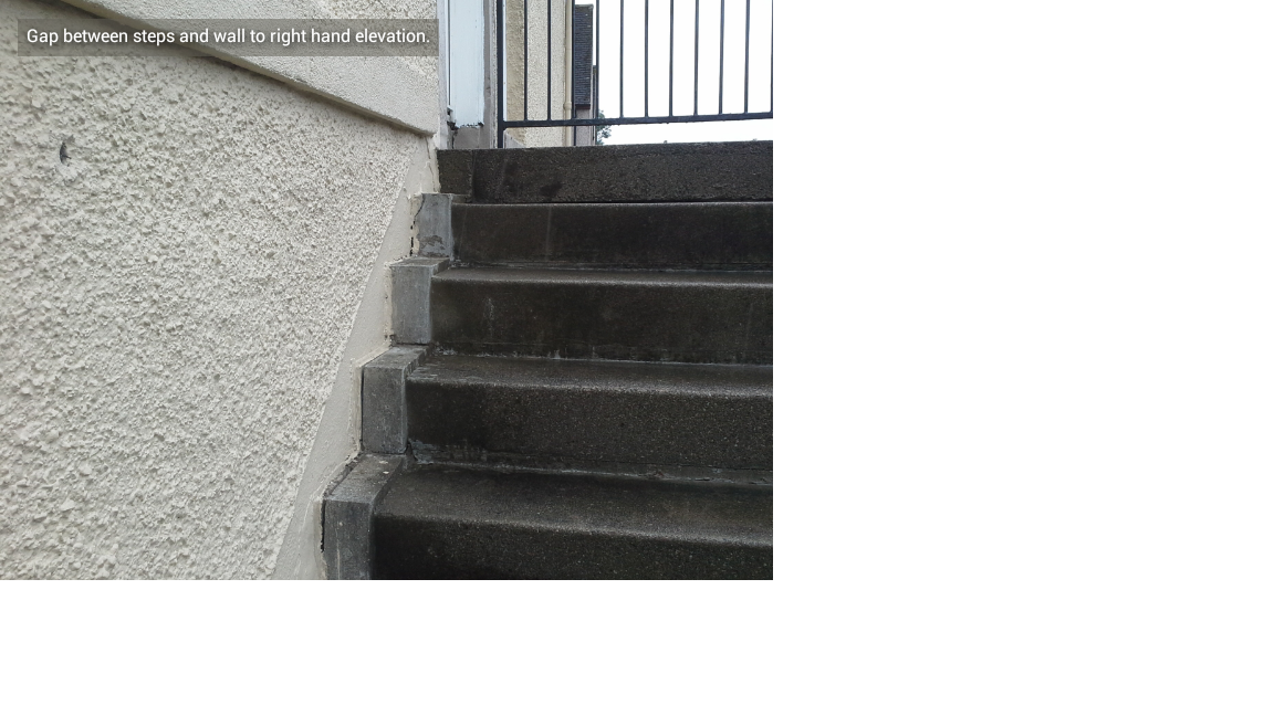

In our new flat, we have some damp on the Right Hand wall.
It is clearly the result of water ingress from a gap between the wall and the steps leading to the upper flat (see pictures).
My first thought is to clear out and fill these up with silicone as a stopgap before working on some sort of flashing solution.
Am I thinking right?

OK notwithstanding the above, the [almost] free standing blocks sited next to the Roughcast Rendered wall have loads of gaps, as does the gap between the top Platt and the step below, enough to admit rain water.
I take it the water ingress into your Property is that your property is under the platt entrance area to the first floor flat, and possible below the access stair?? as shown in your posted Image.
As an aside, some of the workmanship and cement finishing on the access stair is best described as "Poor"

Where is the damp in relation to the steps?

We are to the left of the stairs, on the ground floor.
The building is 70 years old, built originally by the national coal board, went through the local council and was bought from them.
