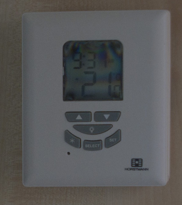

I'm replacing my thermostat with a digital one as the old one always overheats the house.
The old one has three wires:
The new Honeywell has a few options for wiring in the manual:
I connected live (brown) to A and 3 (grey) to B, leaving the other two wires unconnected. When doing this the heating runs constantly no matter what temperature is on the thermostat. Not sure if it's a bad unit or I've got the wiring wrong, any advice appreciated, thanks!
It would help to know what the other thermostat was and which wires went where. Do you have a photo?
That seems correct.
The black wire needs to be safely terminated in a block connector or similar and is not used with the battery powered thermostat.
I would temporary put grey in a terminal block to test the heating goes off.
Question is was the old thermostat faulty, or was there some other fault?

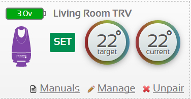

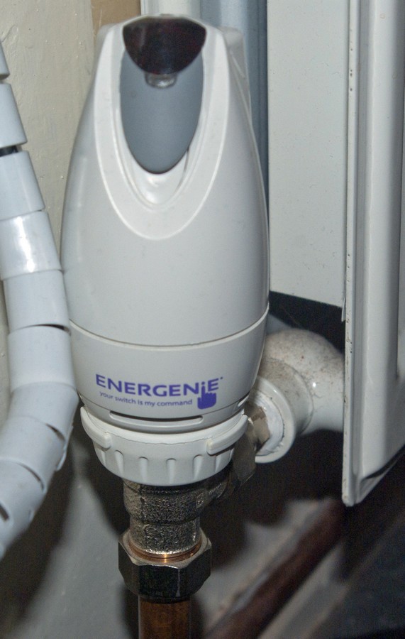

I had mothers house getting too hot, and first attempt was change wall thermostat, I used a cheap programmable wireless unit upload_2022-4-7_1-13-36.png it was a failure, and I was not inclined to make the same mistake twice, for fitted better heats on the TRV's, IMGP8035.jpg they did work well, with a modulating boiler, but new owners did not want them so changed back to standard, and now the lock shield valve had be set, which was easier when I had a computer report of target and current temperatures TRV_report.jpg .

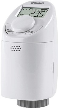

The problem is a radiator has two controls, the TRV and the lock shield valve, and mechanical TRV heads are marked *123456 not °C which is a bit useless, so without a differential thermometer to set the lock shield valve it is guess work which unit needs altering. With an electronic TRV head EQ-3 Bluetooth Smart Radiator Thermostat.jpg even a cheap one as shown here, I paid £15 each for these blue tooth heads, you can actually set the temperature in °C so if too hot you know the lock shield valve open too much.
The TRV takes time to open and close, around 3.5 minutes to do the exercise once a week Saturday at 12 noon to stop the valve sticking, and unless the lock shield valve is set in 3.5 minutes the radiator can get stinking hot, and this can initiate a hysteresis where the TRV closes and opens to try an control the temperature but keeps over shooting.
Thanks @CBW. Here's a few more pictures.
Old one :
has a programmer downstairs:

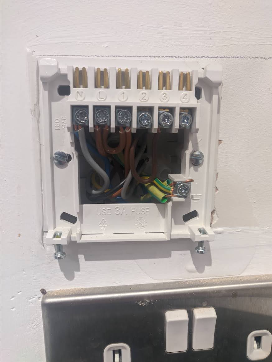

Strange thing is, now I've connected the old one back up as it was before, the programmer no longer has any effect on the boiler. If the thermostat is on, the heating comes, regardless of if the programmer is set to on/off. I did trip the circuit breaker at one point during the installation so I'm wondering if maybe something in the programmer has broken. Know of any way to test that?

To give you definitive advice, we would need to know what exactly is connected to the other end of each of the wires. How do you know that the black wire is N for example, and not the grey wire? There is no standard colour code, and the colours of the wires used for what function would have been down to the original installers personal choice, and the cable he had to hand. Sometimes, even green and yellow wires are used for live connections. It's not right, but it happens.
If you can't give us information about the other end of the wires, then the details of the old thermostat and what terminals that each of the wires were connected to will help us work it out for you, as per the request @CBW
Just one extra question, at any time during the installation has a fuse blown and had to be replaced?
EDIT
Just seen your previous post. Our posts were sent at the same time, so it wasn't there when I started mine. And now you will see why I asked the question abut the fuse. When you created the 'short circuit' and the breaker tripped, you have probably welded the switch together inside the programmer, so that the heating is permanently 'on' so, that will probably need replacing now.

The backplate on the Honeywell is slightly different.
Ah I see, the programmer must be broken then. I'll get a new one and then have another go. Thanks @stem
Then try,
Brown (live) to A
Grey (switched) to B
and terminate the rest.

Hi @ericmark @stem @CBW
You were right the programmer was the issue. Fitted the replacement unit this morning and everything is working again.
Just wanted to run this past you before I fitted the new thermostat. The backplate on the programmer has the Live and 1 (which I think goes off to the thermostat) bridged. Is that expected? Looking at the diagram I think it's optional and as the new stat uses batteries I'm not sure if it's required or not.
Terminals 1 and 3 are connected to a switch inside the programmer. So, when the programmer switches on the two terminals are electrically connected.
Therefore, the live is connected to terminal 1 and when the programmer switches on, terminal 3 becomes live as well.
If there wasn't a connection on terminal 1 then terminal 3 would never become live and switch the heating on.
Did you notice this?
I find that if a 3A fuse is fitted, it usually prevents the switch welding together in the event of a short circuit, but not so if a 13A fuse is fitted.
Only a live and switched live are connected to the battery operated thermostat, terminals A & B
Insulate / isolate the neutral safely out of the way.
