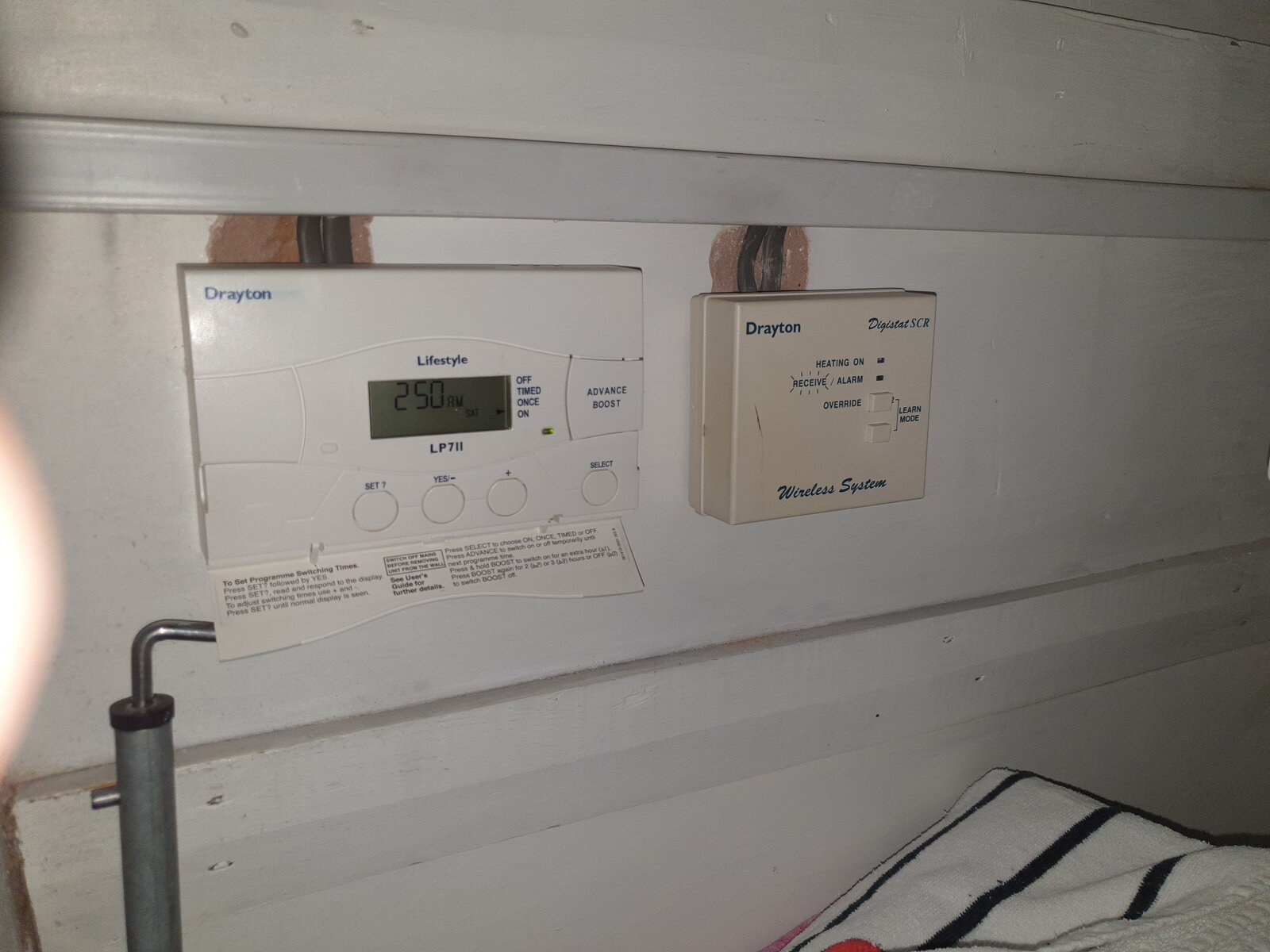

Hi Guys
Trying to install my first thermostat. I know enough about electrics to not kill myself...thats about it.
Gone to install the Nest heat link and realised I have 2 'hubs' connected to my combi boiler. Both Drayton. One the controls and one is a Digistat SCR.
I'm thinking I replace the controls but what do I do with the Digistat (right on the picture)?
Much love and appreciation in advance
Can take further pics with covers off to see wiring of needed.
Cheers,
Daz
The LP711 is a timer, nothing to do with any 'hub'.
The SCR is a radio frequency (RF) receiver from a remote room thermostat.
My best guess is that mains is presently switched by the LP711 to the Digistat SCR when the timing schedule calls for heat. The SCR takes that signal and further switches it to the boiler when the room thermostat calls for heat.
Thus you may remove both of these devices once you have identified the mains power L, N, and E, and the switched live (SL) going to the boiler. The Nest Heatlink will replace both, and it will switch live (SL) to the boiler when both the Nest schedule calls for heat and the Nest senses the room temperature is lower than that desired.

Forget the long winded rubbish, your job couldnt be easier, the nest simply replaces the Drayton Scr , and the LP711 is removed show pics of the wiring in each, you may or may not have to make a link when you remove the LP711
