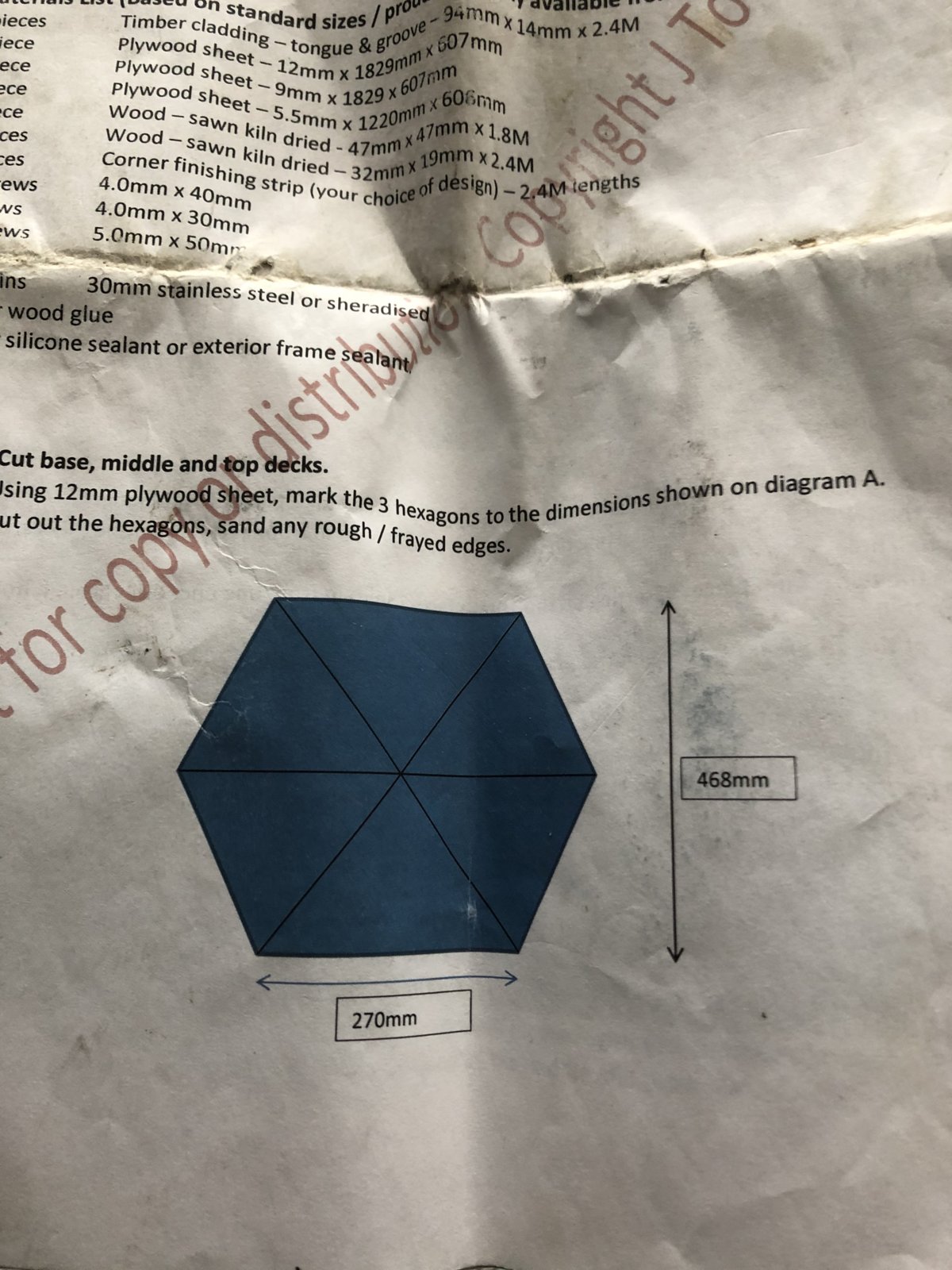

Not too good at woodwork but in these lockdown days I’m embarking on making a Dove Cote.
I need to make a Hexagon but unsure how I should measure it out on a piece of 12mm ply ready for cutting. Any help appreciated .
thank you

Ok, Mark a central point on the sheet, draw a vertical line, use the protractor to measure 60 degrees, draw a line 60 away from original vertical line, repeat process. Then mark equal distances on the lines, finally join the dots up. Voila a perfect hexagon.
Probably the easiest approach is to use your printout, as long as it is the right measurement.
Then use an awl (or a pin) at each point, directly onto the wood.
Done.
...and you might want to use a compass to draw a circle from the centre to intersect with the radial lines
Using the radius of a circle to mark out six segments is not recommended - because you get accumulated errors at each offset.
If you want to use a compass,
(1) draw out an equilateral triangle 3 times the length of one side of your hexagon.
(2) Trisect each of the 3 lines of your triangle. You can do this with a ruler, or with a compass. The 6 inner trisection points of the 3 lines are your hexagon.
The way I remember is draw a circle using dividers/compass
Then place the (same radius) compass point on the perimeter, and draw an arc across the perimeter.
Move to that intersection and repeat.
Join every intersection with a straight line.
Check that opposite sides are parallel
Am I over simplifying or got it wrong but can't one just draw a 468x270 rectangle which is pretty simple then set compass to 270, strike an arc off the 4 corners to mud point of longest sides and join it all up.
