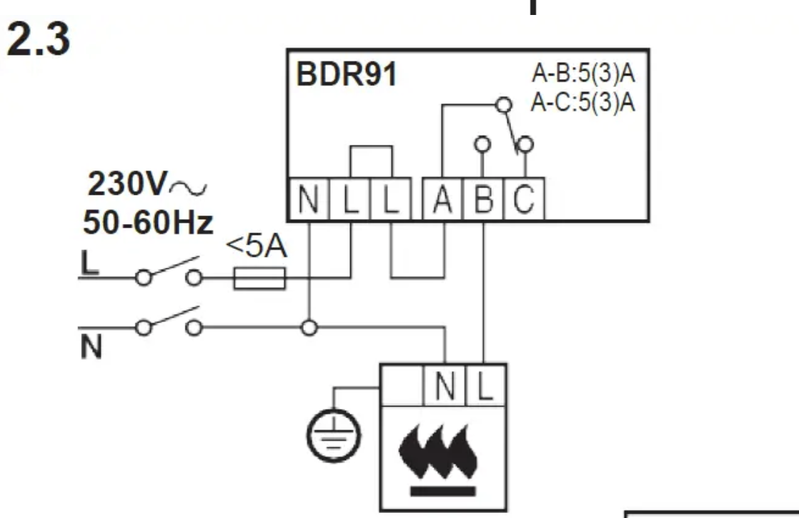

I'd like to install a Drayton Wiser 3 kit for the house.
Current set up is 2 central heating zones (upstairs/downstairs) and hot water, with a conventional boiler and unvented indirect cylinder.
We have a Horstmann H37XL programmer, 2 x Honeywell DT92E wireless thermostats (upstairs/downstairs) and 2 x BDR91 (upstairs/downstairs). I can see there are mechanical valves on each pipe circuit but I don't know exactly what is controlling them...
Initially I thought we just needed to replace the H37XL programmer with the Wiser HubR, but then I was unsure what we should do about the existing wireless thermostats. I'm guessing they communicate with the BDRs? And do the BDRs in turn communicate with the boiler and/or the mechanical valves?
If so, by just replacing the H37XL programmer, won't the existing thermostats still be in the loop?
Any advice appreciated here.
Many thanks!
Ok, so there's a couple of ways you can do this. You can replace the H37XL with the Wiser Kit 3, and it's the BDR's that are wired to the motorised valves which in turn bring the relevant/requested demand. So the switching wires would need to be joined at either the bdr or wiring center.
Hi Chris, thanks for your response. I can see this wiring diagram for the BDR91:
so when you say the switching wires need to be joined, do you mean to link terminals B and C together on both BDRs?

No, usually A and B, if yours is the same then you'd need to keep the permanent live there too, so could be more beneficial to do at the wiring center
Thanks Chris. Just to check understanding then - are these BDRs connected to the mechanical valves I can see, or to the boiler?
The motorised valves (mechanical as you're calling them)

So:
1) put the HubR in place of the H37XL programmer (with the rewiring of the baseplate required).
2) link the terminals in both BDRs (I think I'd feel more confident doing that then opening up the wiring centre) and then the motorised valves will be permanently open.
With this set up though, won't I lose the separate heating zones, as when the boiler is on it will send hot water to both heating circuits?

No, to bold text above, you've misunderstood, basically linking the 2 wires complete the circuit, so they will work with your wiser control.
No, zones will be kept, as the hub will be the one requesting whether or not to come on, then the wiser thermostats will send signal to hub too

@chris - I think I understand now, thanks. I think what I'd misunderstood is that the motorised valve is not just opening/closing, but also sending the demand signal to the boiler (I'd assumed this was done by the programmer...)
What I now understand is: By linking the terminals in the BDR/wiring centre the old wireless thermostat is effectively bypassed, and the zone ON signal from the Wiser Hub will now pass through the BDR to the motorised valve, which will then open and also send a demand signal to the boiler. Is that right?

Hi all, just wanted to say I got this all wired up with your help and seems to be working exactly as desired. Thanks again for all your help!
