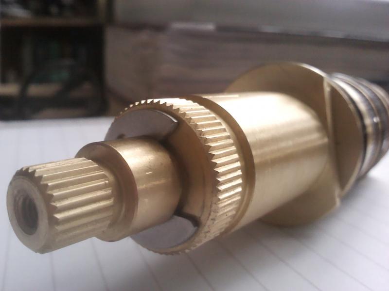

Hey,
My thermostatic cartridge has malfunctioned and I am trying to replace it. I have a replacement to hand but am having difficulty removing the old one.
I have attached pictures to show the long spindle/shaft along with the 'bit' that grips onto some tool allowing me to twist it off.
The plumber that installed it has moved away so unable to help me.
But I recall some kind of long hollow cylindrical tube with a wrench on the end or something.
I have called a plumber over who was unable to help, been to 4 plumbers merchants and halfords (incase of a tool available off the shelf that may help) but had no joy.
I'm posting here hoping someone may know the name of the tool I require. I can then find the correct size etc.

Hey John,
Yes, unfortunately it is very deeply recessed!
Not a chance to get anything remotely close to it.
Its gonna be some kind of long, hollow, cylindrical tube with appropriate 'gripping points' on the end.
Amjag
Yep, that sure could be an awkward one.....certainly I know of no tool that is purpose made for this.
So - if it was mine......I'd measure the distance across the brass flats, and then find a box (tube) spanner that had the same internal dimensions - or close to them anyway.
Then I'd cut away 4 of the hexagonal flats so only 2 opposite flats remained - if you get my drift.
The modified box spanner would pass over the stem of the cartridge and locate on the hexagonal flats. Hopefully turning the spanner would undo the cartridge, but if the 'jaws' tended to spread I'd reinforce things by using a jubilee clip to prevent this.
A typical box spanner is Toolstation 43996 if you don't know what I mean, but I don't know if this particular one is the right size.
John :)
Thanks for those suggestions John + Andytw.
Am going to head on over to toolstation and see if I can find a box spanner that fits, or a close fit which I can cut/modify.
I will also get a small section of pipe that fits and see if I can get a metalworks to 'make' a two pronged tool.
Im going to spray a little wd40 on the old one to see if it may help things become unstuck!
I appreciate the help :-)
Amjag

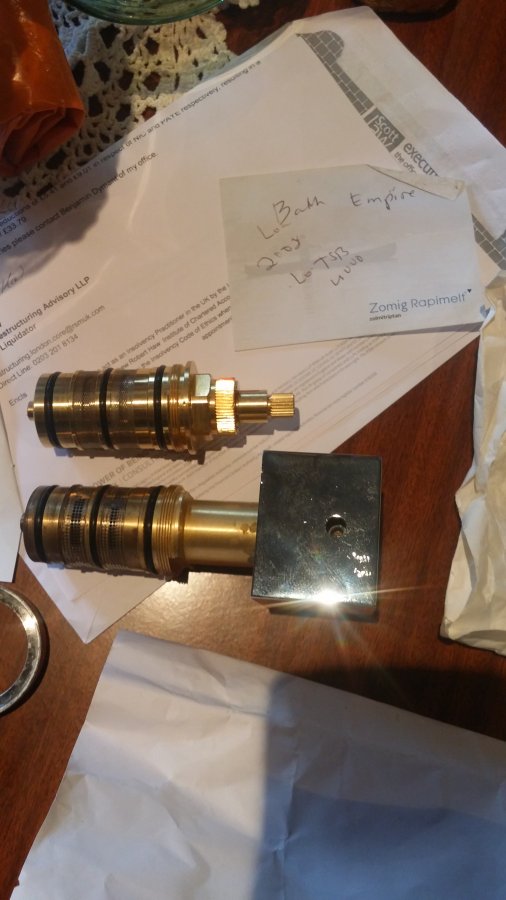

I think I need this cartridge...
Replacement part sent from supplier is too short..
This looks like the one...
Waiting for the supplier to get back to me...
Will try shower doctor also...
and if all fails...
Anyone have one of these they do't want.
Or maybe some kind of stem extender ?
