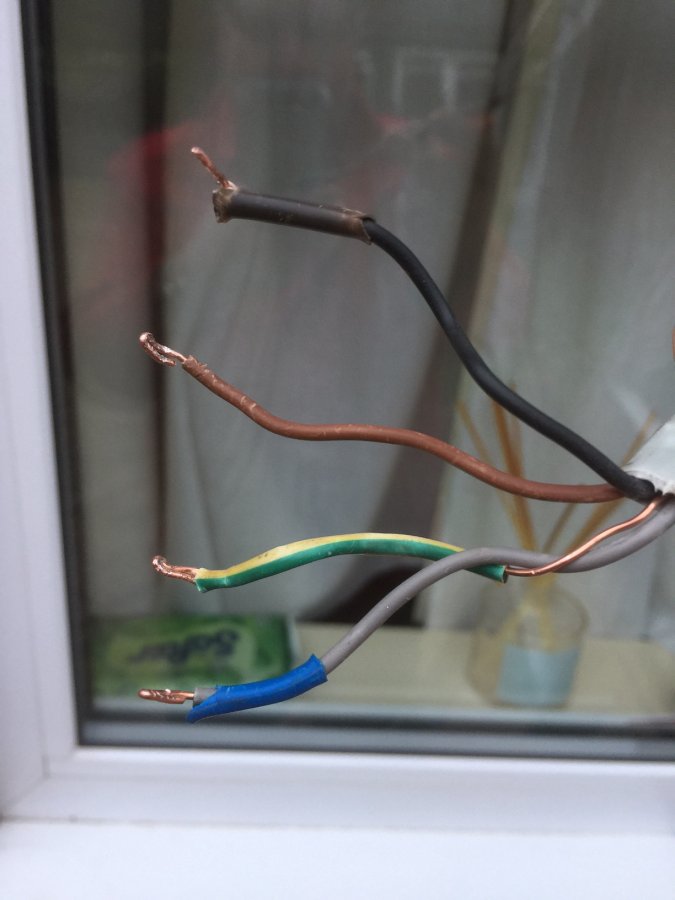

hi
my mate need to change an outside light
i have a picture of the new light wiring connections
the wire for it has 2 black wires and 1 red wire
just need to know where to put them ;)
thanks
For the light, the terminals from left to right as in the picture are L, N, E and switched L.
If it's a single light and not controlling or connected to any others, only L N and E are required.
As for the wiring you have with 2 black and one red - it's anyone's guess what they are, and where is the necessary earth connection?

cheers, there is no earth on the old wiring, and i think the 2 blacks might me possibly because the old light was switchable from 2 different switches,
i'll check with my mate

Are the two blacks and one red all contained in the same cable sheath?
Could it be that one of the "blacks" is the earth wire sleeved with a length of insulation removed from a black conductor?
I have seen this before.
If this is the case, you would need to test the conductors to be sure of their function before connecting to the new fitting.

hi
having been and checked, the original wire is nothing like my mate described
it has 4 wires
green and yellow
brown
black with a short sleeve (black/brown hard to tell)
grey with a short blue sleeve
