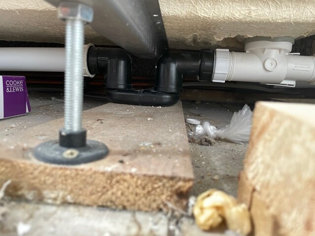

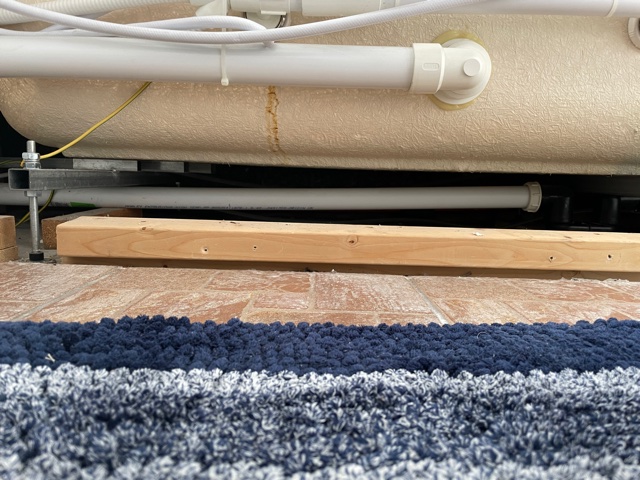

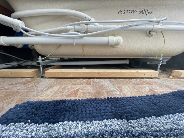

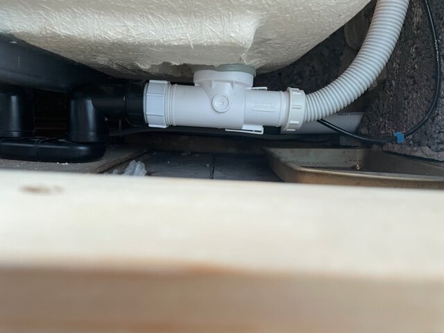

The bath has a remote drain (which now works), but when using the shower, the water steadily starts to back up in the bath. after a 10-15 minutes shower, the water is above your feet and takes around 5-10 minutes to drain down after turning the shower off.
I've flushed through the pipes and they seem clear - even put drain unblocker down it, but to no avail. The pipe is 40mm waste and runs the length of the bath (waster and shower is on the opposite wall to the basin and soil pipe) before a 90 degree turn and then carries on another 1.5 metres to the inside soil pipe, in this run the basin waste also connects (this runs without any issues).
The pipe under the bath has got a slight angle on towards the outside wall, but has a shallow running trap as the bath plug waste has an integrated horizontal exit with the bath overflow on the other side of it (hope that makes sense!) I was looking at fitting a waterless trap but see they aren't recommended for baths due to needing to be cleaned out. I was looking at cutting a hole in the floor under the bath to allow room for a shallow trap - but obviously the design of the remote control waste is skuppering a lot of these options.
Can anyone suggest the best option here? do i need an AAV on the bath waste, as I'm aware it's quite a long run? I don't really want to replace the whole bath waste as it works and is quite an expensive part of the fittings (the open-close knob itself is metal, not plastic!) plus i'm not sure if that will be the fix as I don't know if it has ever drained properly!
Any help would be appreciated - was contemplating replacing the bath waste pipe with larger diameter and a high flow trap, but the location of it all and said odd drain exit is causing me issues!
