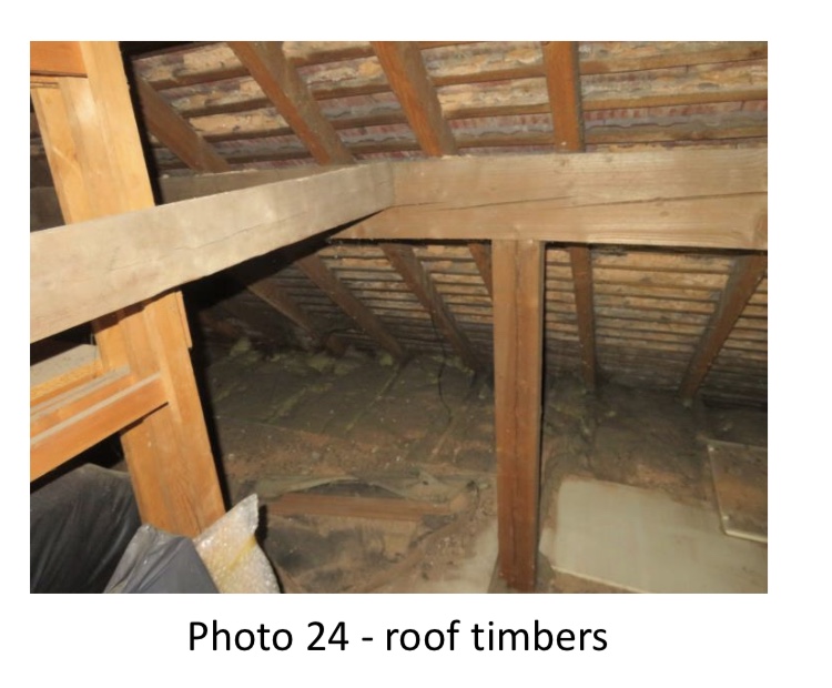

Hi everyone,
I’m a FTB after some advice :)
I’ve recently have had my survey done which has come back stating it needs a new roof within 2-3 years.

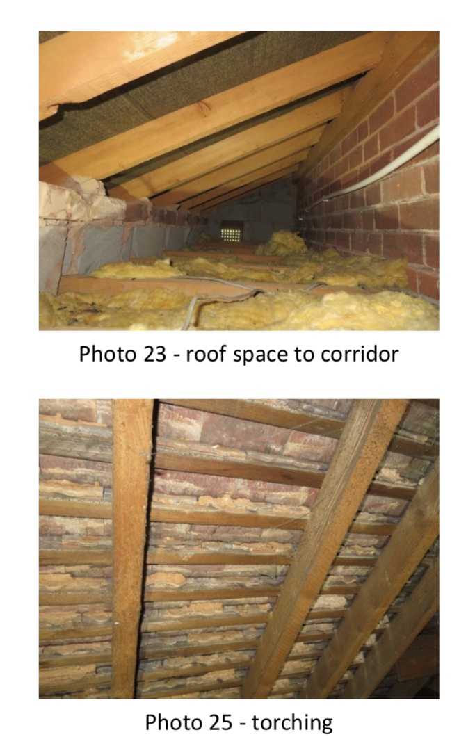

It’s a detached house from the 1930’s so has no underfelt. The surveyor noted some daylight coming through in a few places but no sign of water ingress, damp or rot. He did say the torching Has deteriorated.
My question is: do I go back to the EA to renegotiate a lower price (surveyor is saying it’ll cost 20k for a new roof, I’m thinking more so 10-12k) taking in to consideration a new roof? Or will this roof last me much longer than 2-3 years.
I understand what I’m asking is probably something that’s very hard to answer as every roof is different but thought I’d ask anyway :)
Any help will be appreciated.
Thank you,

1955 and all of our torching failed long ago. It was put on to keep tiles in place, where the tiles had no nibs. Mine have nibs, so no problem. See if yours have nibs. Damaged tiles can be replaced cheaply and easily.

Some daylight might be leaking up between the tiles, they don't fit perfectly. It looks as if (like me) you probably have three thicknesses of tile, over every bit of roof.
Very easy from the inside. If the tiles hook onto the wood, then they have nibs. I cannot be sure because photo is not clear enough, but photo 25 looks as if the tiles do have nibs and they are similar/same as my own tiles and quite easy to source.
23 looks as if it is much later blockwork and does have underfelt below the tiles..

My roof is 65 years old. It could do with a few deteriorating tiles replacing, but there is absolutely no urgency. To offer an opinion on your roof, we would need some good quality photos of the outside, but even so, I doubt it will need more than a few tiles replacing.

Based on the report the surveyor did say apart from the torching the tiles are in good condition
The inside pics look pretty clean.
I believe the lifespan of clay tiles is reckoned to be 60 -80 years, so the surveyor has just stating what might expected on paper -ie theory.
In reality the roof could last 3 more years or another 20.
I guess the lifespan is determined by how exposed the location is, how well the roof has been maintained and how complex it is.
External pics would be useful -there are some roofing pros on here that might comment.

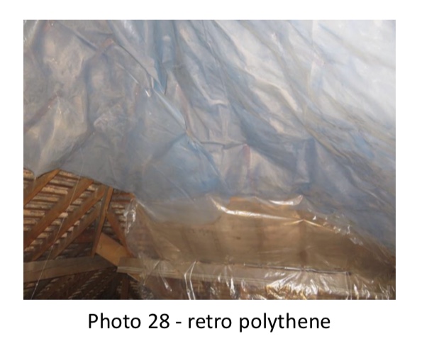

Also, in another image you can see the vendor has put up some sheets. Not sure if this shows a potential leak in the past??
The polythene might have been to stop the torching falling on things stored in the loft. It was a terrible problem in my loft, every time the wind blew, more would come down - horribly, messy stuff.
Ahh that makes sense!! Thank you!
