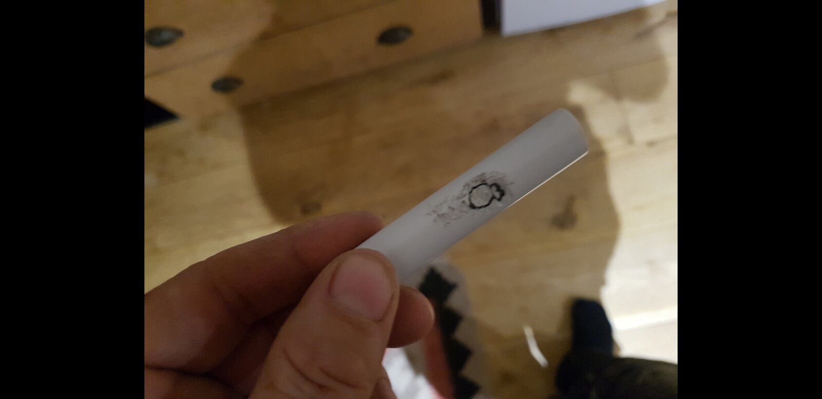

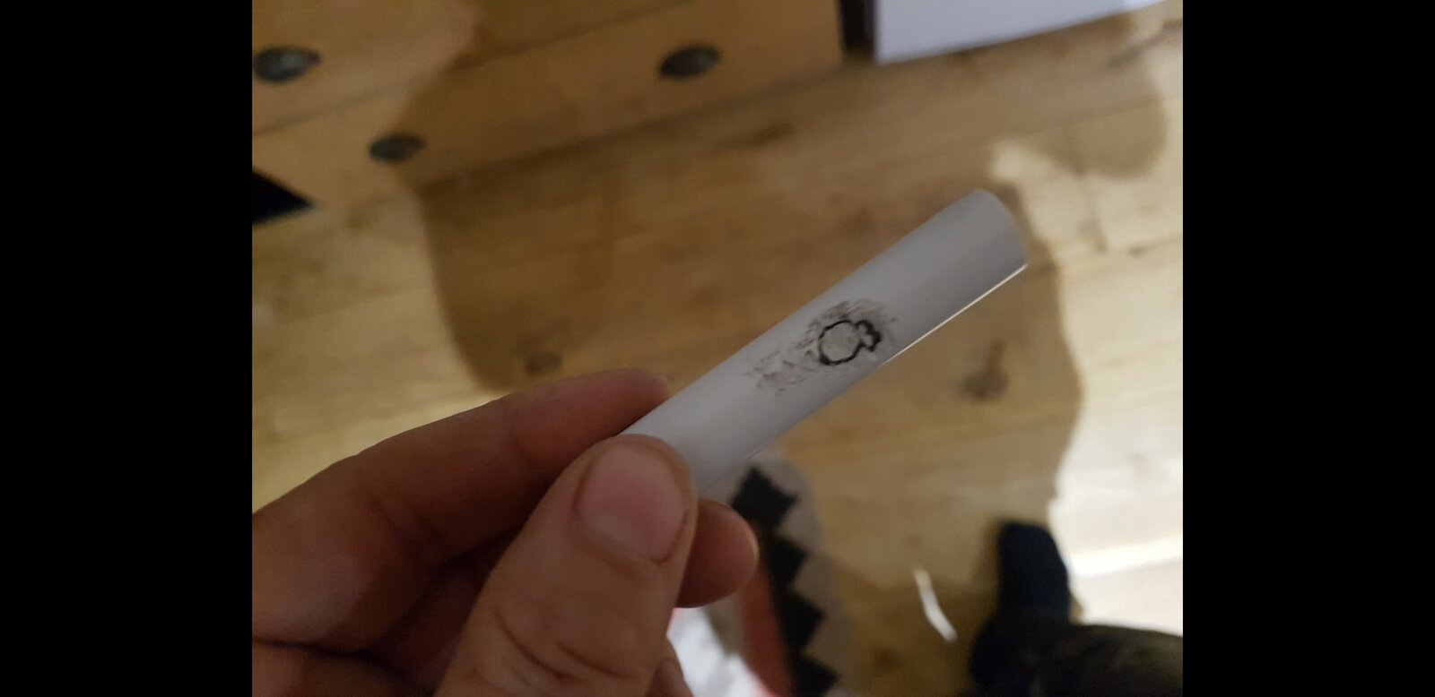

I have. As an apprentice we installed a bathroom for a customer. Two weeks later the kitchen ceiling came crashing down along with a lot of water. Something (presumably mice) had chewed through a plastic elbow underneath a basin.
More recently, a couple of years ago I was called out to a property no less than 7 times in an approx 2 month period to repair leaks all around the house. Each time I found that something had chewed through the plastic pipes, both in the ceiling and in the walls, which had been studded off and boarded. They'd recently renovated and it made a huge mess.
I have. As an apprentice we installed a bathroom for a customer. Two weeks later the kitchen ceiling came crashing down along with a lot of water. Something (presumably mice) had chewed through an elbow underneath a basin.
More recently, a couple of years ago I was called out to a property no less than 7 times in an approx 2 month period to repair leaks all around the house. Each time I found that something had chewed through the pipes, both in the ceiling and in the walls, which had been studded off and boarded. They'd recently renovated and it made a huge mess.
Will chew copper or plastic..OP, take your pick
